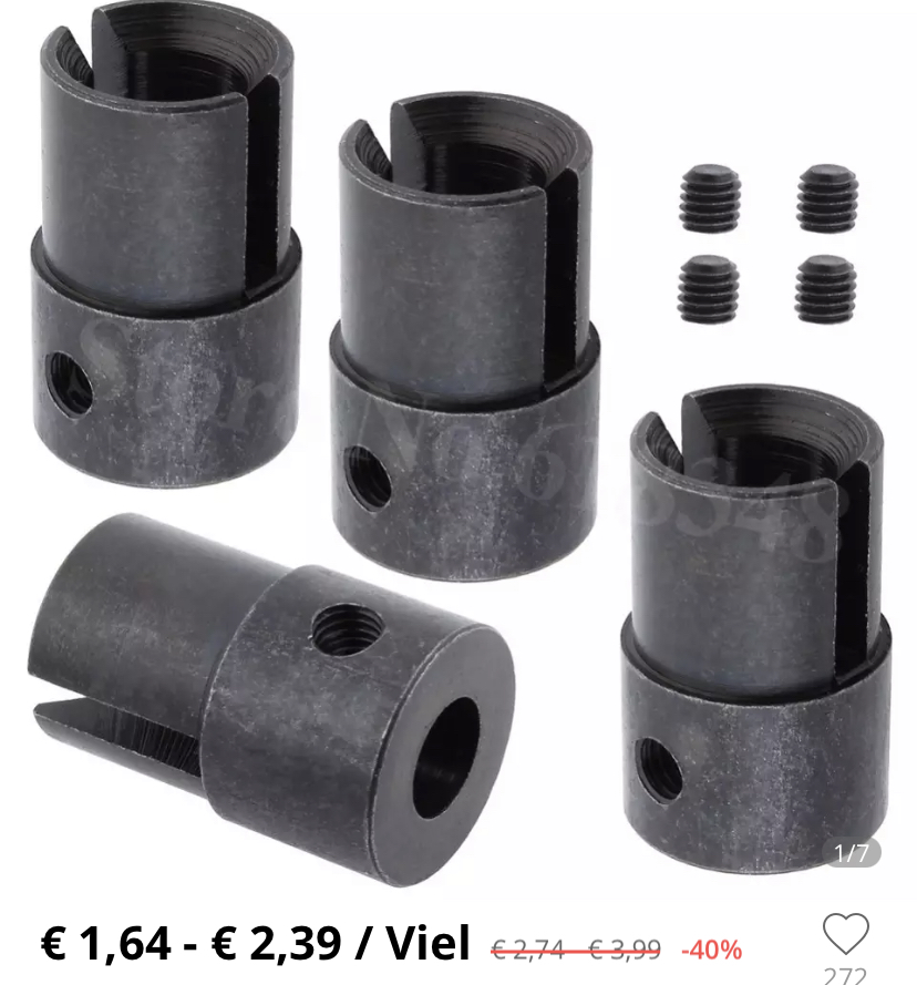

So that leads to the next question:
Are there dogbane “cups” out there that are a direct fit to 4mm shafts? I will most likely need to sleeve the shafts from 4 to 5 mm.
Traxxas 1/16 Diff
Traxxas 1/16 Diff
Traxxas 1/16 Diff
Outdrive cups
Outdrive cups
