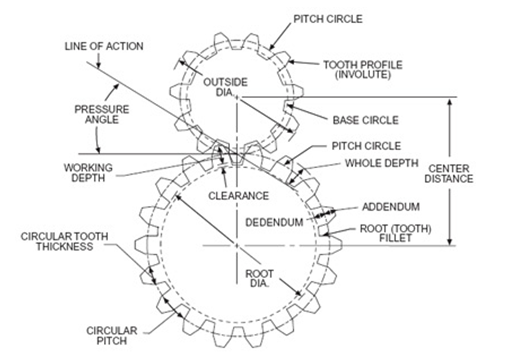

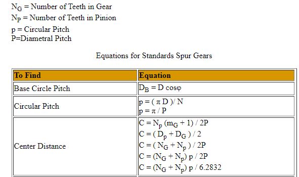

Maybe you could have a look at this site:
https://www.engineersedge.com/gear_formula.htm
You can calculate the center distance if you know the number of teeth and the diametral pitch.
As an example, using the equation C=(Ng+Np)/2P, the center distance for a 48DP 20t pinion and its 26t gear would be 0.479".
(26+20)/96 = 0.479"
