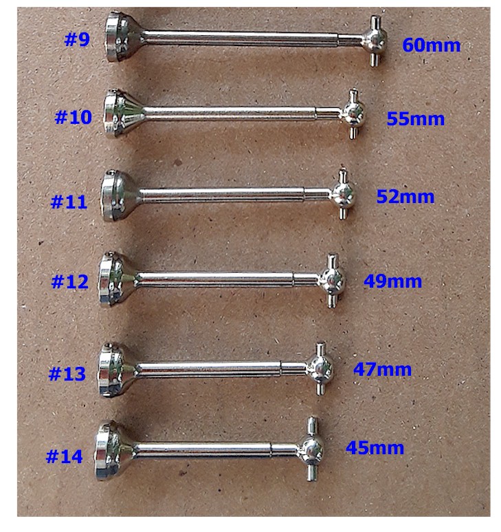

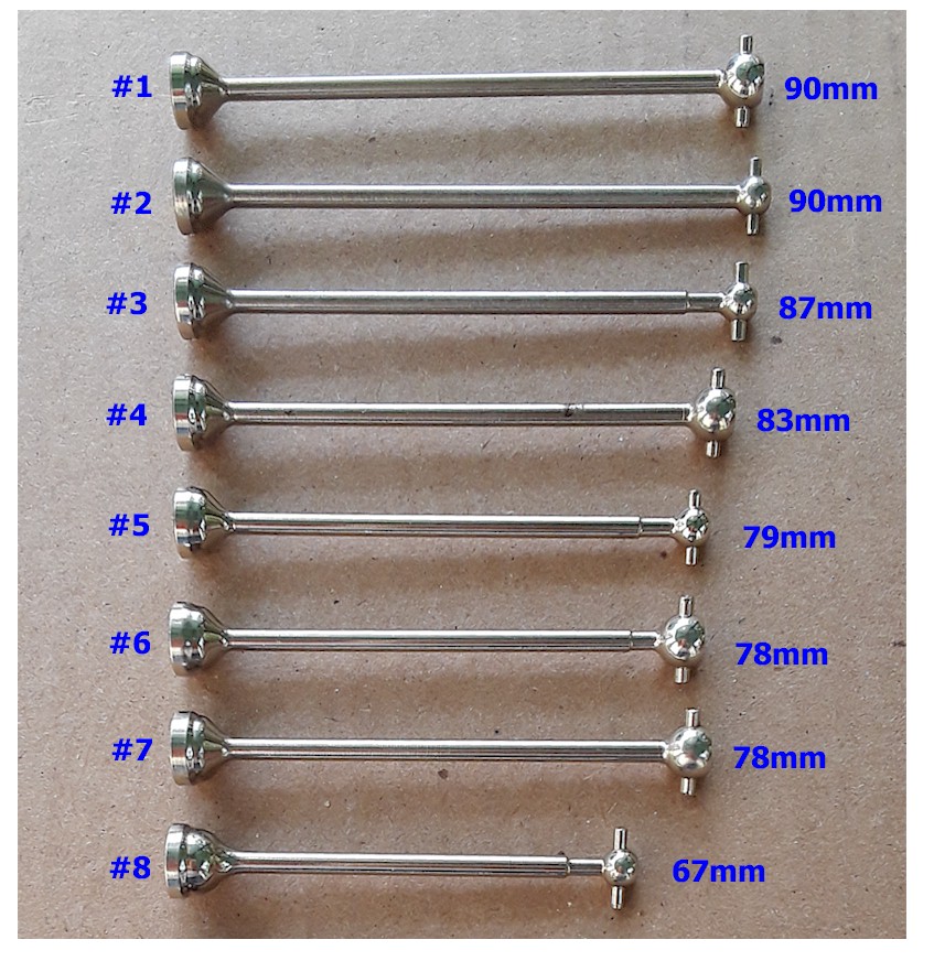

My hope is this thread becomes an ongoing resource of information to help further the knowledge / resources for the older MIP bones (shiny and dark) 1/10 and 1/8 scales
and so forth. There is limited information on the web especially when it comes to measurements of these and which cars they are for.
With all the user knowledge on this forum, let's create a great source of on-going information for the MIP stuff!
I will get it started with these x 2 images.
-please add any suggestion / replies with " #12, works on the Losi GTX" for example....
Old MIP Bone Axle ID Thread Let's get it started!!

#3 - 87mm - 10T/T2/T3/GT
#9 - 60mm - RC10 Buggy - RC10 definitely and probably B2 and B3, checking my notes now, hopefully someone will
confirm.
