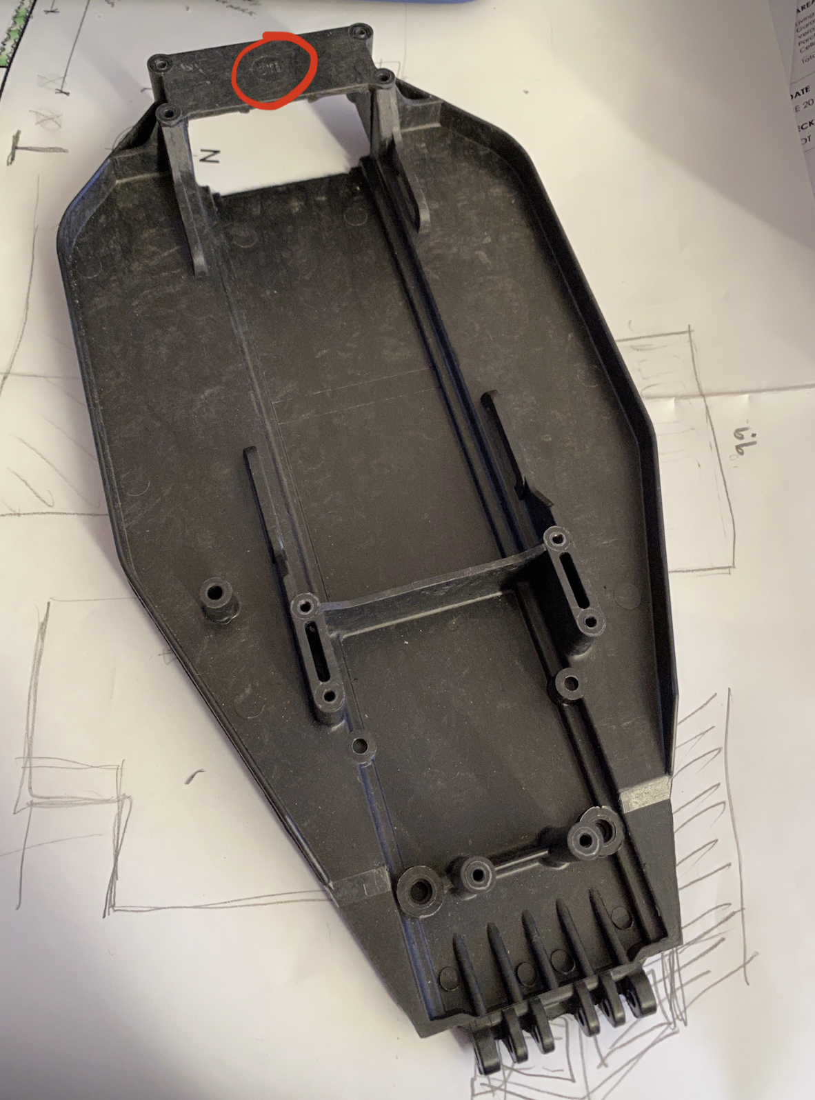

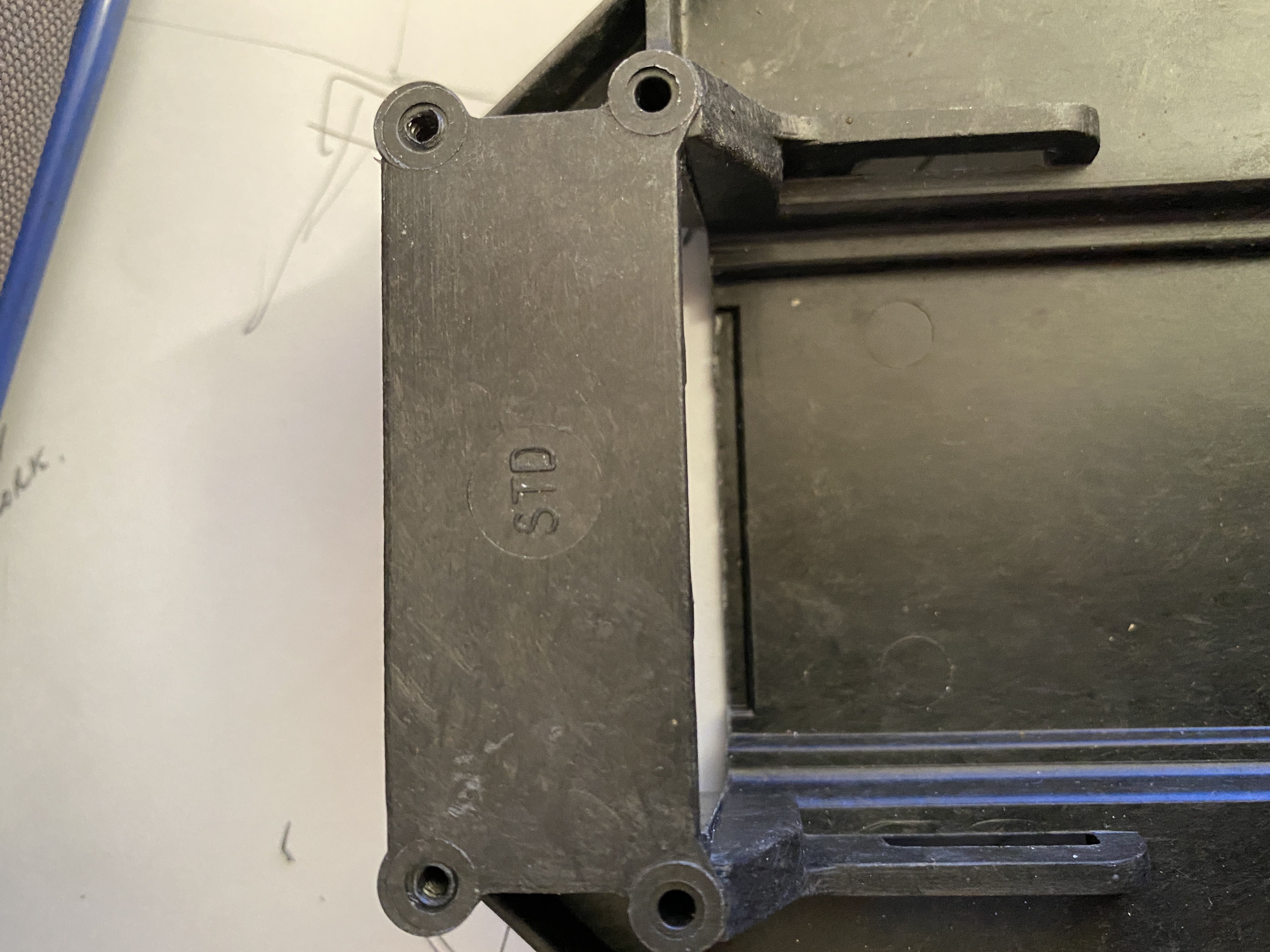

And for the rest of my post.
The A9902 was the kit chassis for the XX-CRBK
here is mine. It says “STD” not just “S”
