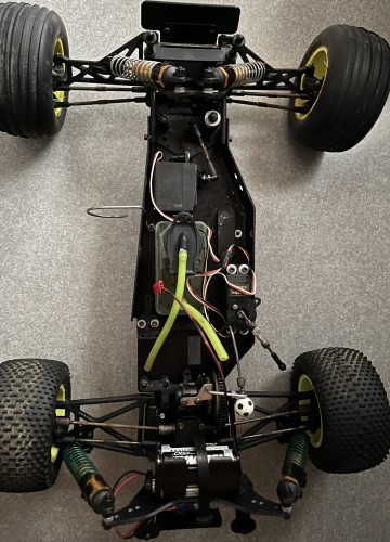

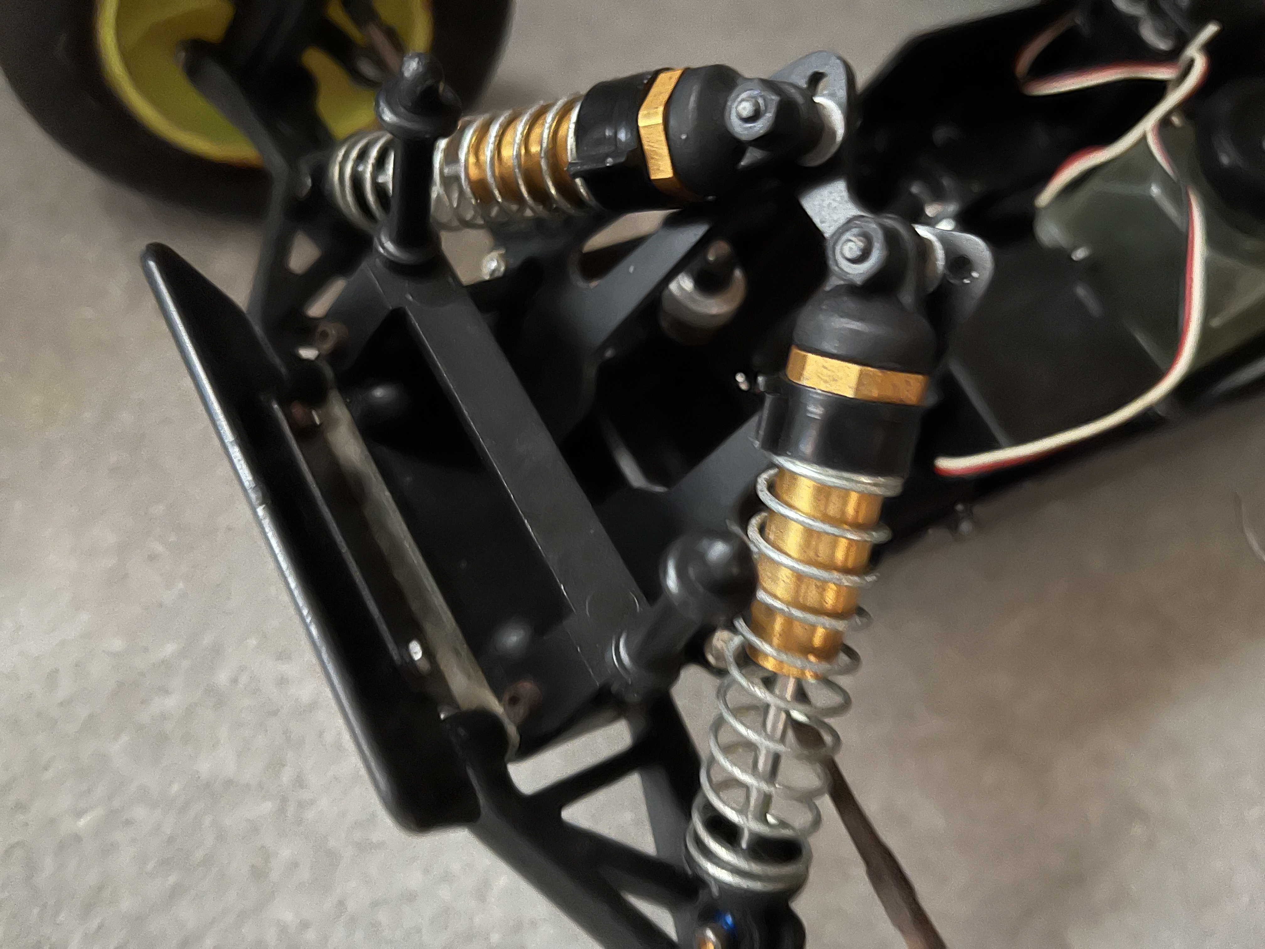

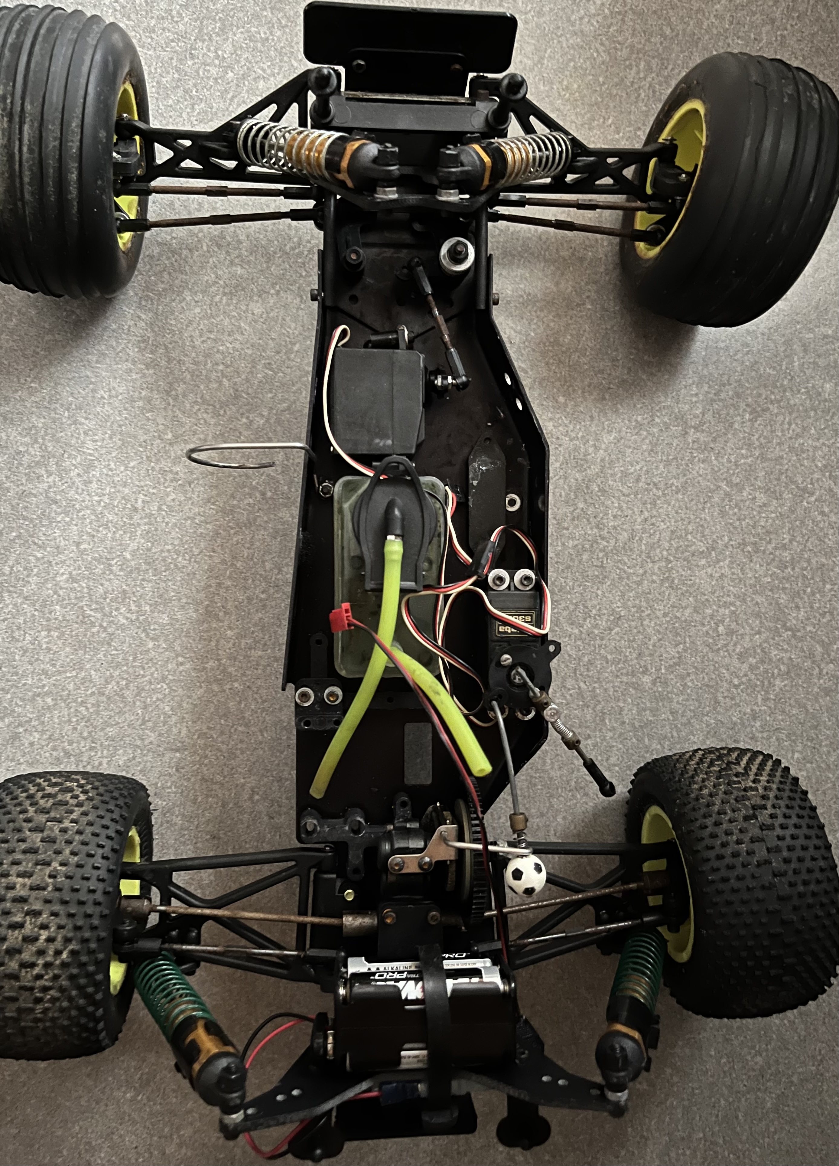

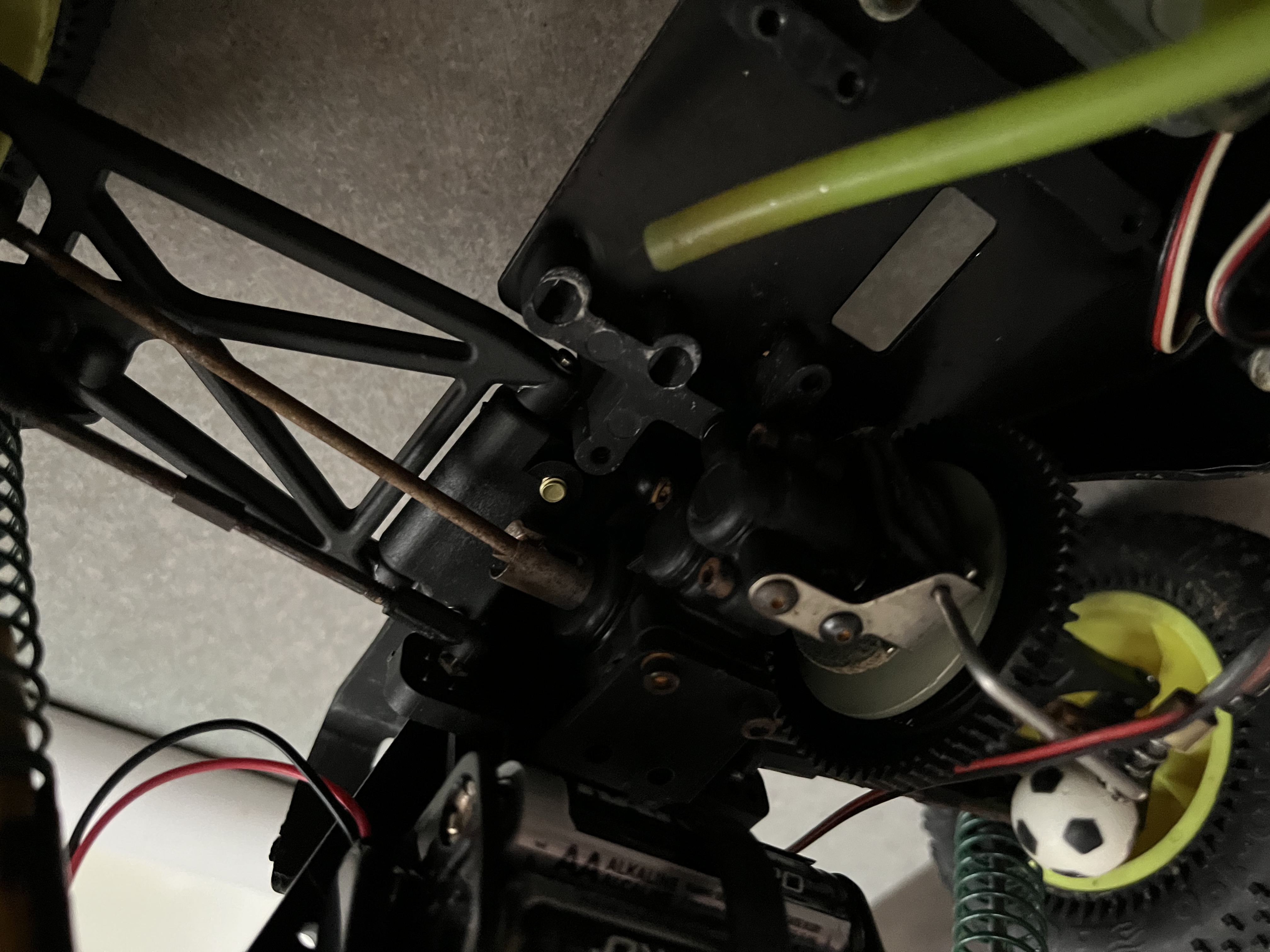

Hi guys and gals, picked this up to help with a build was wondering which gt this is.

Black tub "sport kit" GT. Bottom of the line for the time. Looks to be in decent shape. That battery placement is...unique.

Would this share some parts with the rc10t? I’m putting together a buggy with wide arms and a T front end
Posts: 3535
Has thanked: 268 times
Been thanked: 2094 times
Re: Help ID this GT
With the exception of the better servo saver (on the GT) the front is identical to a 10T.
The rear arms, carriers, and bones interchange as well.
