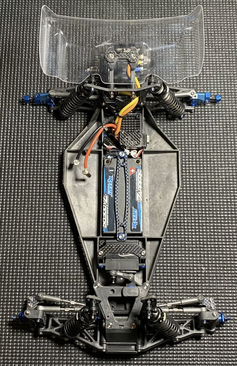

Carbon composite chassis and top plate
Kinwald blue flake carbon front tower
Carbon rear tower
Lunsford titanium links
Titanium screws
Team Trinity B4 rear hubs
MIP CVDs
B4 top shaft with octalock spur

Next step is adding B6 big bore shocks and redoing the electronics

Great build. Tons of great additions and modern mods that all look right at home.

Great car. Do you know what size MIP CVD's? Are they B4 or a mash-up of parts? Also, is that B6 hubs and knuckles up front? I'm hoping to make similar updates to mine. Thanks

JPaul wrote: Fri Jun 03, 2022 5:40 pm Also, is that B6 hubs and knuckles up front?
Looks like the Custom Works hex conversion kit.

JPaul wrote: Fri Jun 03, 2022 5:40 pm Great car. Do you know what size MIP CVD's? Are they B4 or a mash-up of parts? Also, is that B6 hubs and knuckles up front? I'm hoping to make similar updates to mine. Thanks
I don’t honestly remember what the CVDs are. I think they are just the B2/B3 ones. Yes it has B6 Steering. I’m in the process of doing it to my T2 also.

juicedcoupe wrote: Fri Jun 03, 2022 8:52 pm
It is B6 not custom works

Car looks great! What is that carbon fiber battery strap from?
