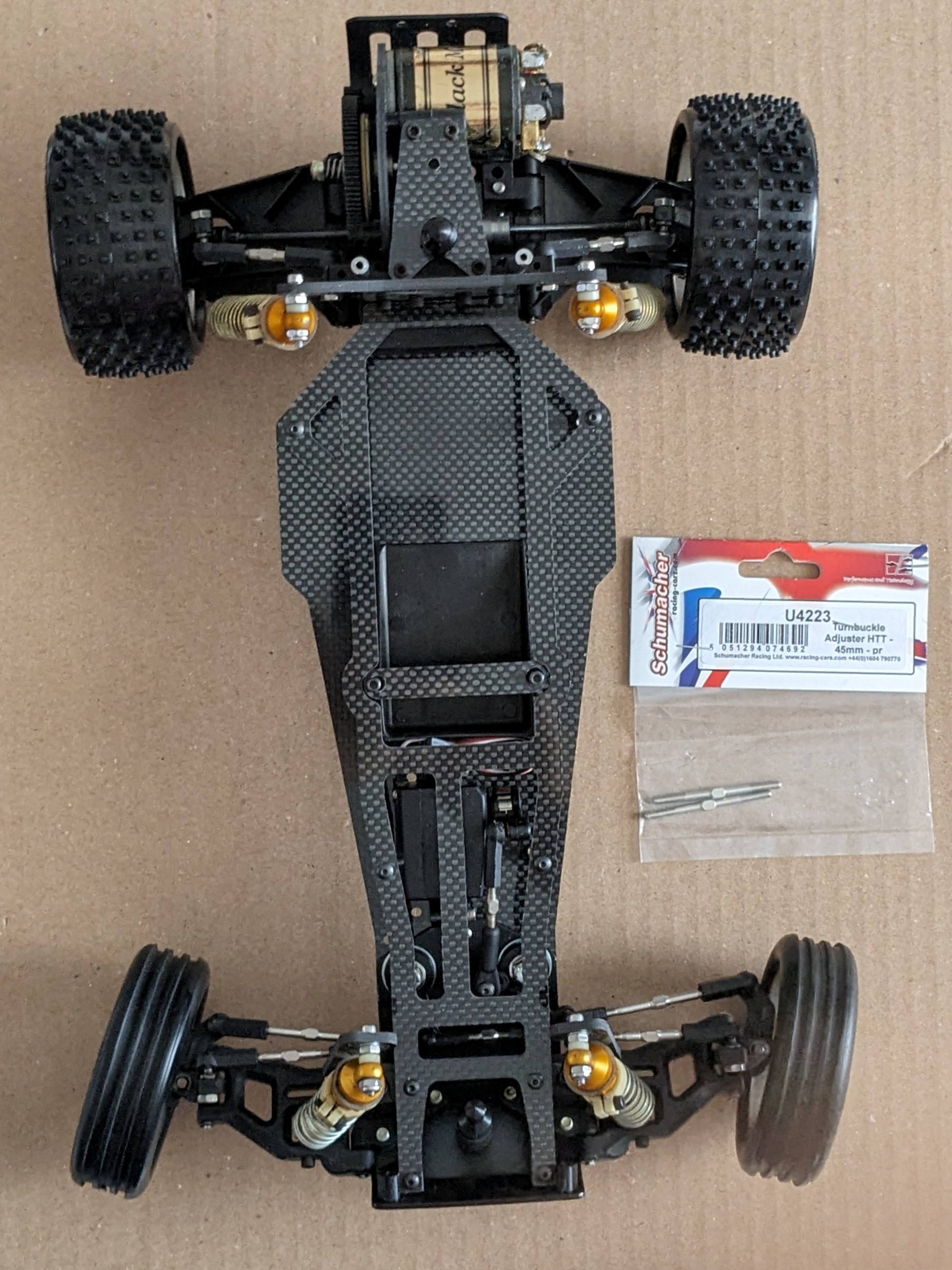

Hi everyone, new to Rc10 building.
I have this composite craft chassis with composite craft shock towers and front/rear Andys arms and stealth trans.
I need turnbuckles- but have no idea what to order- lengths - also would like to get something true to the vintage if possible, sticking with the after market theme :)
Then of course ill need ESc and motor- this will be a runner for fun so im thinking brushless with some power.
Thanks for any suggestions

Schumacher 3mm turnbuckles look a lot like Lunsford Punishers (no longer available) and Schumacher is available in titanium or steel.
My measurements look like:
Front - pair of 35mm, 45mm;
one 24mm and 30mm
Rear - pair of 24mm
https://www.amainhobbies.com/search?cID=&s=schumacher+turnbuckle

Those look good thanks for the link. As for sizes, would your measurements be similar to mine same set up? or does it matter?
I have an original gold pan and they are much to short.
Thanks

I forgot to add my picture. My measurements are for a gold pan setup on a graphite chassis with Andy's front arms.
