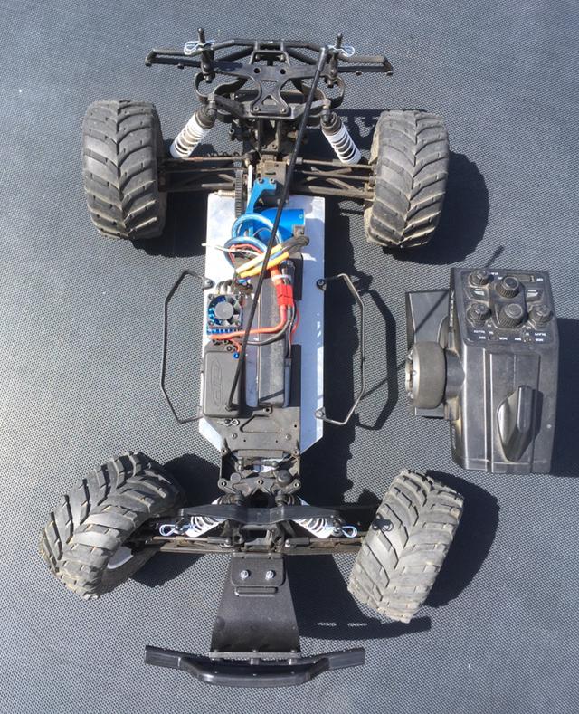

I don't need the height gained from the second spring but I think more dampening at such high speeds might possibly add some more stability. I figured to really help that the new shocks need to be attached to some other location besides the arm (like the steering or even the camber links) so it can actually remove some slop. I attached the old RTR shocks with no springs to the outer hub. I'll see if it has any affect on the stability. I am leaving the steering stabilizers off for now. I only like to make one change at a time.
After mounting I am confident that it will not have much affect on aerodynamics.

New front end is not lexan so I can't bend it.
Let's go with a simple wedge this time. Also, the 10b arms left my front nose too low. The t4/GT2 arms too high, so I cut the nubs off a pair of old Gt2 arms and redrilled holes for the lower shock end. This is IT. Perfectly level front to rear with the suspension adjusted evenly on each corner.
The steering DR is down to 18%. This car has never been so stable.

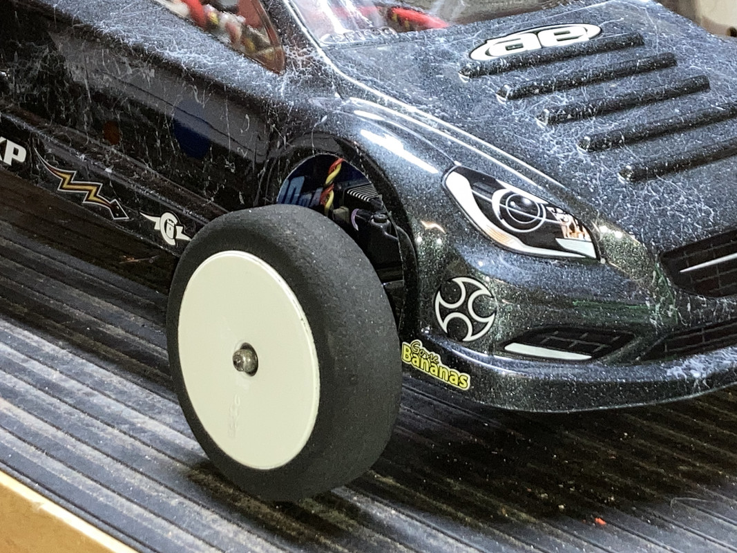

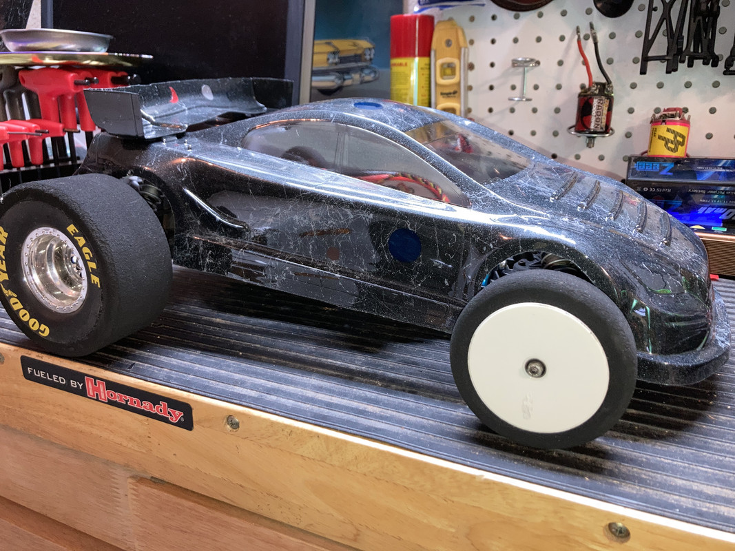

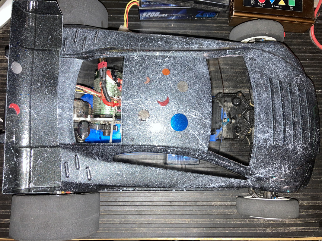

The absolute butt puckeriest part is done. All holes drilled. I used SC10GT mounts.

Unbelievable. The whole time all my problems were aerodynamics.
