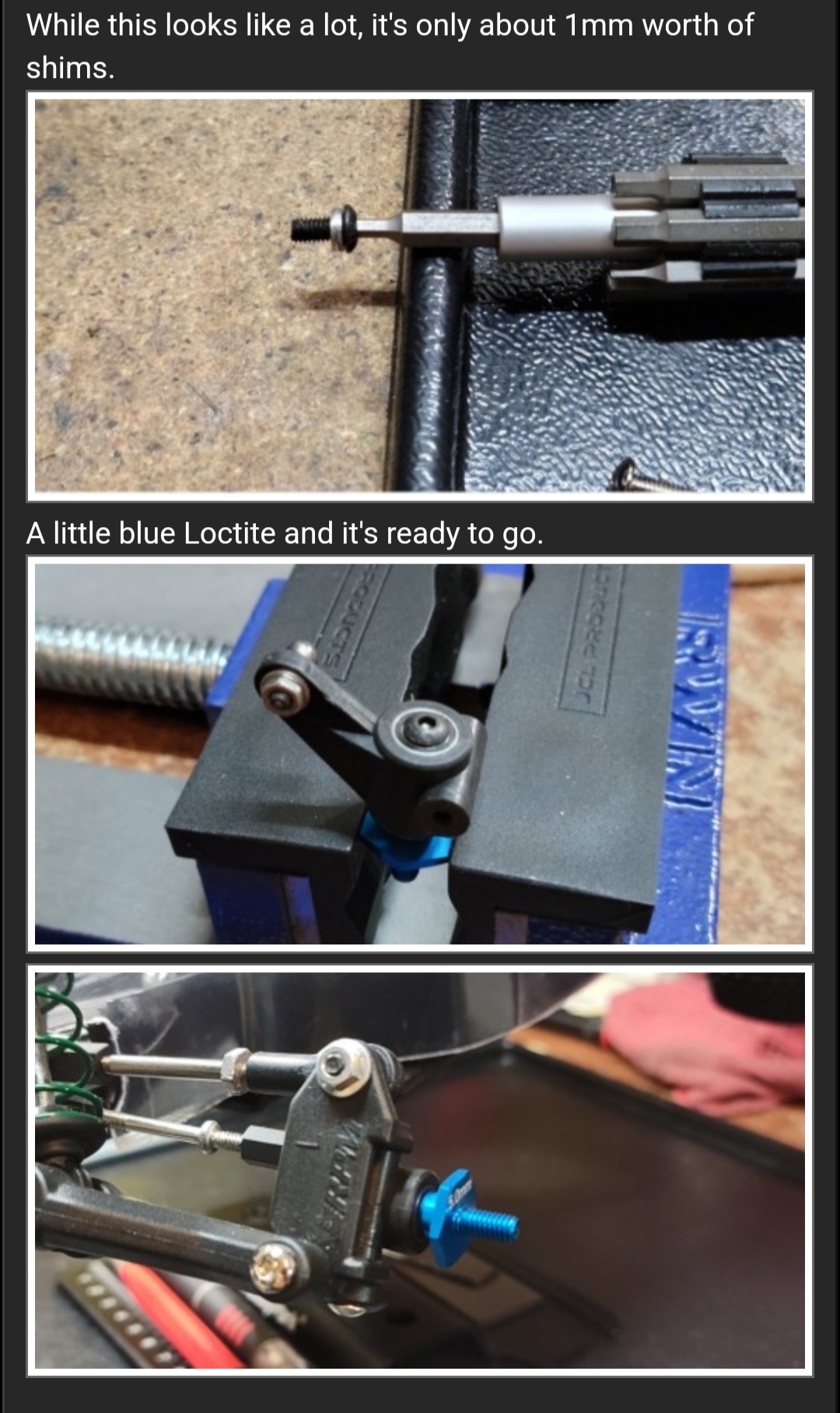

Traxxas parts would be the easiest to get. The 2WD Slash/Rustler/Stampede (Bandit uses 1/8" hinge pins) can be modified to fit lots of cars. They are plenty strong, should you need to clearance them.
If you don't like the axles and separate hex, the newer Associated one piece axles can be used with some 3X5mm shims.

So the one piece axles would work with the Traxxas parts? Do you happen to know which specific part numbers I should be looking for?juicedcoupe wrote: ↑Thu Feb 29, 2024 5:54 am Traxxas parts would be the easiest to get. The 2WD Slash/Rustler/Stampede (Bandit uses 1/8" hinge pins) can be modified to fit lots of cars. They are plenty strong, should you need to clearance them.

Not off hand (I'm at work), but they are the regular 2WD truck partsadam lancia wrote: ↑Thu Feb 29, 2024 5:58 am So the one piece axles would work with the Traxxas parts? Do you happen to know which specific part numbers I should be looking for?
This is a AE axle in a Traxxas carrier.

That helps. I'll do some web scrounging and see what I come up with.juicedcoupe wrote: ↑Thu Feb 29, 2024 8:52 amNot off hand (I'm at work), but they are the regular 2WD truck partsadam lancia wrote: ↑Thu Feb 29, 2024 5:58 am So the one piece axles would work with the Traxxas parts? Do you happen to know which specific part numbers I should be looking for?

Do you know if the Traxxas axle carriers fit the B4 c-hubs?juicedcoupe wrote: ↑Thu Feb 29, 2024 8:52 amNot off hand (I'm at work), but they are the regular 2WD truck partsadam lancia wrote: ↑Thu Feb 29, 2024 5:58 am So the one piece axles would work with the Traxxas parts? Do you happen to know which specific part numbers I should be looking for?

I have adapted the smaller (5X8) bearing type. They are only used on the brushed Bandit buggy (VXL's use the larger one) now. Rustlers and Stampedes also used them in the past.adam lancia wrote: ↑Sun Mar 03, 2024 9:02 am Do you know if the Traxxas axle carriers fit the B4 c-hubs?
The two sizes are interchangeable on Traxxas carriers but I haven't tried the larger type in B4 carriers.
I don't remember doing much more than reaming the kingpin holes to the larger B4 size.

Gotcha, thanks! It'll be a trial and (hopefully not) error thing some time down the road. I'll post my findings, whenever that happens.juicedcoupe wrote: ↑Sun Mar 03, 2024 10:50 amI have adapted the smaller (5X8) bearing type. They are only used on the brushed Bandit buggy (VXL's use the larger one) now. Rustlers and Stampedes also used them in the past.adam lancia wrote: ↑Sun Mar 03, 2024 9:02 am Do you know if the Traxxas axle carriers fit the B4 c-hubs?

So, I’m using the bigger Traxxas steering blocks with B4 caster blocks. There is a clearance issue at the bottom of the c-block when turning the wheels inside, and it cuts the turning radius by a quarter or more.adam lancia wrote: ↑Sun Mar 03, 2024 10:59 amGotcha, thanks! It'll be a trial and (hopefully not) error thing some time down the road. I'll post my findings, whenever that happens.juicedcoupe wrote: ↑Sun Mar 03, 2024 10:50 amI have adapted the smaller (5X8) bearing type. They are only used on the brushed Bandit buggy (VXL's use the larger one) now. Rustlers and Stampedes also used them in the past.adam lancia wrote: ↑Sun Mar 03, 2024 9:02 am Do you know if the Traxxas axle carriers fit the B4 c-hubs?
