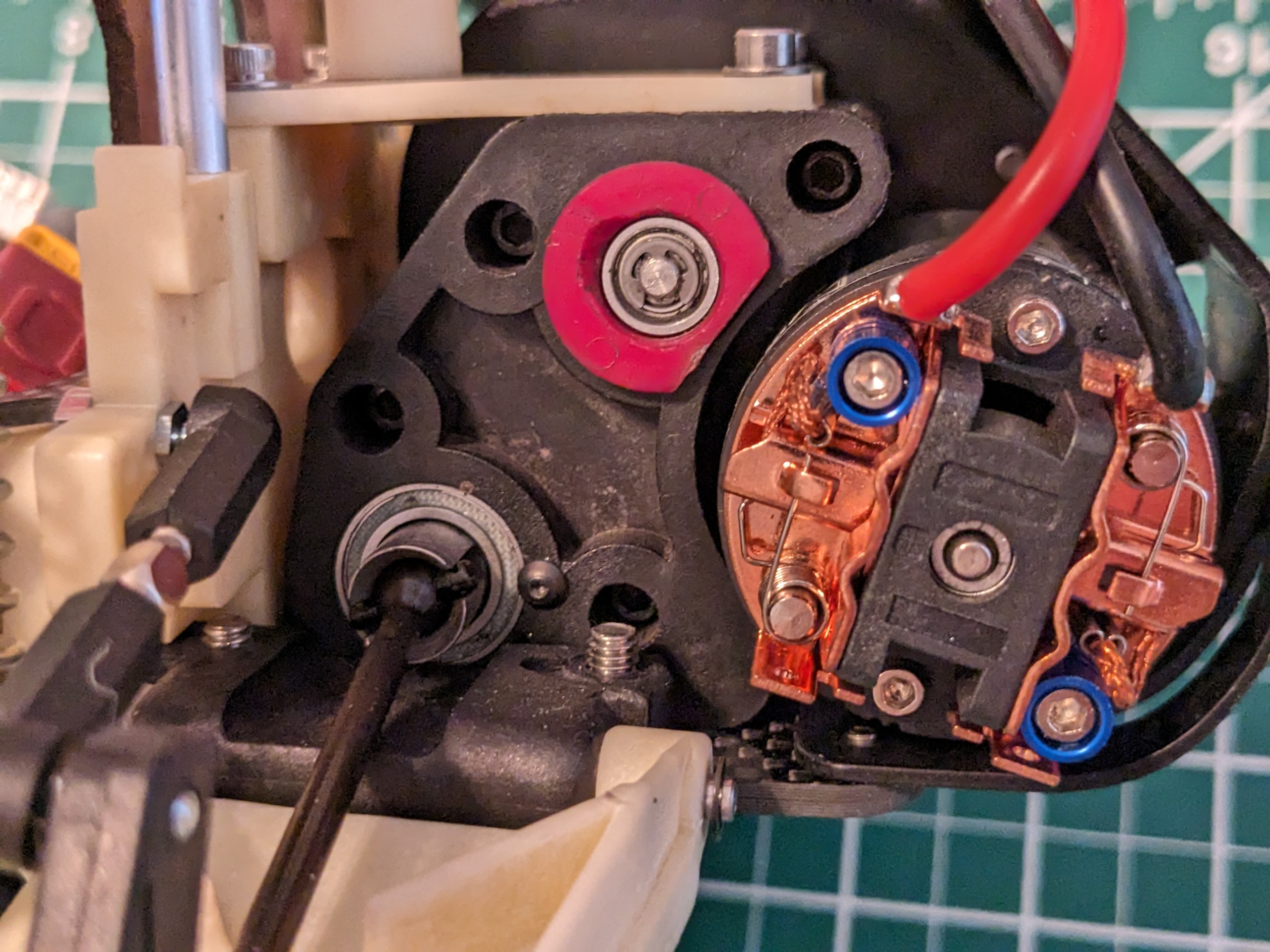

Welcome! For an RC10 runner with a 6 gear trans, the outdrive bearing mod seems like a must do to me. The original bearing setup with the outdrives seems like it gets sloppy/floppy and I worry about the outdrive metal gears then chewing up the nylon idler gears.
I do the mod just by adding the bearings and then one 2-56 screw (and washer if needed) to keep the left side bearing in place. On the right side the motor plate will keep the bearing from walking out.

My preference is for these outdrive bearings.
https://www.associatedelectrics.com/factoryteam/parts/details/6903-ASC6903-ft_bearings_3_8_x_5_8_in_ptfe_seal/
https://www.rc10talk.com/viewtopic.php?t=44362&sid=4bfa734d666cf3ba30214f43f817388b
https://www.rc10talk.com/viewtopic.php?p=541916&hilit=outdrive#p541916

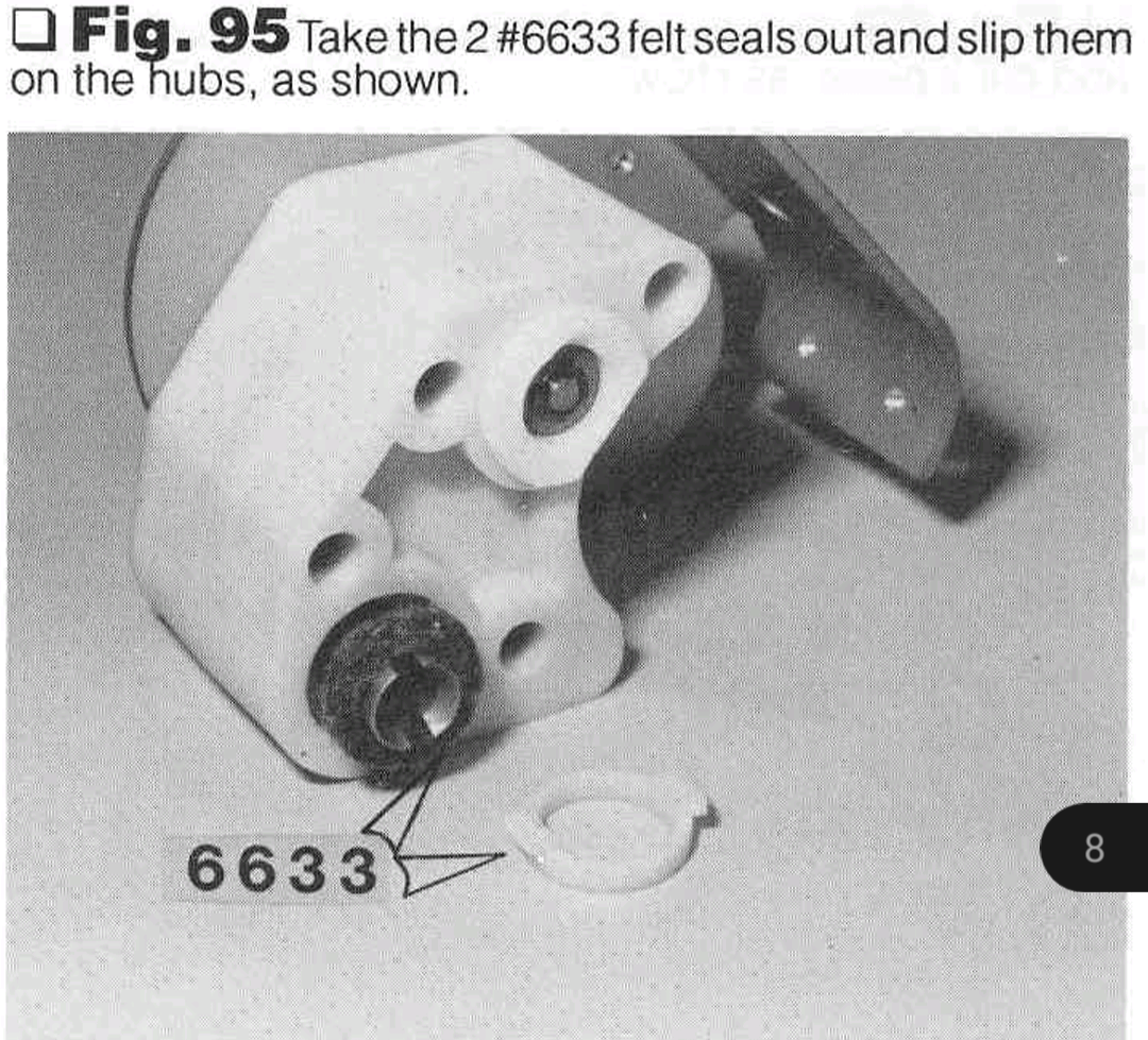

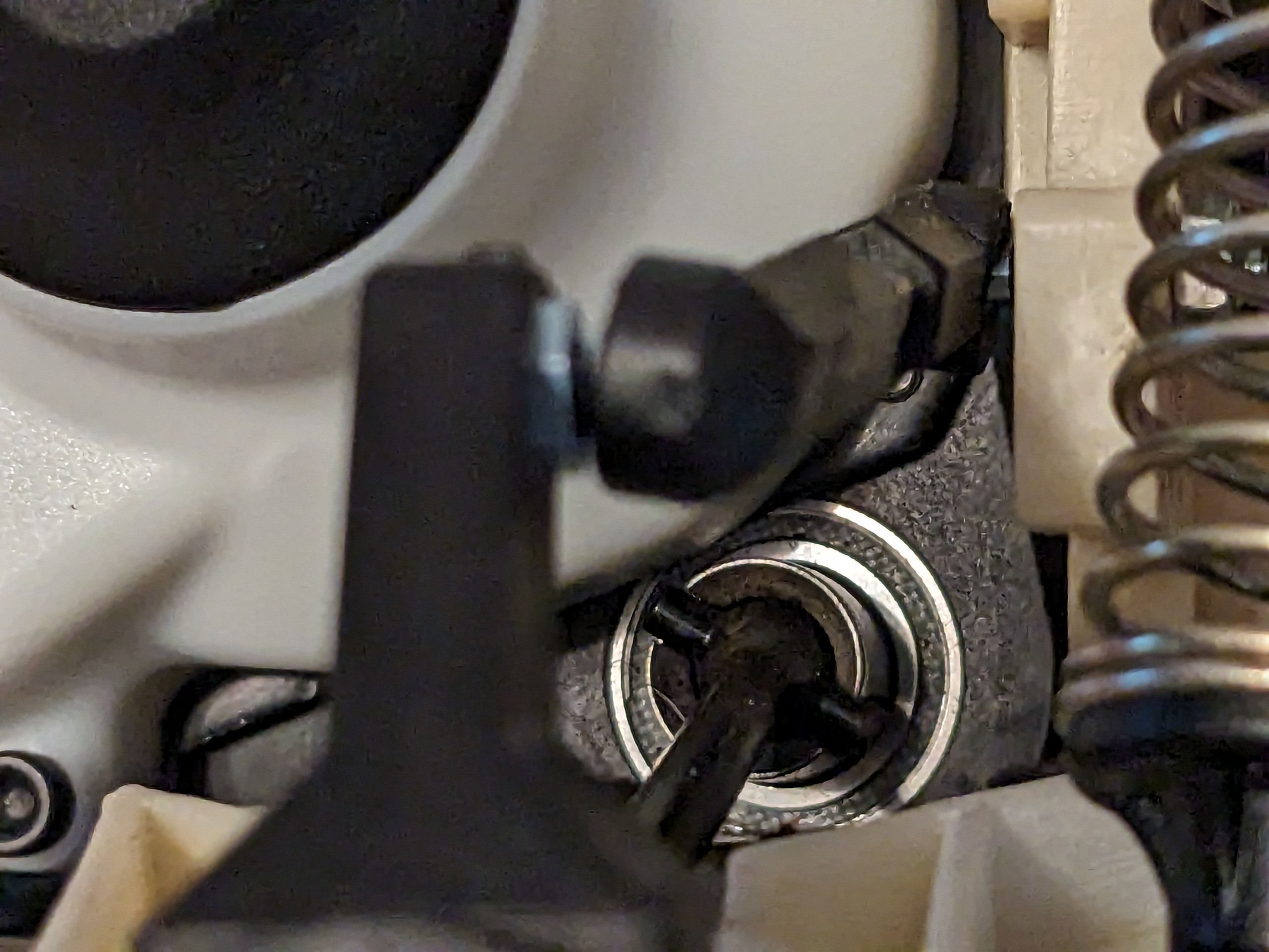

The outdrive bearing mod is actually adding bearings in a location that the 6 gear doesn't normally have bearings.

Do you have pictures of this?Frankentruck wrote: ↑Tue Apr 23, 2024 12:36 am The outdrive bearing mod is actually adding bearings in a location that the 6 gear doesn't normally have bearings.

Instead of an outer support bearing, each 6 gear outdrive has interal bearings and an outer felt seal + seal retainer. Replacing the felt seal + retainer with a bearing provides the outdrive with better support for gear alignment under load.Brendan2904 wrote: ↑Tue Apr 23, 2024 8:14 amDo you have pictures of this?Frankentruck wrote: ↑Tue Apr 23, 2024 12:36 am The outdrive bearing mod is actually adding bearings in a location that the 6 gear doesn't normally have bearings.
