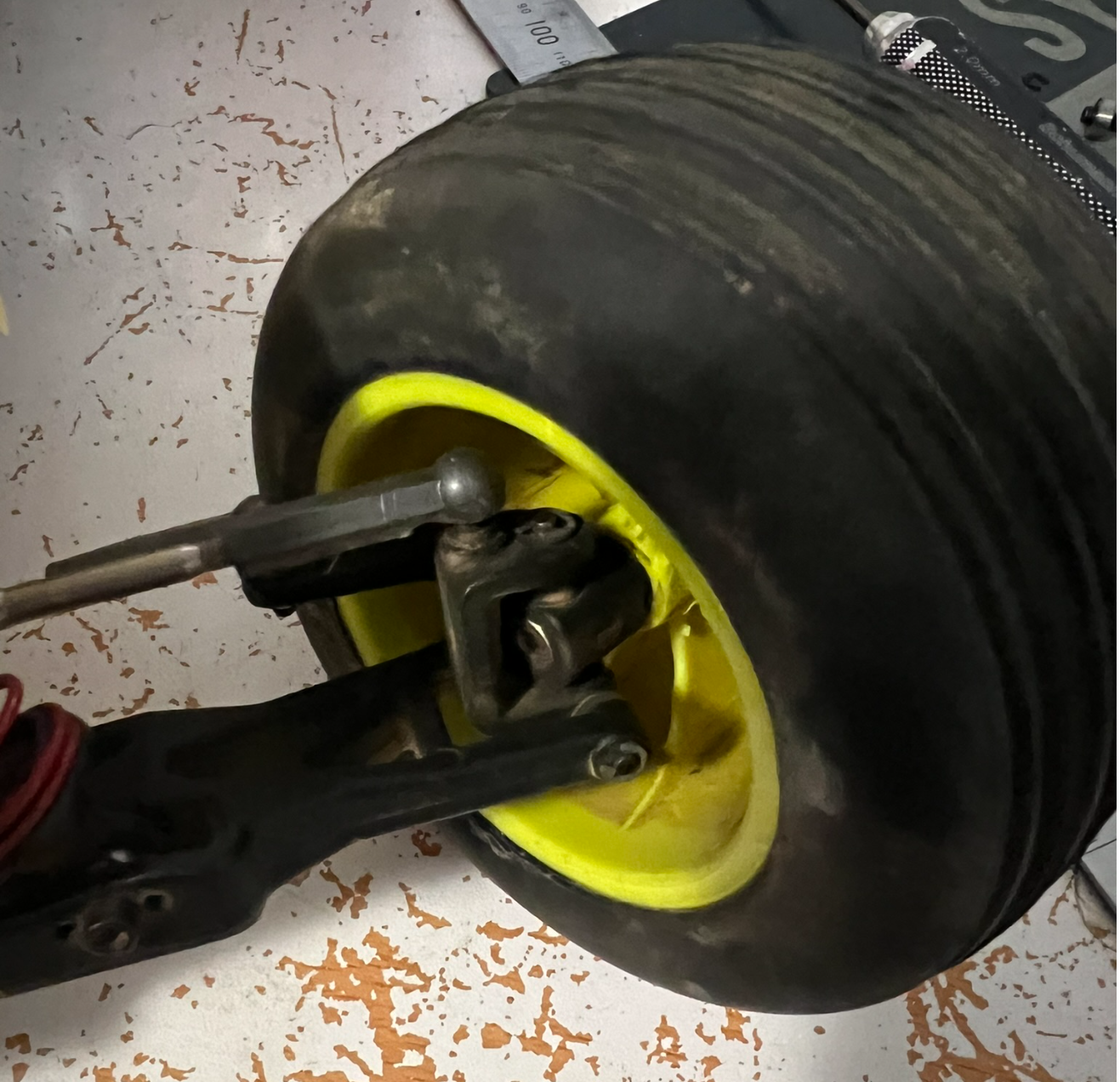

To run 10T or LXT front wheels on my XXT, I used a Duratrax Evader BX axle which doesn't have the additional offset/spacer bit that the truck axles have.

Only problem with a non-offset wheel axle is that the 10T rims still need modification so that the reinforcement structures on the inside of the wheel doesn't catch against the rear of the front arm at full steering lock. So there's a bit of dremeling/cutting to do there....for each g*ddamned wheel....and then there's still an intrinsic difference in wheel offset between 10T and XXT rims anyway. So you won't be able to get to the "correct" front width even with a zero-offset axle. Small price to pay, I suppose, until someone decides to reproduce XXT rims.
