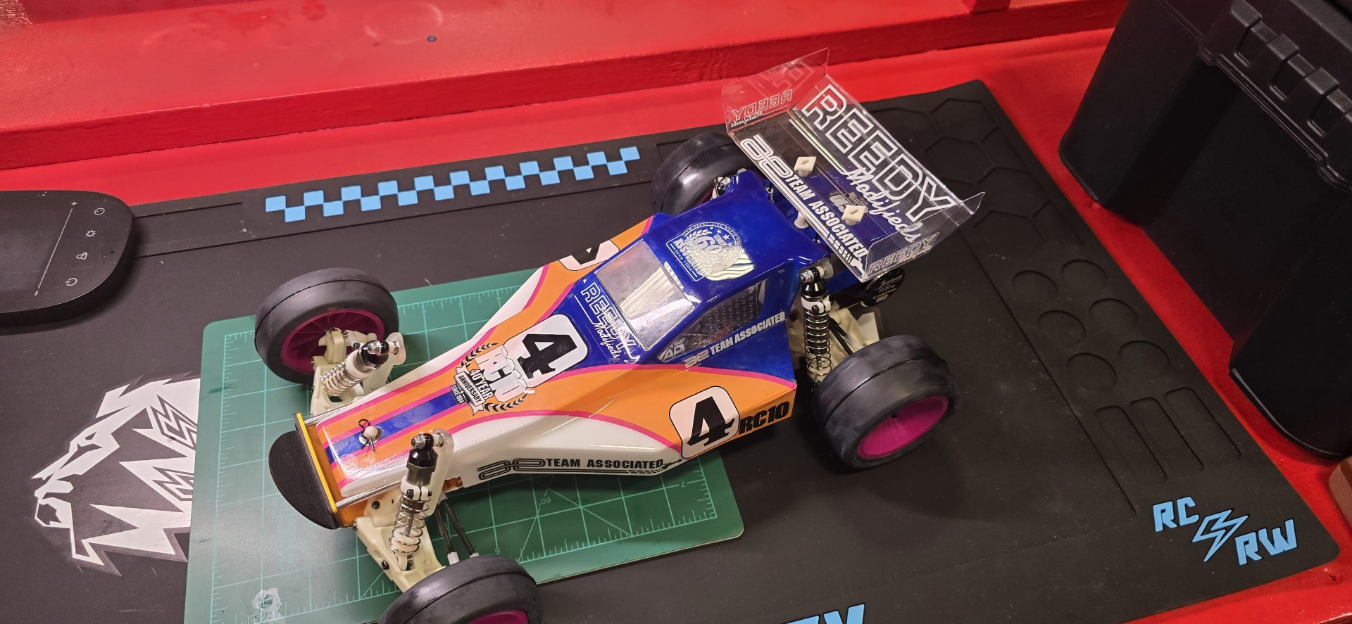

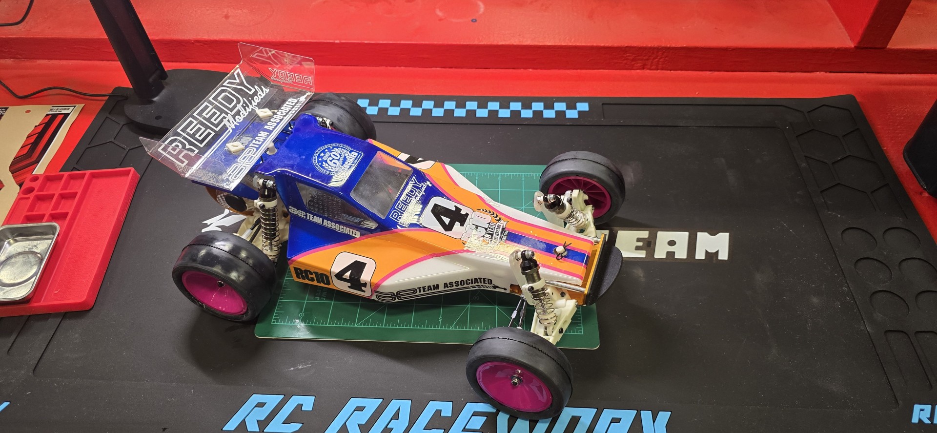

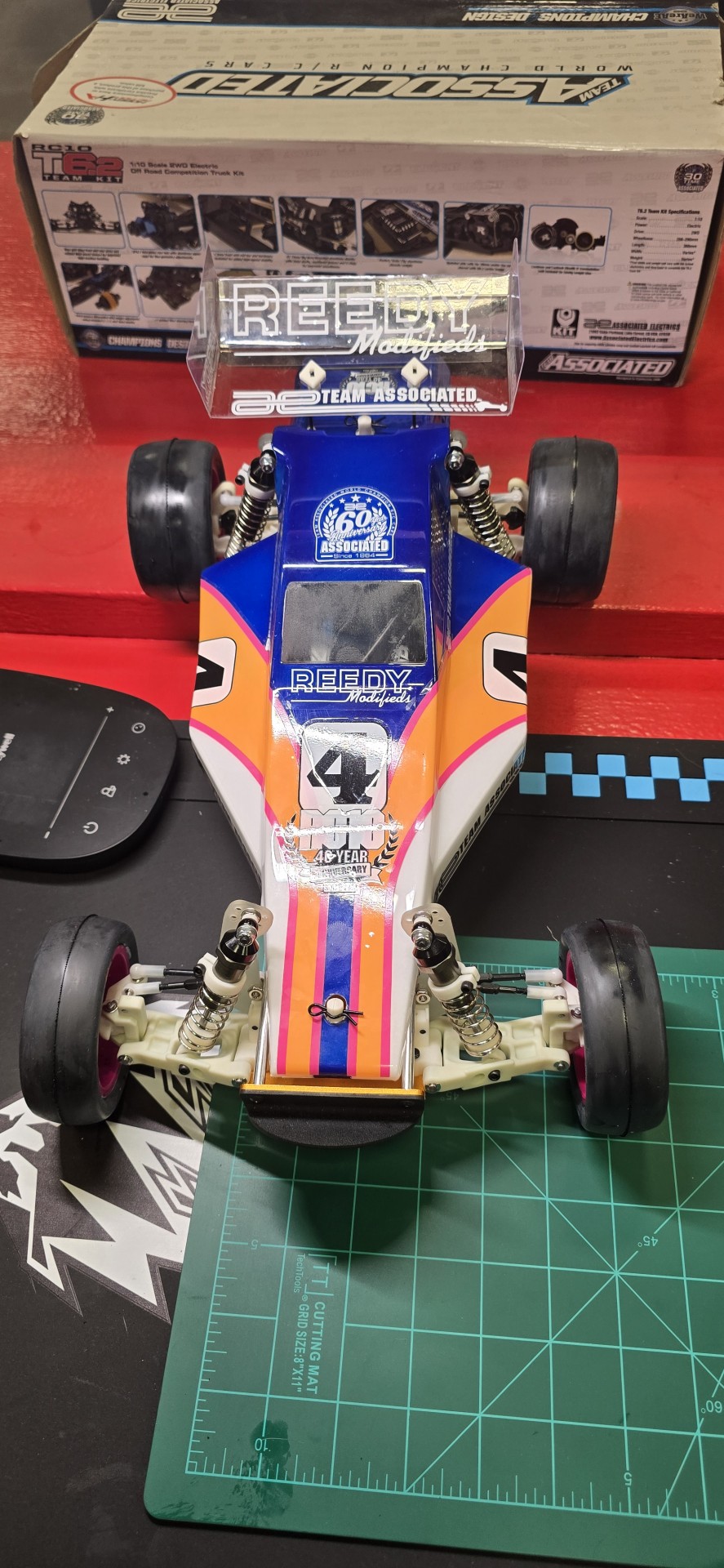

I finished painting and decaling the car very late on Wednesday March 5th and took it out to Hobby Action Raceway the next morning.
The car, still fresh before ever hitting the track.
I went with the manual art and decals, which I liked better than the box art. Pardon the fingerprints :roll:
At some point I will probably buy a second body and paint it up in the box art.

Hobby Action Raceway is where they just held the 2025 Desert Classic and the track was still in the race configuration, very high traction and very technical. Not ideal for a vintage first outing. I didn't keep it right side up the whole time but did manage to get around well after lowering the front ride hieght and adjusting camber and toe.
