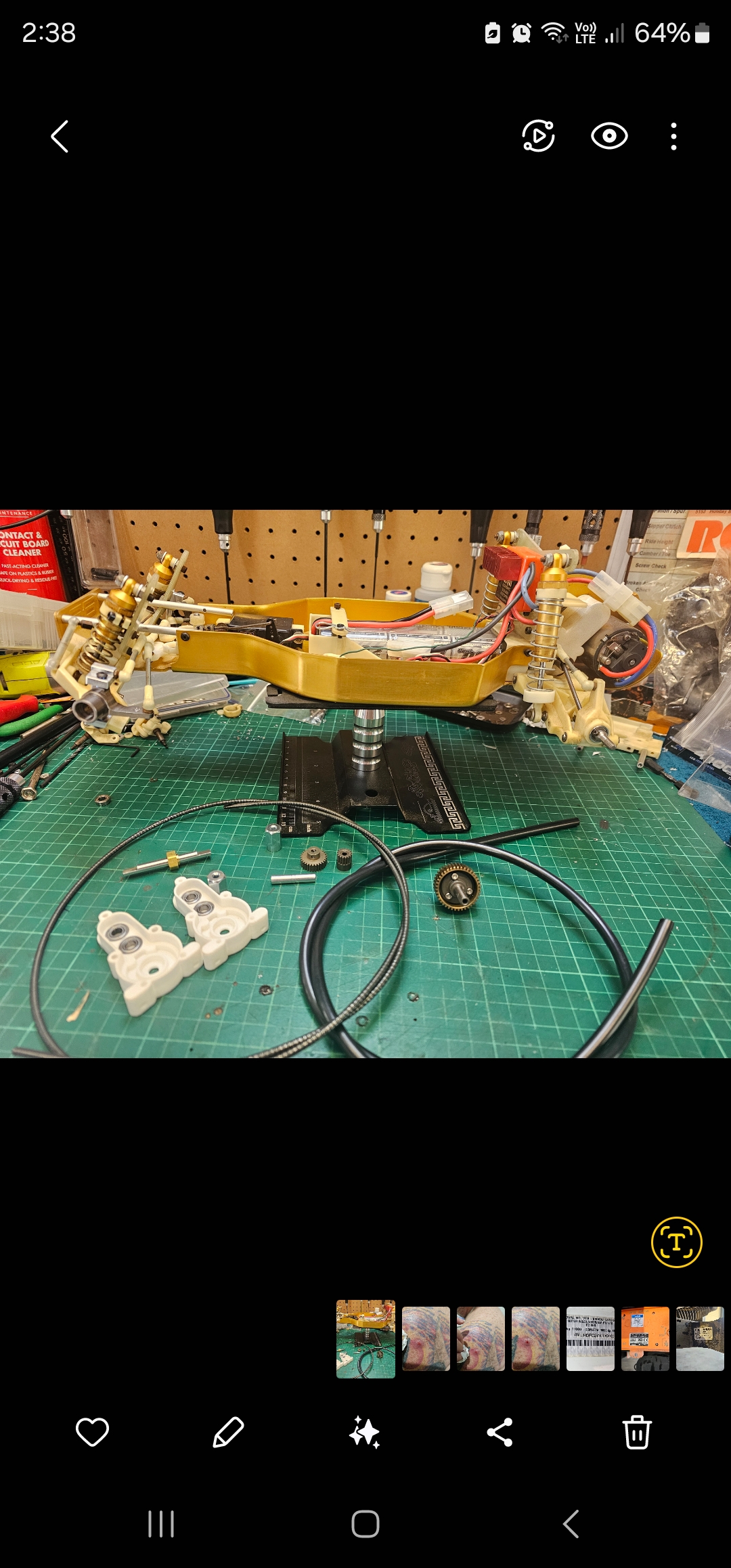

I have two shapeways mip gear box casing, a cable, cable tube , c hub carriers , hubs , just need to know how many teeth are on the top shaft in the front gearbox , I have worked on how to do the front drive shafts.

I would like to upload a photo of what I have but I can't, so I'm going to put it on the Facebook rc10talk.com page

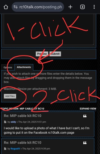

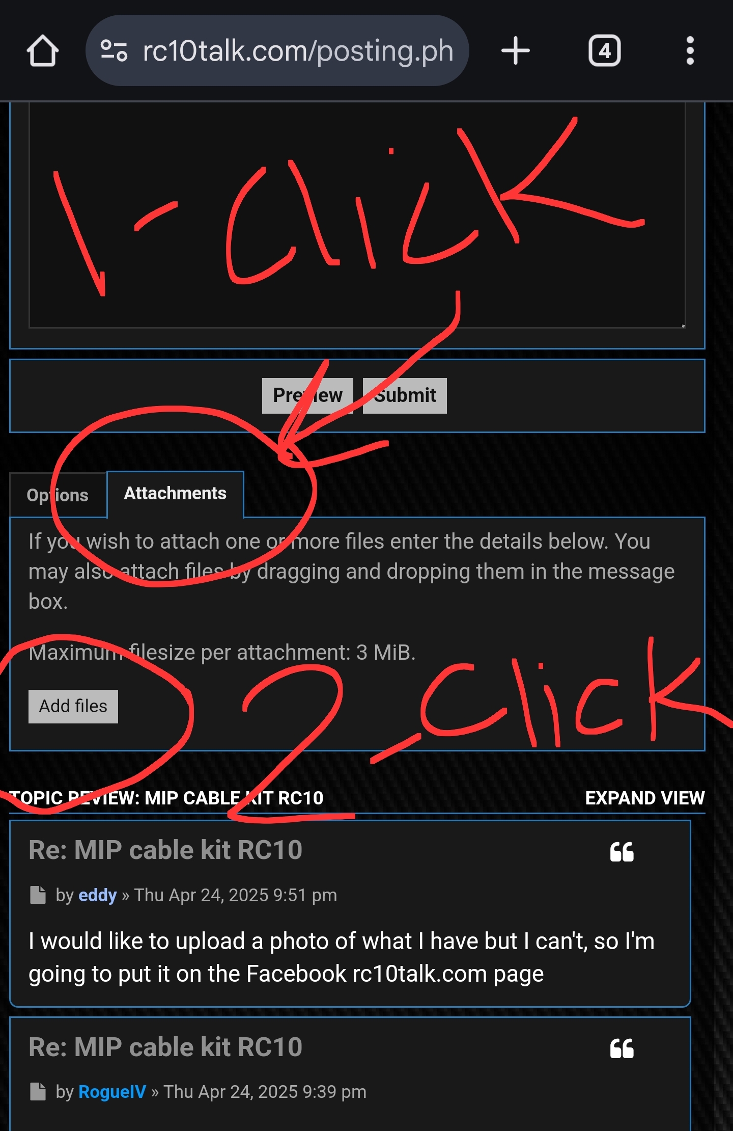

eddy wrote: Thu Apr 24, 2025 11:51 pm I would like to upload a photo of what I have but I can't, so I'm going to put it on the Facebook rc10talk.com page
Posting pictures on this site is super easy. See my visual aid below.
If the pictures are too large, simply screenshot them, and upload the screenshot picture.

Thank you for your help, hope this works

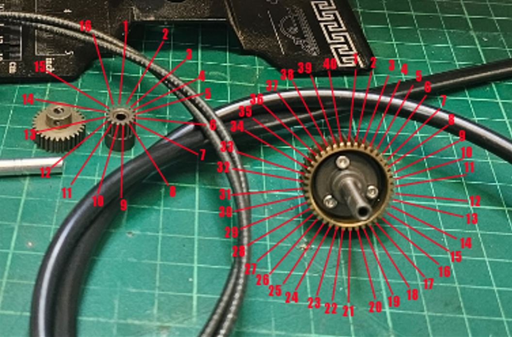

...and based on the pic he posted while I was typing... if I count right it's 40/16... so 2.5 ratio. If the front and rear diff gears are the same he should need a 16-tooth top shaft... if the front diff gear is different, then front diff gear divided by 2.5 it appears.

I have counted the bottom gear and it was a 29t and after looking at photos and trying to work it out for the top gear it could be a 16 or 18

The diff you can see in the photo is a rear throp dirt burners

40 tooth diff... 16 tooth top...
A clearer photo of the gears would be more definitive but... is this a pic of your parts or a pic you found online?
