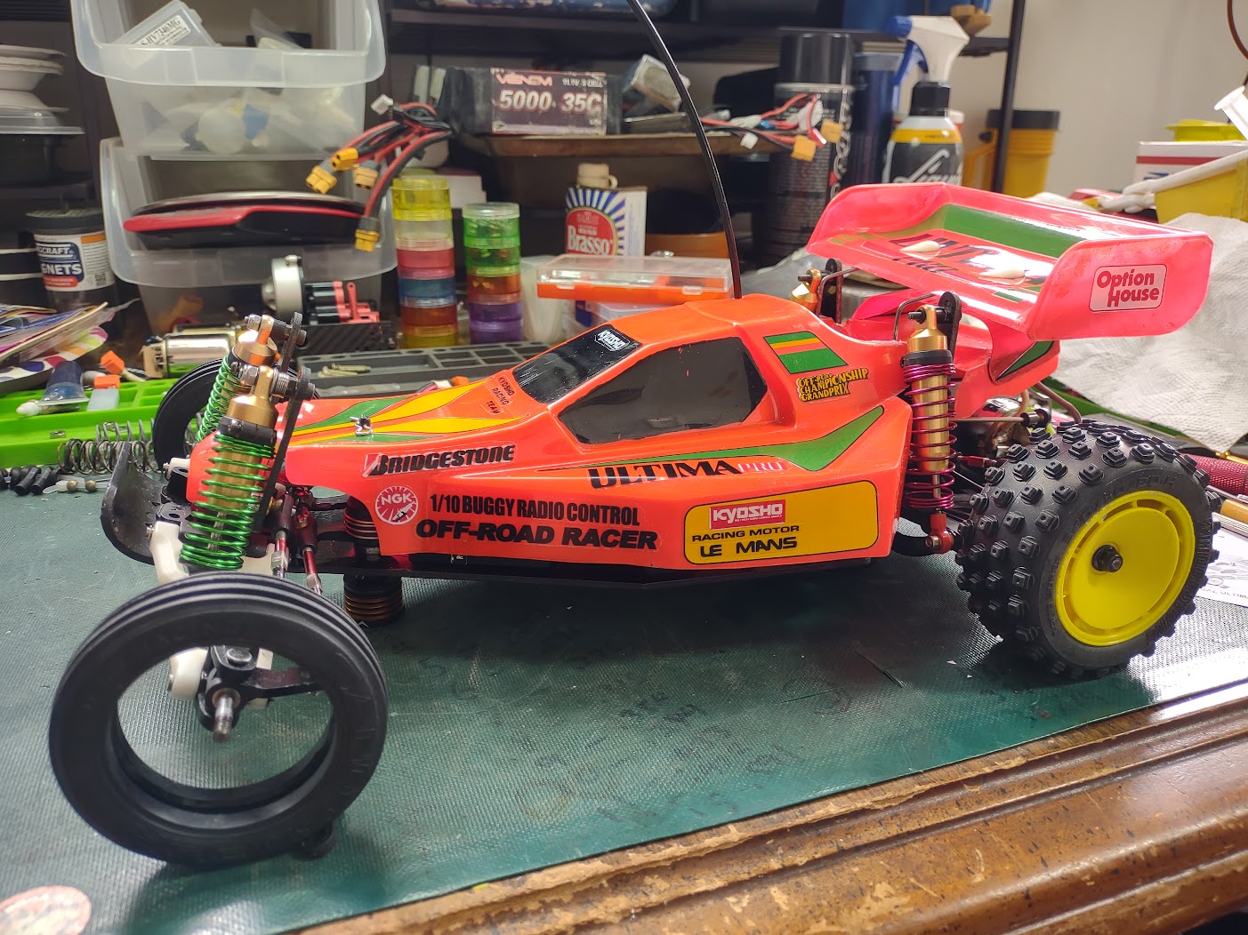

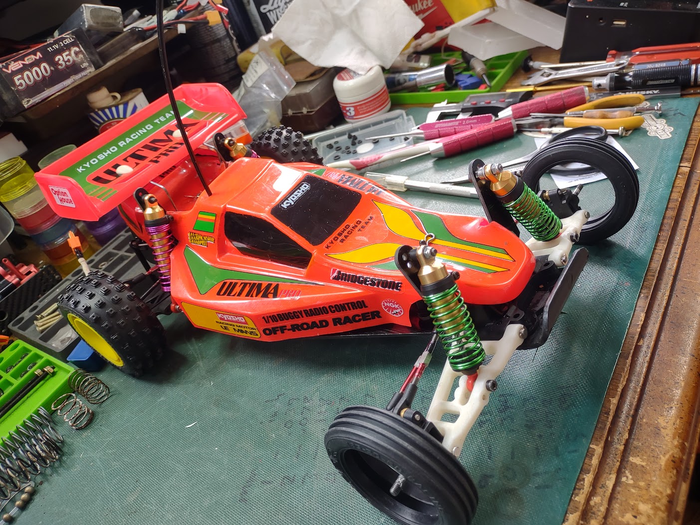

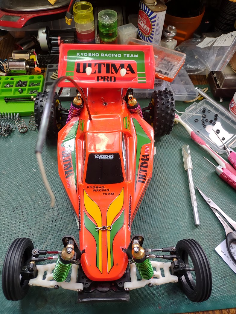

Today I got a sticker set in the mail so I decorated the original body to resemble the picture on the manual.
Sticker pics below, notice my high tech blue tooth front wheels.
