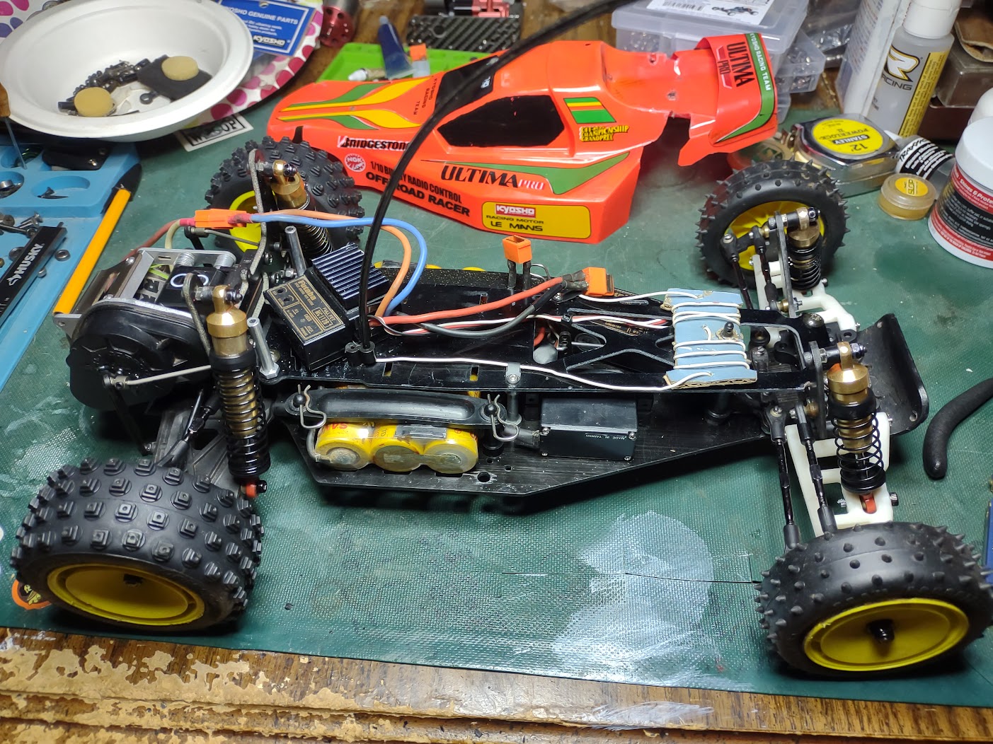

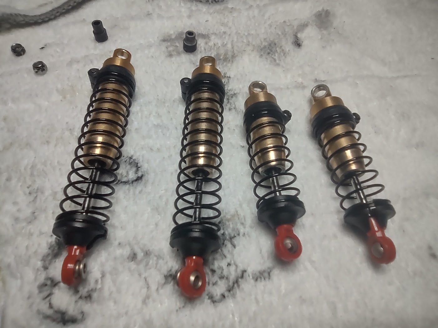

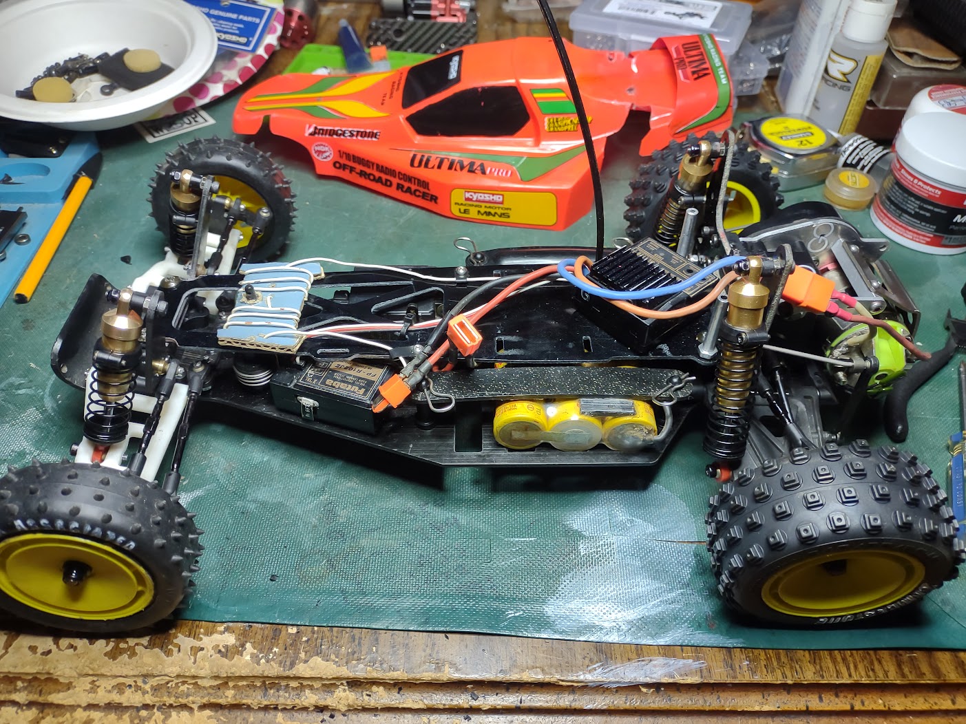

Not quite ready for running on the track, I still need the axles and I have to finish up the shocks (they need a little luvin with some polish).
But it is looking the part:
Swath
Posts: 40
Joined: Thu Dec 17, 2020 1:56 pm
Location: Coal Creek Canyon CO
Has thanked: 30 times
Been thanked: 13 times
Re: Ultima Pro Restoration
Post by Swath »
