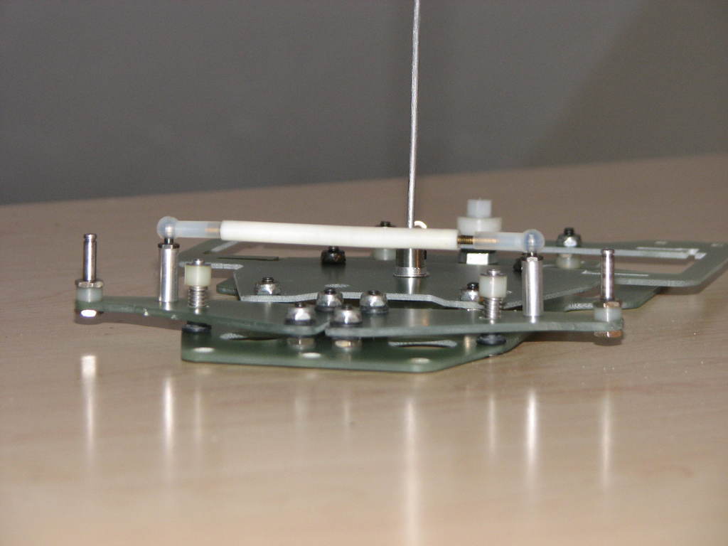

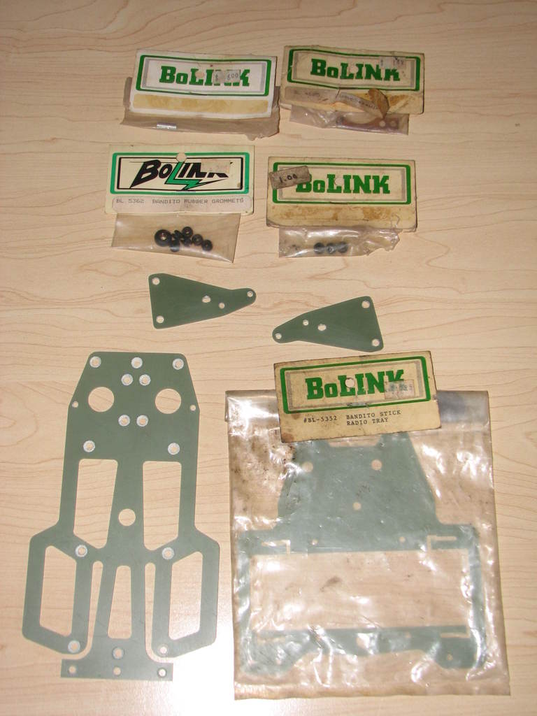

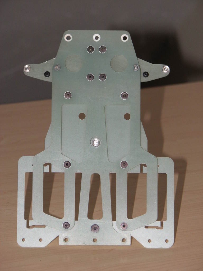

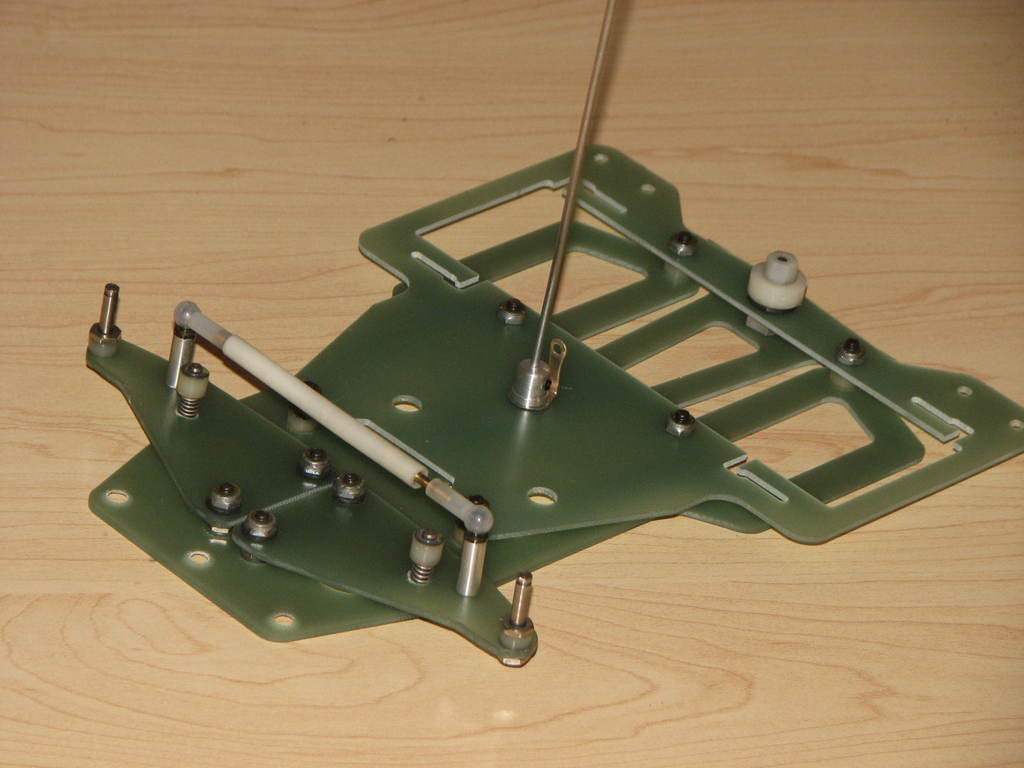

Well the starting point is this little dirty bug hoping to find a period correct bolink body
rear pod is used but i have a aluminium technique that should make it work.
Ryan

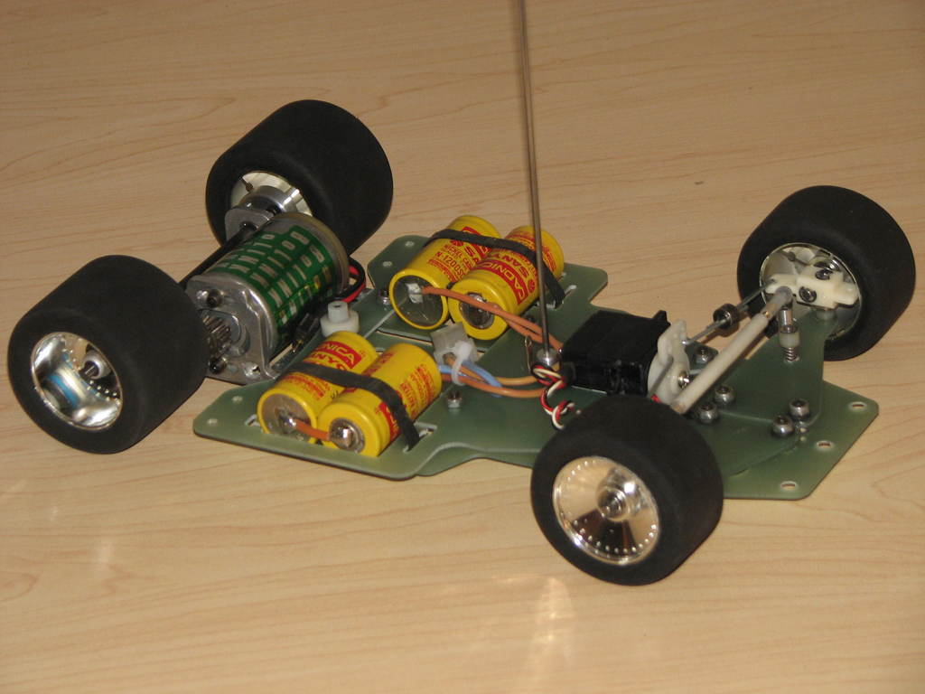

Sweet little Bandito, it almost makes me want to build my Parma Euro Panther.

It looks very industrial with the chrome wheels and no tires.
Are the wheels some of the Steve Rule closeout items? They do look a little too modern for the chassis, they are very 12L like. Shouldn't it have the black wheels with Road Hugger tires?
Still an outstanding car.

Yeah just threw em on for the pics there ae 12l wheels the road huggers are going to pretty hard to find. i do have some new 12e rims that might work. I like the whole no foam look it gives it that museum look

Well i think the paragon's will stay got some period correct wirring and steering servo and sanyo's. Man trying to fit a old futaba reciever on this thing
Maybe what i got on there is enough.
