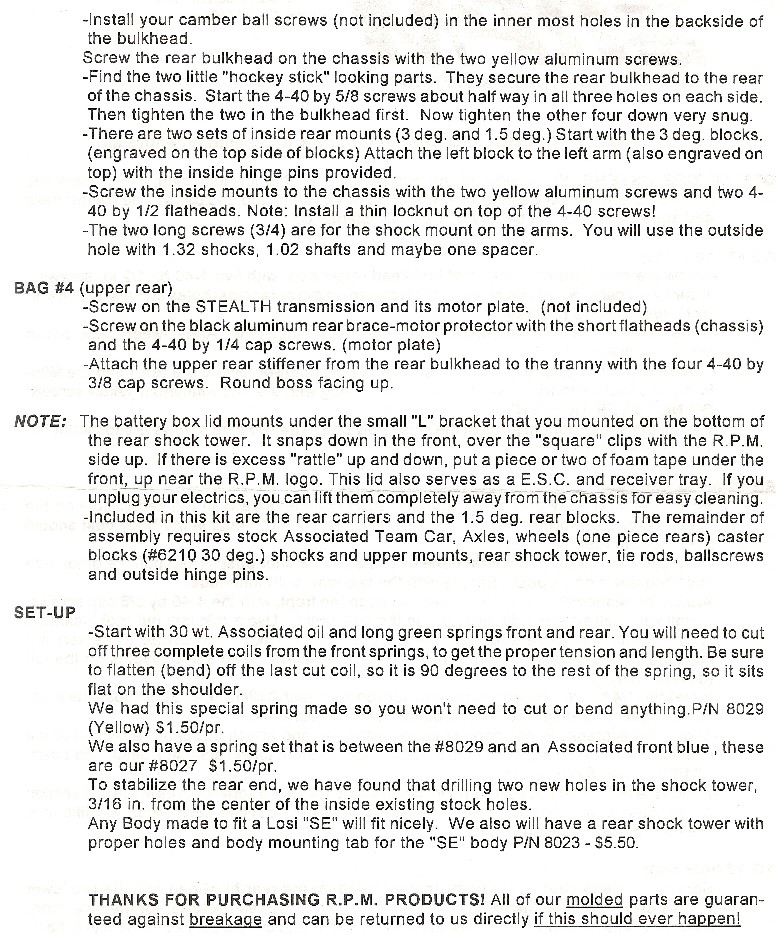

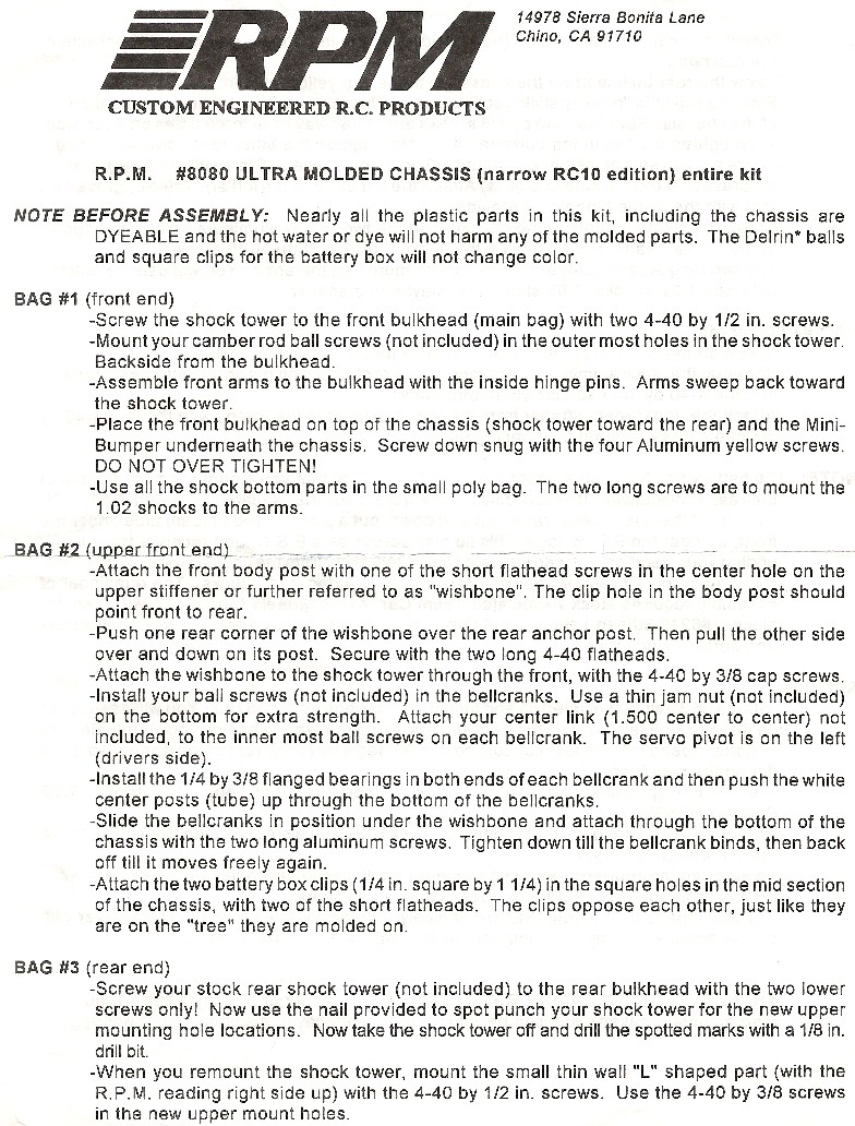

Do's any one have a copy to repost? the link dosnt work :o
Posts: 16805
Re: RPM Worlds Car Instructions
i've been meaning to. give me a little bit.
Posts: 16805
click for larger image.........
