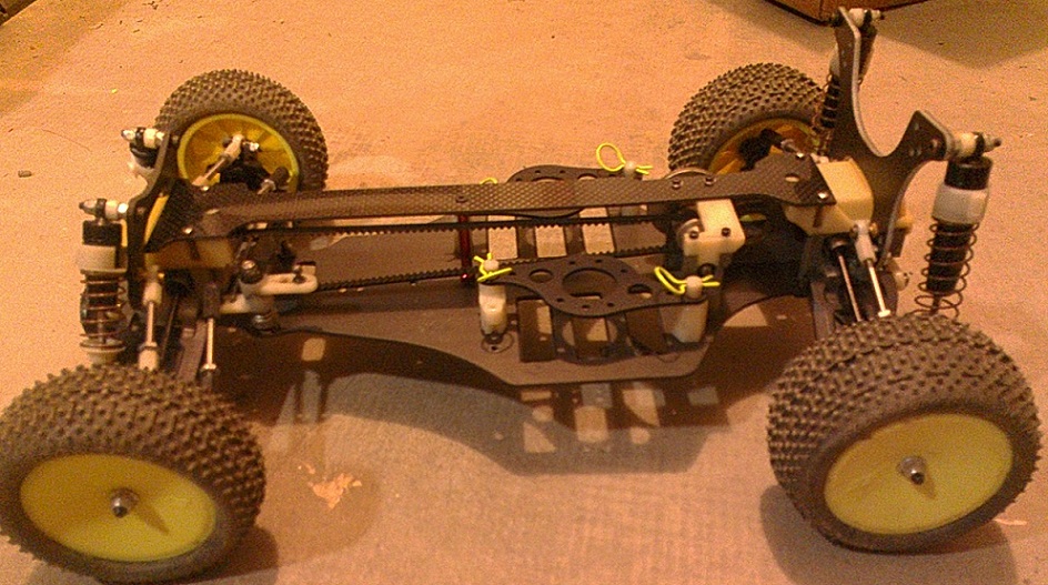

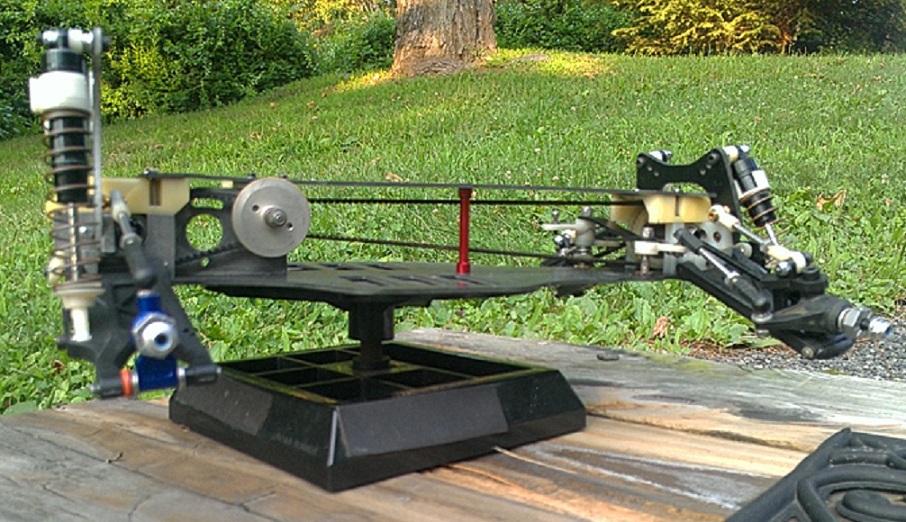

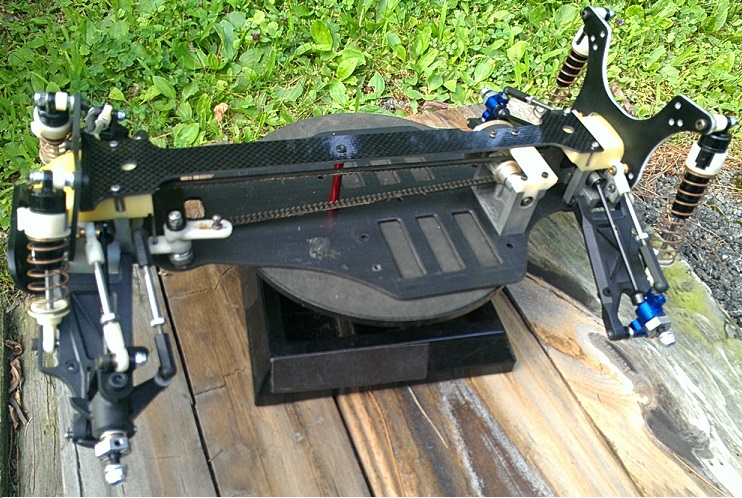

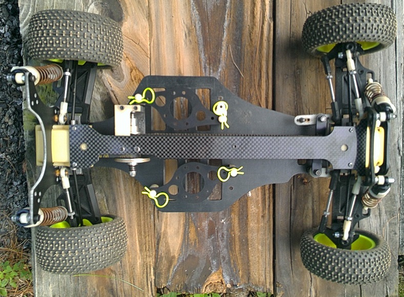

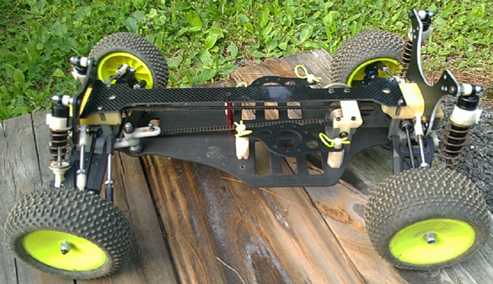

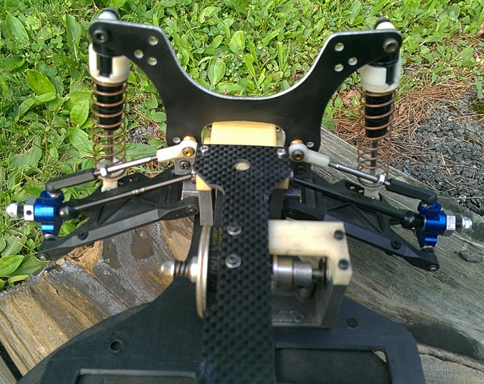

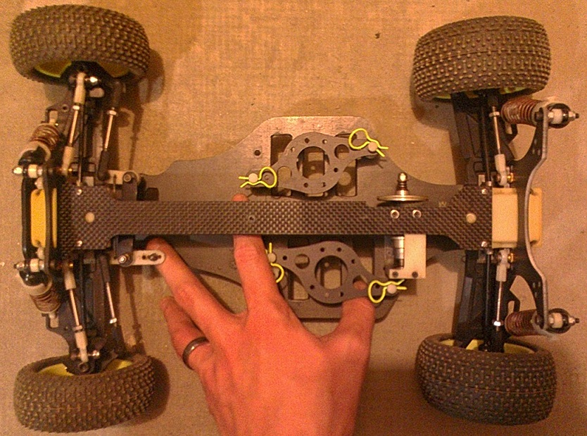

Well, I bit the bullet and picked up AE big bores for the '93 Works runner. SC10 rears and B44 fronts. 1.5mm pistons in the rear with 35wt oil and Losi red springs. 1.6mm pistons up front with 35wt oil and Losi green springs. This certainly helps keep the rear from bottoming out, as it has more pack than the Kyosho damper pistons could offer, plus a lot more travel than the RB5 rear shocks. I plan on taking it to the track this Saturday to see how it runs. Assuming no disasters, I'll upload a video...
In the meantime, I figured I'd post some pictures now of the Works hybrid project. There's quite a lot of stuff going on here...

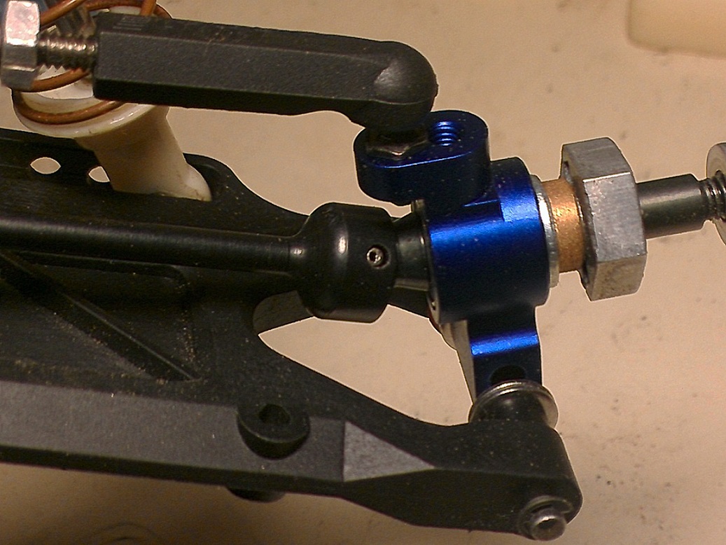

Delrin front buklhead came with this chassis. I don't know who made it, but it's pretty cool and would be suitable for a runner. I swapped out the steering knuckle kingpins for some 4x8mm hex screws. These specific knuckles are well used, so I figured I'd pre-emptively put bigger screws in there to avoid the risk of losing the kingpins on the track. It takes quite a bit of effort to thread the 4mm screws in there, but they hold firmly and don't seem to cause any bind. The front tower is a '91 Works tower (I had a spare one, so I decided to throw it on here), and I added a RCPS steering brace (so it's basically a '91 Works front with a '93 Works rear). Front CVDs are a combination of Yeah Racing DB01 front universal dogbones with Team C wheel axles. The wheel hex mounts a bit far out from the outer bearing, so I picked up the slack with one washer and a 5x8mm bushing. This does make the front wider than the rear (using Lazer ZX5 SP 73mm universals in the rear, which are CVD style rather than CVA style as up front). The only metric wheel axle that is CVD style that I could find which may help with the width issue is for the Losi 22. I'll give that a try and see if it addresses the front/rear offset. This would also be helpful to push the rear wheel out a bit, as otherwise it runs dangerously close to grinding the rear suspension arm against the ribbing on the inside of the rear wheel. Rear hub carriers are aluminum units from the Lazer ZX5 (zero offset). I did not have any more aluminum rear bulkheads, so I took some Scotch Brite to one of my magnesium spares, cleaned it up, and mounted it here. I'm using the '93 style inner hinge pin turnbuckles front and rear, which are really great for picking up any slop in the arms/bulkhead. The only issue is that the more slop you have, the more toe-in or toe-out (depending on which way you set the turnbuckle) you end up with when you tune the slop out. The upper deck is from rccars4sal and was originally designed for the 870c. I decided to try it out on this chassis, and it is an almost perfect fit, with just a small gap between the front portion and the front shock tower. I'm thinking of trying to fill that space in with some kind of rubber spacer to help with impact cushioning. I did not slot the mounting holes on the upper deck for tension adjustment, and it turns out that the tension is fine as-is, when you set the motor mount and rear bulkhead in a position to accept the upper deck.
Still a bit of work to do, but so far this is where it stands. It's a bit of a mut, but I figured I have enough "pure" YZ10s and so why not try something different here. I'm really hoping the hex conversion works out, as right now my only other YZ10s with hex conversions are two 870c's. I doubt that I'll actually run this one, as I have enough runners as it is, so I suppose this is more of a concept chassis just to play around with different things and see what's possible.

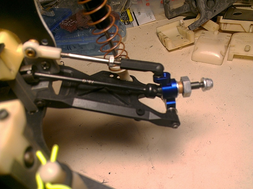

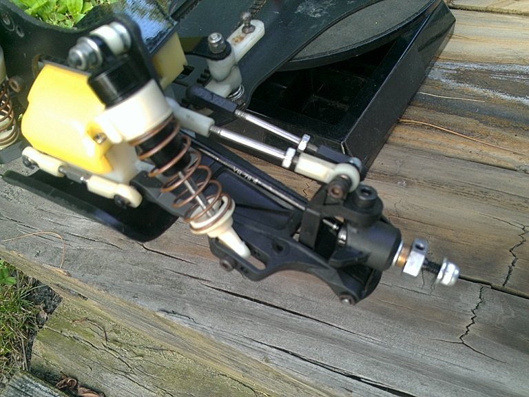

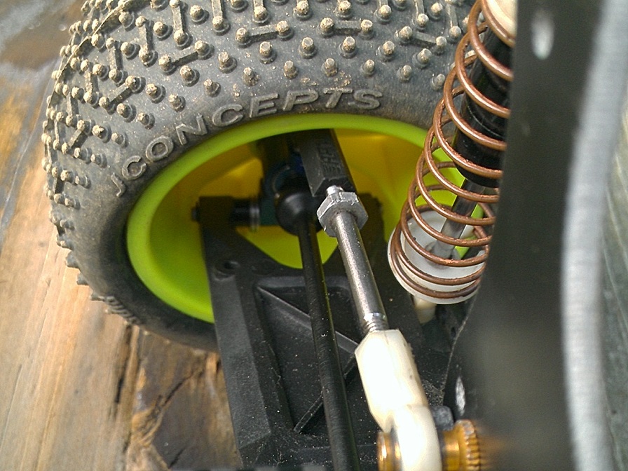

So it would appear that the Losi 22 rear CVD wheel axles indeed do the trick. Merging it with the Kyosho 73mm dogbone does require some finagling, though. The CVD insert for the Losi part is a larger diameter than the Kyosho part, and the CVD pin for the Kyosho part is a larger diameter (and longer) than the Losi part, so you can't really mix and match there. What I ended up doing was use the Losi insert piece with an AE CVD pin. The AE pin is just long enough to run the diameter of the wheel axle, although it is a very tight fit through the Losi insert and so once you force it in there, you're not getting it out. Ever. So be sure you are sure about this before proceeding.
With this plus the aforementioned front hybrid CVA assembly, there is a roughly equal offset for the wheel hexes front and rear to result in at least comparable front and rear track widths. It's not perfect, but it is as close as I can get with the parts that I know exist. The only other thing you need to be aware of is that the Losi rear wheel axle is a larger diameter at the point where the wheel mounts. Not a problem if you are using Losi rear rims, but if you're using B4.2/RB6 rear rims like I have here (JC Mono rims), you will need to ream out the wheel hole a little bit for a smooth fit.
I may end up selling this one, but I am not entirely sure. I spent quite a lot of money figuring out the hex conversion, and the original chassis purchase was a bit overpriced, so I am doubtful that I'd be able to recover my investment here. I'll think about it...I may make a few changes to it if I do sell it, though...
