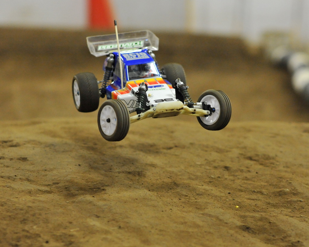

here's the parts list for my car........
front:
rpm worlds front bulkhead
rpm worlds front arms (dynotech klein arms....... same thing)
andy's pro graphite front tower
rc10 castor blocks
rc10 steering knuckles (6220..... for aluminum axles)
wide gt front axles
b4 jconcepts rulux rims
rear:
stock rear chassis
rpm 10t rear bulkhead
10t rear tower (modified)
1.5 associated arm mounts
rpm worlds arms (dynotech klein arms..... same thing)
losi rear hub carrriers (2038)
b44 rear cvd's
b4 wheel spacer
kranzels .200 wheel spacer (needed to clear outer shock mount on the arm)

i have a b2,b3,t3 slipper setup in mine. mainly because my car has the rpm 2.65 stealth trans with the topshaft for the slipper. if i had the 2.65 trans for the hydra, i could've used the b4 slipper assembly.

awsome looking ride!!! great work
