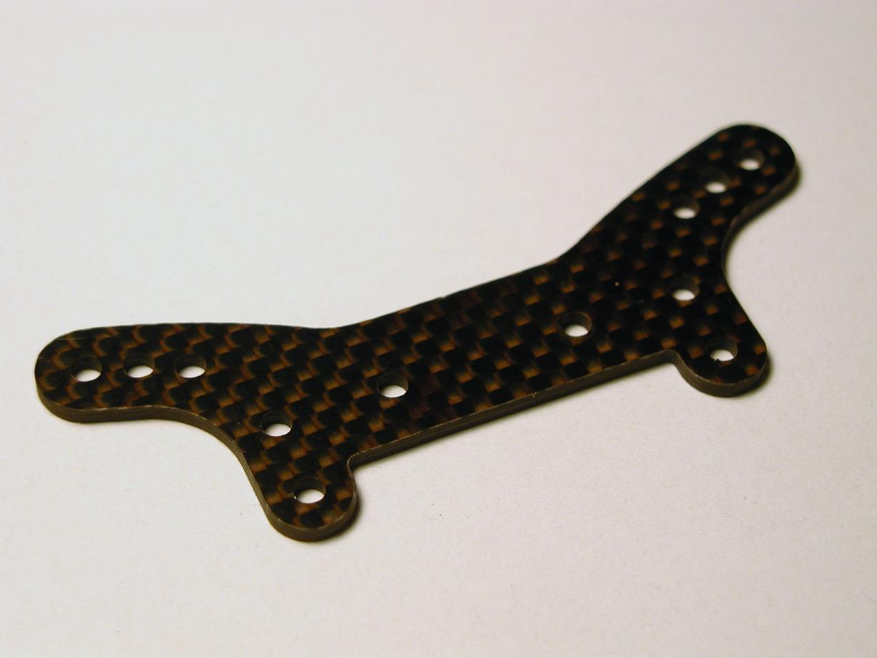

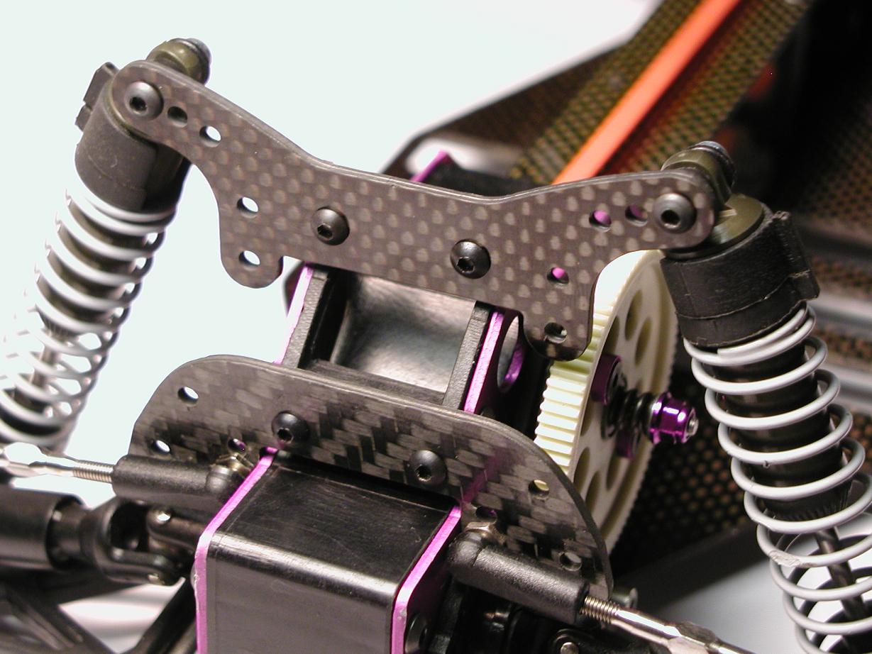

Not trying to hijack the thread, but here are pics of the new rear tower I promised. So far they look pretty good, but I may revise the holes a little. The wing mounting holes are made for the ZX5/Ultima RB wing mounts btw. -Jeff

Those look sweet, how did you cut them?

CNC.
