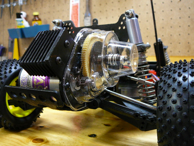

The XX front carrier hing pin holes need to be drilled out to 1/8 inch. The XXX hubs need to be drilled too, the XXX king pins need to be used being that the carriers are a little taller, and you want to use the carriers on the opposite sides thet are ment to be on. Such as use the left XXX carrier on the right side of the Pro. You need to do this because the ball studs point forward on the XXX and backward on the Pro. I found it to be a easy swap even tho I was going at it with no idea that it could work. I am so glad it did
like I said above, buying these carriers is like $5 compared to buying longer vintage arms that are hard to come buy.
I just installed Mr Lexans, Lexan gear cover. I will post a pic of that soon.

I have never been a big fan of Lexan gear covers but I must say, I am impressed with the quality on this one. Good job Mr Lexan and thank you !

Sorry fir the long delay, I just arrived home tonight (had to do some over time at work). Looks like you have a good suplier of Velcro! It is in fact the Velcro brand, the one I get is the industrial streght, and like you said it's almost impossible to get appart and the adheasive side is also very good for our application. I will post some pics soon, either later tonight or some time tomorrow so you can see exactly how I did it. I also baught a lexan gear cover from Mr. Lexan off eBay, just waiting to get mine, looks good.

I can't say I have ever seen that steering set up before. Also by Anthony's post (Dr. Losi), I assume he hasn't either. Very cool indeed.
