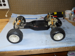

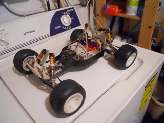

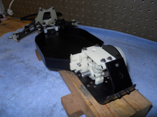

Craigslist RC10T - a few pics
Post by sneako43 »
Here are some small pics of the RC10T. I have just begun putting it back together.

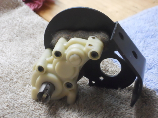

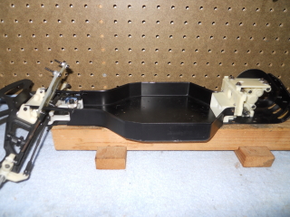

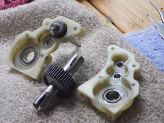

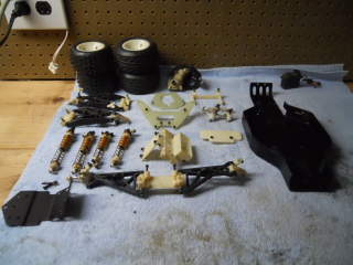

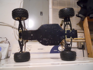

The bearings arrived and I have found some time to get back to the rebuild. Here are some photos of the work I did today.

I noticed that the rear bulkhead pictured in the manual and the rear bulk head I have are two different sizes. The one shown in the manual has many more mounting holes and is much wider. Is the one I have wrong, or is it from a early 10T kit? If it is incorrect, what problems will this cause?
SC10 -- FT B4.1

its been trimmed. the outer holes were not used on your truck so it will not hurt anything. racers bitd would cut and trim everything to shave off those heavy grams of weight.

that's actually a "worlds" tower. the 3rd design. your 10t is a mid/late version with the black arms, and that was the bulkhead in production at the time.

scr8p wrote:that's actually a "worlds" tower. the 3rd design. your 10t is a mid/late version with the black arms, and that was the bulkhead in production at the time.
i stand corrected. i never knew that they made them like that at any point.
Posts: 16810
Re: Craiglist RC10T ... bringing back to life
ya, the first one had the long wing tube holes with 9 camber locations on both sides. second was the same thing, except they used a shorter wing tube and added a new ball stud location underneath. the battery box was also notched to allow the rear arm mounts to be moved forward. the 3rd design looks like the one above (came in white and black).
