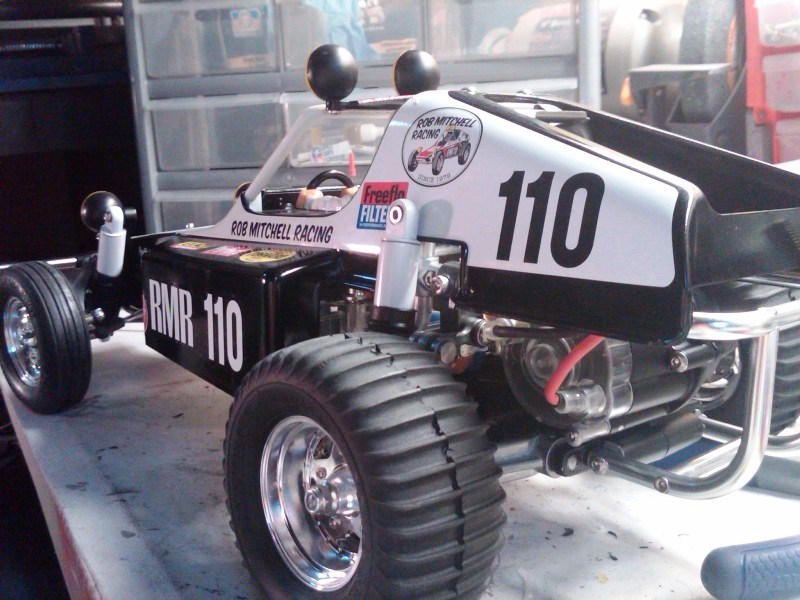

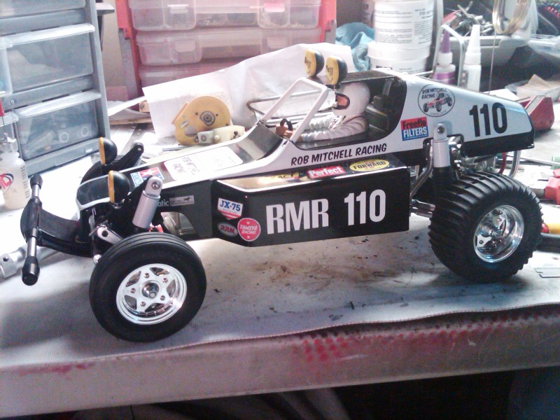

well got the RCChannel Kit yesterday (i love EMS mail), mounted it up, no real problems... I had to take about a 1/3" off the slipper to clear the Arm mount (cut spring, nut and threads), but slipper still works great short and has perfect clearance..
Just a bit about the RCChannel stuff, his quality is amazing.. Everything on this kit fits to within a millimeter when all mounted, its beautiful, he put a ton of work in to it... Its not the strongest of metal that the parts are made with, BUT its the same if not better as tamiya stuff. Its WELL Worth the money... i got his hotshot kit a while ago too, amazing kit also... I feel like i should buy 5 of these kits and stash them away for 5 years in case he stops making them, they should go up in value.
Chrome Plated Plastic wheels came in from the Czech Republic, Amazing quality also, i tryed scratching some of the plating off on the excess mold peices that the wheels come on, and i have a REALLY hard time scratching that chrome off, its on really well, im impressed by the vacuum metallizing done to it. Went with the scorcher tires too so i can run it on the beach, and i always like paddles
All thats left is i make myself a "gear cover cap" to protect the excess slipper and also to mount the rear shocks (going to drill a hole in body, and either Tap a hole in the roll bar above the normal location, OR weld a small aluminum bar thats tapped to screw in... gotta see how it will look later tonight
The Kit is actually completely ready to run at this point... Motor is kinda slow, i used a Tamiya RS540 Sport Tuned Motor , but it works and is fast enough for now...

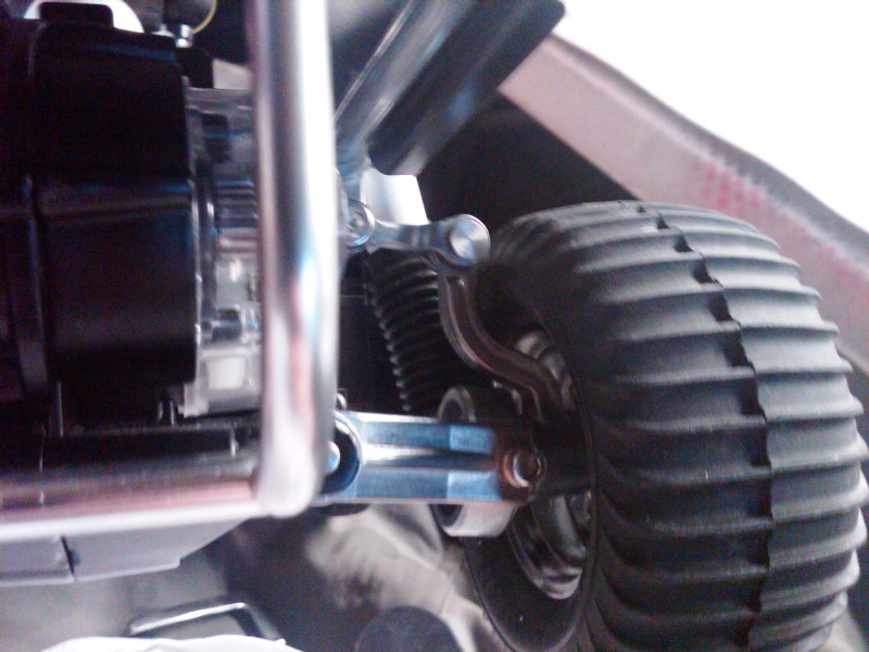

Anyone ever try any different steering options? the stock steering has SUCH slop in it.. i was going to maybe take out the ring and glue it all in 1 peice and use a kimbrough servo saver.. or try a different arm all together or something.. the wheels once turned dont seem to like to go straight again lol

mikedealer wrote:Anyone ever try any different steering options? the stock steering has SUCH slop in it..
The superchamp servo saver is much better than the RR/SS one.

well i got one of these
http://cgi.ebay.com/ws/eBayISAPI.dll?ViewItem&item=360240785330&ssPageName=STRK:MEWAX:IT
and one of these
http://cgi.ebay.com/ws/eBayISAPI.dll?ViewItem&item=250631599630&ssPageName=STRK:MEWAX:IT
hopefully thats everything needed. will have to make a new rod to come out of radio box, but maybe the arm will flip? probably better off with new rod anyway lol.. that things a mess

you got what you need and the arm will flip. I recomend some dubro ball ends and 4/40 rod.
