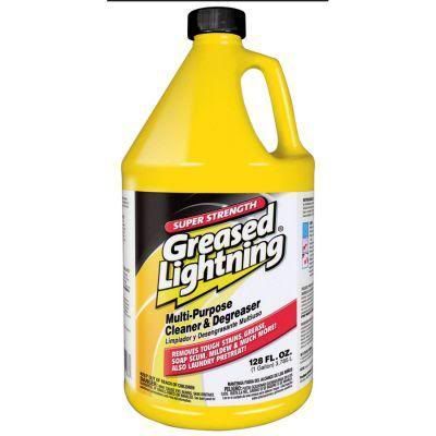

How did you strip this one coastie? I just picked up another pan for my 10T and may strip the beat one and build a cool runner.
ASSOCIATED OR NOTHING!!
- Toasted Coastie
- Posts: 662
- Joined: Sun Apr 11, 2010 9:22 pm
- Location: Nashua, NH
Re: TC's pure RC10 CE Restoration (9/22 w/pics)
I used Greased Lightning in a painter's bucket. Go to Home Depot or any other hardware store and get the yellow bottle:
Get a tray or bucket that is shaped the right size for the pan to be totally submersed in the Greased Lightning. Put the pan in the Greased Lightning for 15 minutes. The liquid will bubble around and on the pan (kind of cool actually). After 15 minutes, remove the pan and scrub with a course green pad. 3M makes a few different "grits" of these. I bought a set of really course ones, as well as a set of medium ones.
What I did was scrub the pan over a 5 gallon bucket of fresh water, dipping it occasionally as I scrubbed into the fresh water. Repeat as many times as necessary.
You have to do it all as the Greased Lighting is still fresh. I found that it can not be re-used the next day for the same task.
I also found an item we used to use on the boat's aluminum in the Coast Guard works great on small parts. I can't remember the name of it, but this is somewhat the same thing:
http://www.auroramarine.com/aurora/catalog/01240/
The stuff I used was brush on., then rinse off. I brushed on, continuing to brush it on every 10 minutes, then scrubbed with medium course green pad while dipping in the water.
