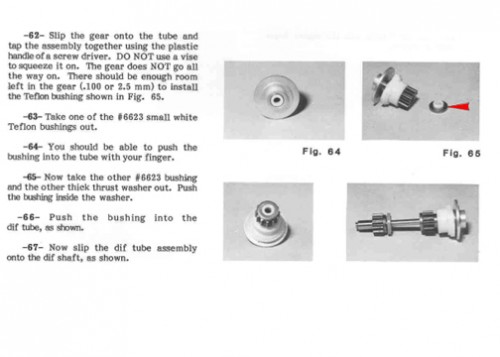

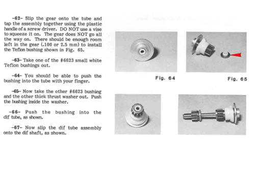

Re: Upgrades for a pure stock '86 RC10
You shouldn't really have any diff shaft play either left/right down/up. Check the manual and compare with what you have inside the transmission.
-Kevin
It is exactly as the manual shows, pulled it apart 3 times and its is exactly as the manual shows. I might be able to put a washer on the opposite end of the diff shaft to take care of the play.teman wrote:You shouldn't really have any diff shaft play either left/right down/up. Check the manual and compare with what you have inside the transmission.
- teman
- Posts: 894
- Joined: Sun May 01, 2011 5:57 pm
- Location: Upstate NY
- Been thanked: 6 times
Do you have the 6623 washer on the white bushing? I can't think of anything else would cause excessive shaft play thereCTYankee wrote:teman wrote: It is exactly as the manual shows, pulled it apart 3 times and its is exactly as the manual shows. I might be able to put a washer on the opposite end of the diff shaft to take care of the play.
-Kevin
-Kevin
Yes, got it all in there. I'll open it up again and if I still have trouble post photos. I have bearings on the way, but the idler gears are backordered at the usual on line stores...checking into a few of the more obscure places. Ebay is also an option.teman wrote:Do you have the 6623 washer on the white bushing? I can't think of anything else would cause excessive shaft play thereCTYankee wrote:teman wrote: It is exactly as the manual shows, pulled it apart 3 times and its is exactly as the manual shows. I might be able to put a washer on the opposite end of the diff shaft to take care of the play.![]()
-Kevin
