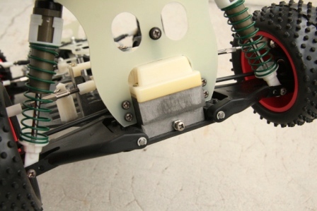

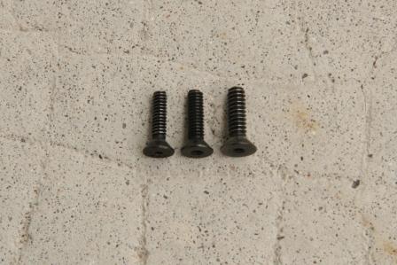

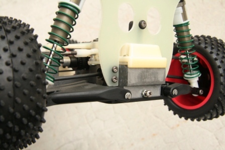

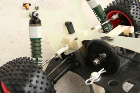

Becarfull with the screws fitting the front and rear arms mount .
That's a really original dimension.
Not a 8-32 or 4mm, not a 4-40 or a 5-40 .
It's something different around 3.5mm ???
Never seen it before, and not after.
Reggy, if you need pics of WCS details, feel free to ask, I'm not a monster ...

Re: My first Yokomo - YZ-10, i.d verification please

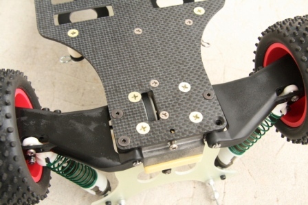

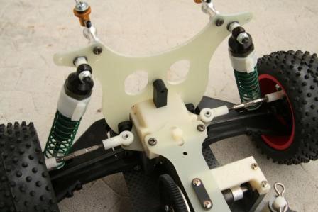

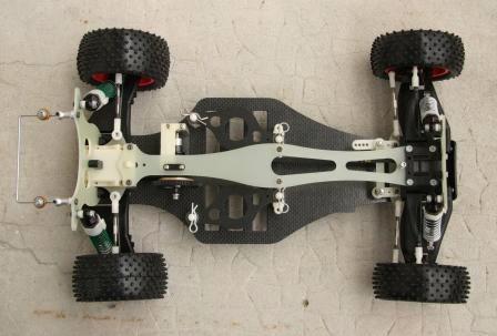

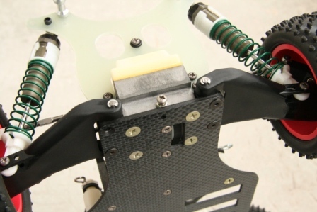

In the order 4/40 , 5/40 and the WCS screws !
Some pics of my WCS
Please advise if you need anything else .
Some pics of my WCS

Kenooze.... that is just lovely, great inspiration! Was it a restoration project or a new build? Also thanks for the screw & under-chassis shot I think that clarifys whats happened on mine.

It seems the 'strange' size screws that occur on the wishbone pivot blocks (front & rear) have been replaced with these M4 socket heads at the back & Ali AE 8/32 screws at the front. Strangely it seems a couple of the old original screws (they measure about 3.5mm) have been threaded into the lower front diff housing. It would be nice to replace all these plastic bulkhead parts & reinstate the original spec screws.

(Note; the black screws in the lower trans mouldings nearest the camera I think are your mistery screws that are mean't to be in the wishbone mountings)

About the front and rear inner arm mount, you will only get the YZ10 style, the one fitting 8-32 and not this strange 3.5mm.
