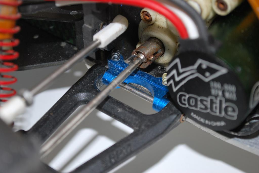

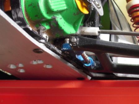

here is a look at the set i have on my rc10 composite craft chassis, and later put on a tub chassis. I'm not home, or I would take photos :|

vintage AE wrote:here is a look at the set i have on my rc10 composite craft chassis, and later put on a tub chassis. I'm not home, or I would take photos :|
are those zero degree? reason i ask is because you have them on backwards. if they're zero's, it really doesn't matter. but what it does, the way you have them, it throws the rear arms about an 1/8" further back then a "correct" mount in it's long wheelbase position.
all i'm trying to say is that no matter how you mount them on the chassis......... which still boggles my mind since i've never seen "both" holes on a gt mount line up to a rc10/10t chassis, it's either too far front or too far back.
vintage AE
Posts: 3012
Has thanked: 29 times
Been thanked: 36 times
Re: RC10T Bulkhead
Post by vintage AE »
now that I think about it there is an issue with the holes. It's hard for me to get a visual because it's not in front of me. When I took them off that buggy and onto the other one I seem to remember that the alignment of the hole were slightly off and I split the difference when I tightened each screw :lol: . Maybe I should ditch those mounts and go back to the plastic ones. Sorry, for the misleading info. The Atlas ones line up with no issues, I just checked.
That could explain this photo
