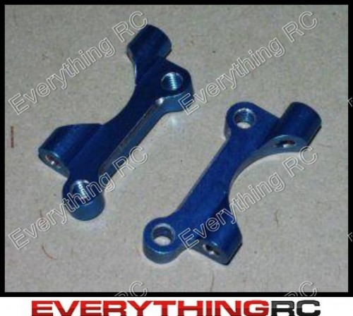

Thanks for the information. I will have to buy them to find out. lol It's only money, what the hell.
- Posts: 748
- Joined: Wed Aug 26, 2009 3:43 pm
- Location: Syracuse, NY
Re: RC10T Bulkhead
Those are GT mounts, correct? If so then they won't have anti-squat. Somebody makes some gold aluminum mounts for the electric cars, I'm sure somebody on here has the link.
You should be able to tell if the mount has anti-squat from looking at it. The 'barrel' the pin slides through will slant downward towards the rear, so it will actually be above the the flat part of the mount in front and hang below the chassis in the rear.
