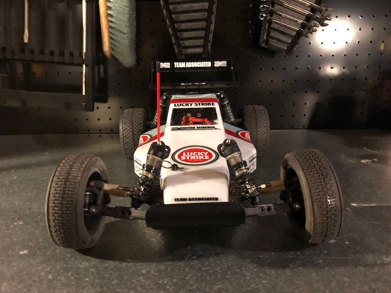

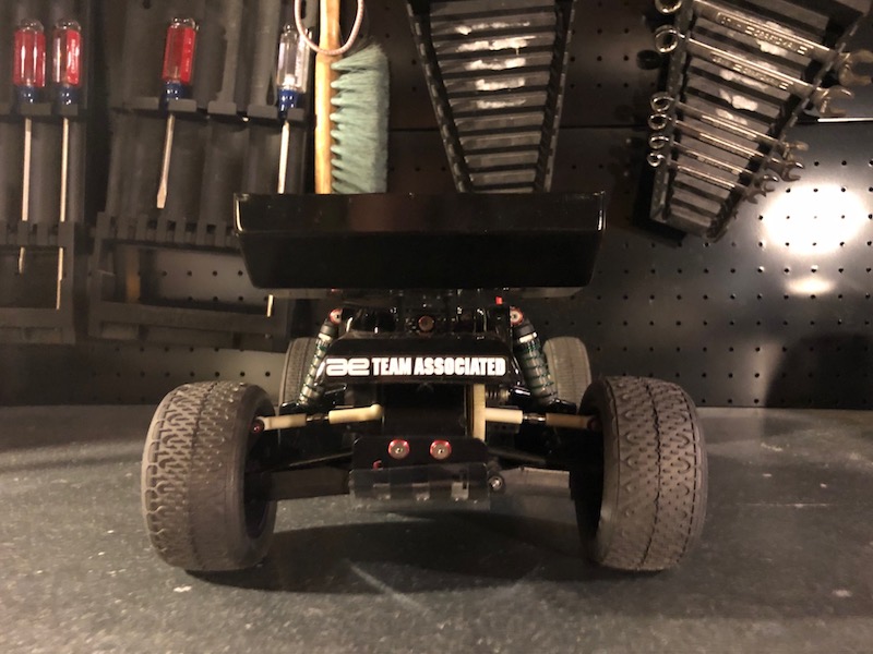

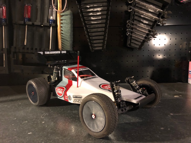

Resurrecting another old project thread as I have been wrapping up some long-dormant projects, I've finally gotten my graphite buggy pretty much done. I might try to track down a Protech II for it, as I'd like it to look more original, and have to figure out a motor/electric plan. I was originally going to run it on the local indoor dirt track, but as that closed and the only track nearby is indoor carpet (and based on my driving there with my modern car, I doubt this would survive a day! - the new cars are insanely tough...), I might just put some basic older stuff I have and try to find a place to bash it.
Anyway, I really like the paint scheme, and am pretty psyched how it came out.
