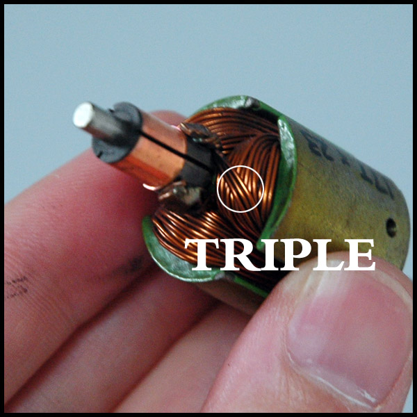

All of the CAM motors looked identical, and had different winds (except the stockers). There is no way to tell just by looking at them, similar to a Twister. Mine is a 10 x 2, which is a ridiculously hot wind for that era. It was probably a paved or dirt oval motor for that time.
You can see if it's a single, double, triple, quad or more winding by looking at the naked arm. Count the strands on the comm tabs, and that's your winding. Generally, too, you can guess at the turns by the gauge of wire used and the amount on the individual pole. Lower wind motors usually had thicker gauge wire with obviously less actual wraps around each pole. I could make a guess by looking at it, but unfortunately, the only real way to know what it is would be to cut the winds off and count them—and I doubt you're about to do that anytime soon.
Some motor builders/gurus, could probably give you a more accurate guess than I, and even be able to test the current and draw through the wires to give you a better idea, but unless you know one of those 7 or 8 guys in the country, you're again out of luck. If you're lucky, the motor winder may have wrote or etched the turns on the arm. Some did, most didn't.
Be careful with that T4, a potentially hot modified, and the more contemporary 3300 cells. The voltage on those is considerably higher than the 1200s and 1400s that ESC was designed for. Those speedos were entry-level compared to the T1 and T1x and weren't meant for super hot winds or higher voltage batteries. Blowing that up today would be terminal, as Novak does not support those old speed controllers anymore.

Hope these help identify the windings and the wind counts... i had these sitting here, and I figured it couldn't hurt to show you a wind.

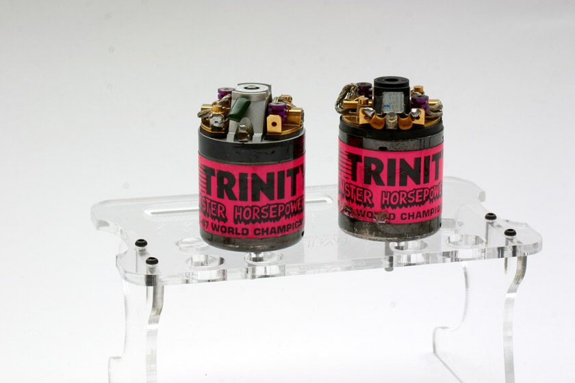

Hi guys,
sorry to dig this one out. Here's a pic of two Trinity Monster Horsepower motors I acquired a bit earlier this year here in Germany. From looking at the brushes (they are cutted) they seem to be onroad windings. I haven't opened them yet and the seller wasn't sure about it ...
Cheers
Seb
