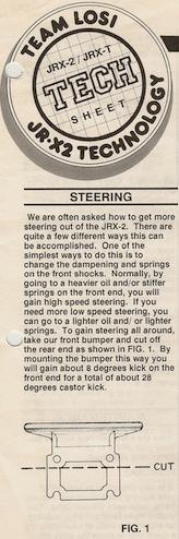

The lower chassis shape looks to be from Jrx2 with curves close to steering servo. Is the front kickup 20-degrees with bumper modification that adds about 8-degrees more or is it 30-degrees in the chassis?
Bumber mod.jpg (23.38 KiB) Viewed 616 times
The rear shock tower seems to be Jrx2 part with only one top mounting hole option. If someone have both Jrx2 rear shock tower and proformance kit/JrxPro rear shock tower could send a pic where Jrx2 shock tower placed on top of JrxPro shock tower so that four mounting holes to rear bulkhead are placed in line. It would be nice to see where the Jrx2 only shock mounting hole would be compared to JrxPro nine different holes.
