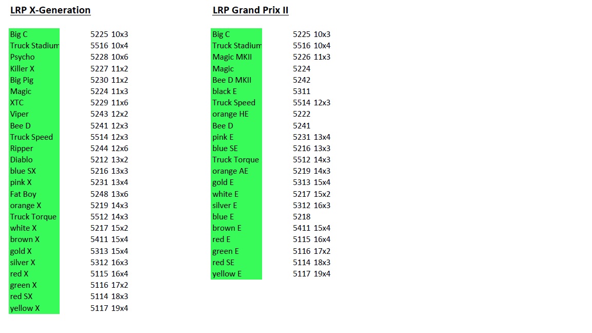

Does anyone know what the 'Black Bee D' wind was please? And the one marked 'Magic' and if single, double, triple, quad ? Thanks

....also the
'Black E'
and
'Blue E'
please any info on what winds and multiplier? Thanks.

From here You can see something:
Since motors are listed about from "hottest" to "mildest" Black E is about 12-turn, Blue E about 15-16 turn and Bee D 12x3 IIRC. is the motor single, double, triple or quad can be seen if You open the endbell and look winding that goes around communicator "tab", if it is quint or hex it might be hard to impossible to estimate that.
