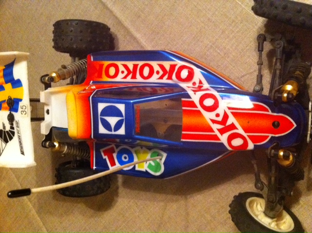

I actually drove mine back in -97 in swedish championship
It had lazer suspension and associated gold shocks since those where shocks i had laying around
Tekin 410K and an LRP DTM something the wind was 18D i just had the stock pinion so with the 2.2´s and fuzzies on all four corners it was really fast on the straight.
Oh forgott it had yellow 5 spokes and an matching flourecent yellow plastic wing.
Think i have an picture some where
mvh Isobarik

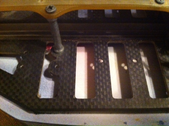

The chassis in the original post looks to be Optima Mid Custom Special (with the aero body). The chassis on the Turbo Optima Mid Special has Carbon Fiber pattern.
- murphy3428
- Posts: 579
- Joined: Mon Oct 06, 2008 11:19 am
Re: Kyosho Turbo Optima Mid Special ? Build
Yes the complete kit car does have the pattern but the conversion kit doesn't and mine was a sealed kit thats what makes me think the conversion may have come first then kyosho improved the chassis when it went into complete kit form or maybe they decided the cf wasn't cost effective to sell with the conversion kit thats why they went back to the aluminum chassis with the optima mid customBimdapogs wrote:The chassis in the original post looks to be Optima Mid Custom Special (with the aero body). The chassis on the Turbo Optima Mid Special has Carbon Fiber pattern.

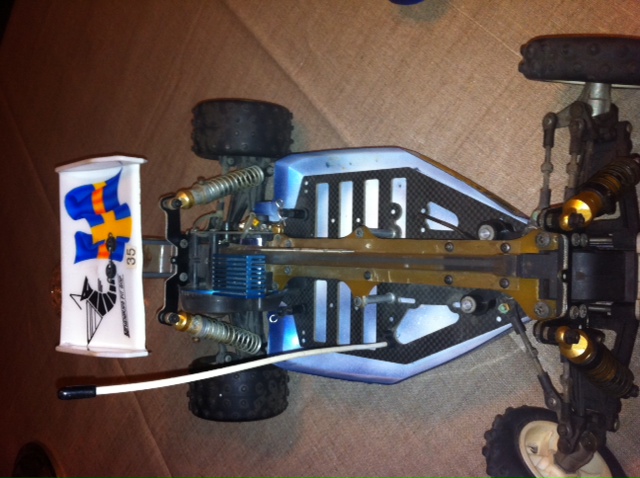

murphy3428 wrote: Yes the complete kit car does have the pattern but the conversion kit doesn't and mine was a sealed kit thats what makes me think the conversion may have come first then kyosho improved the chassis when it went into complete kit form or maybe they decided the cf wasn't cost effective to sell with the conversion kit thats why they went back to the aluminum chassis with the optima mid custom
You are right, the convention kit came first. I got mine from Kyosho long before I went to Australia for the WC. And I still have that car as I raced it Australia.

What is the chassis material on yours does it have a pattern in it? or do you have any picsHcp22 wrote:murphy3428 wrote: Yes the complete kit car does have the pattern but the conversion kit doesn't and mine was a sealed kit thats what makes me think the conversion may have come first then kyosho improved the chassis when it went into complete kit form or maybe they decided the cf wasn't cost effective to sell with the conversion kit thats why they went back to the aluminum chassis with the optima mid custom

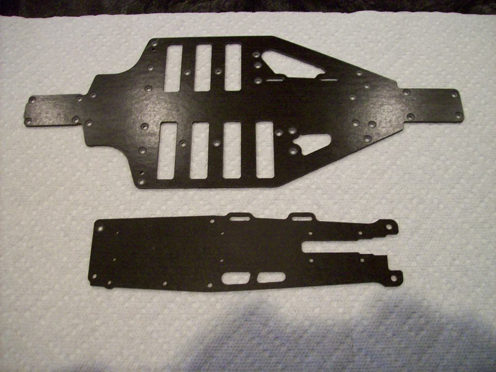

Lars was this chassis from the conversion kit or the full kit? Because mine is different the kit pcs in my nib conversion kit is a much finer weave maybe kyosho ran out of cf

It’s from a convention kit from the first load that came to Sweden, and I have to check if its carbon strait though when I get home. Kyosho did lot of carbon/glass fiber sandwich and black glass fiber parts. Carbon fiber was rather expensive at that time…

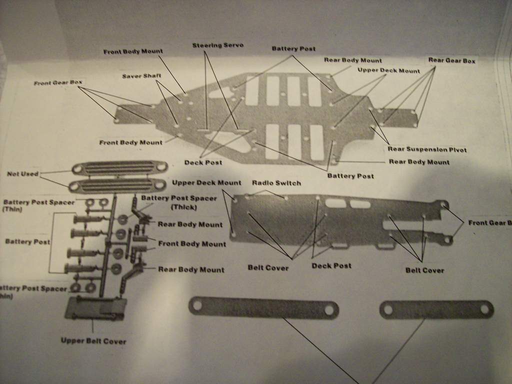

Well I think I figured out why nvxwax and my chassis are different than the other chassis look at the top left corner of my kit box mine and nvxwax are re engineered for 7 cell set up I never even noticed that until now I wonder if any of the full kits are for sevin cell.
- nvxwax
- Posts: 1071
- Joined: Tue May 25, 2010 8:28 pm
- Location: Front Royal, VA (AKA: Helltown)

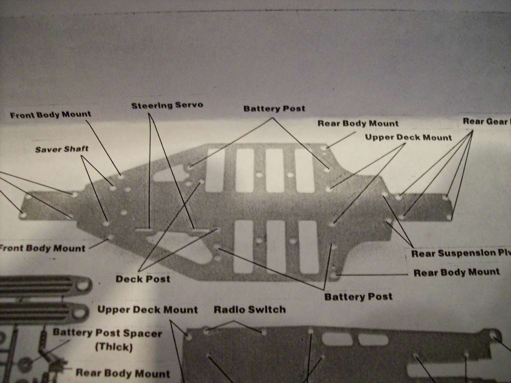

Nice catch, I think you are correct, I noticed during the build of my chassis it only had one location that i found for the upper deck support. The other one normally sits partially in a battery slot.murphy3428 wrote:Well I think I figured out why nvxwax and my chassis are different than the other chassis look at the top left corner of my kit box mine and nvxwax are re engineered for 7 cell set up I never even noticed that until now I wonder if any of the full kits are for sevin cell.
This opens another question lol, I will have to find a diagram to see if the second post is left off, moved ore is the upper deck redesigned.
The Orange chassis is alloy

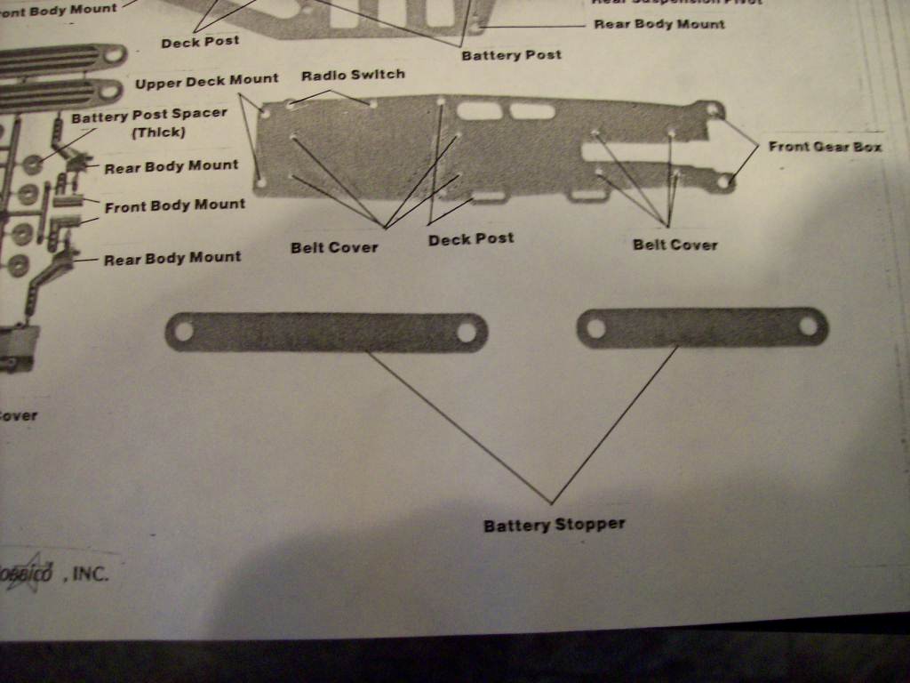

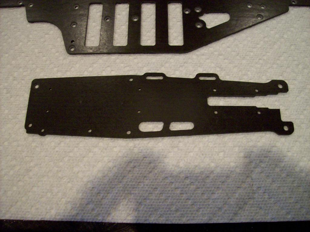

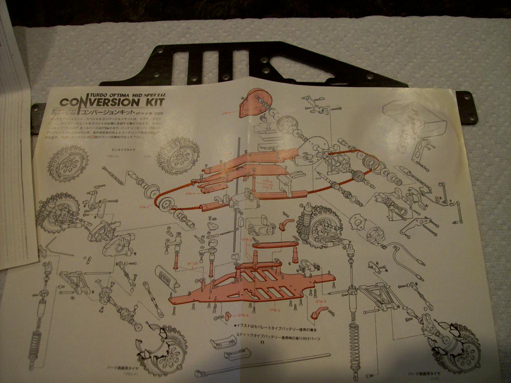

Here is some more pics of my chassis and top plate also the directions that came with the kit including the 7 cell build sheet
