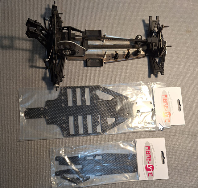

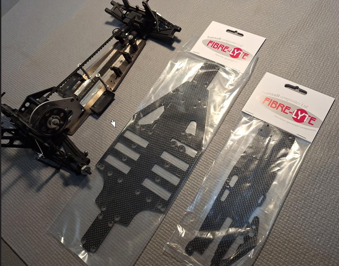

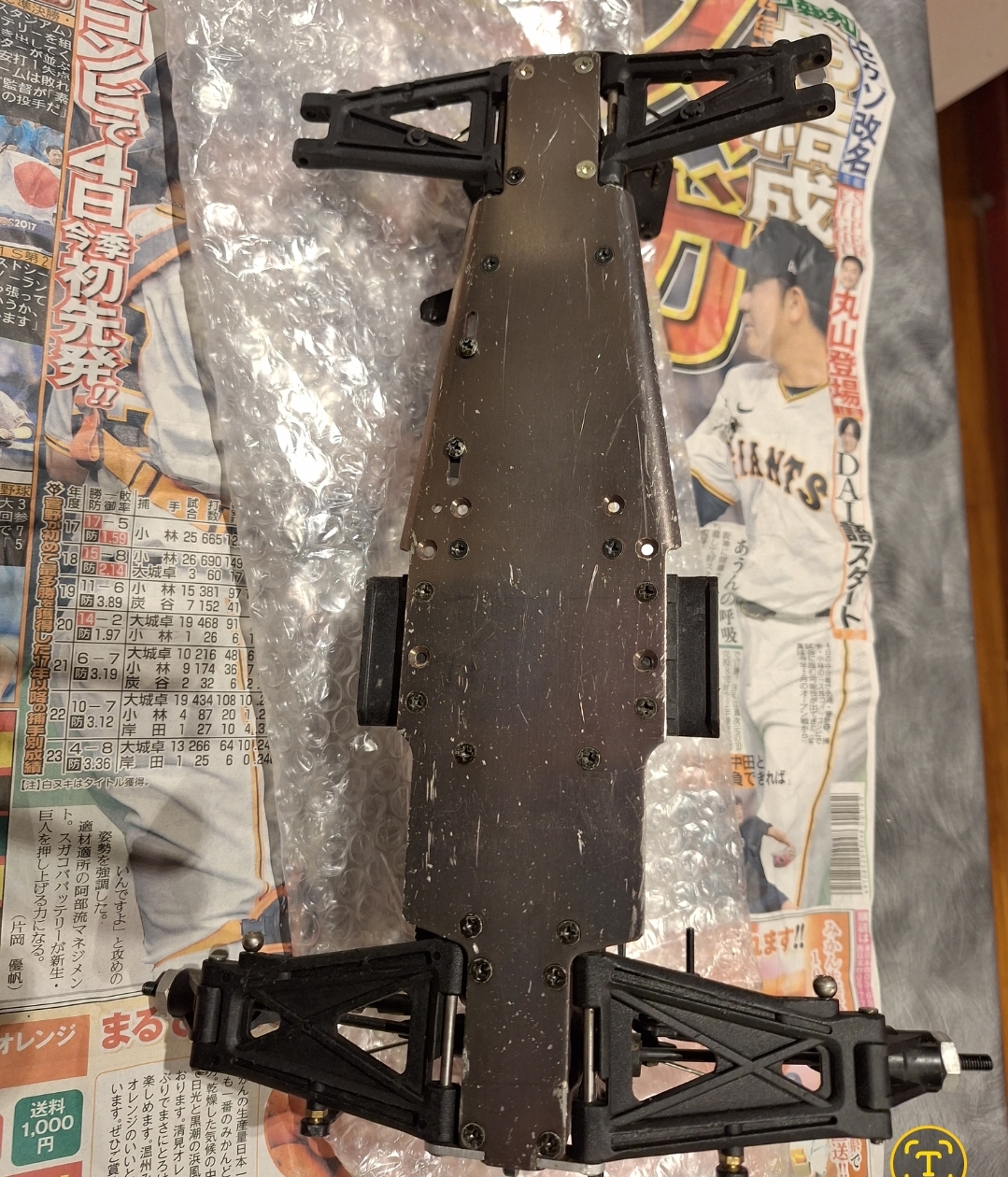

I appreciate some people would rather restore the turbo mid SWB, but i had one , and it was a bit of a dog compared with the LWB, and it doesnt owe me much so..
Saying that, i bit the bullet and ordered the OT replica chassis and top deck from Fibrelyte, new belt from Tough Racing and shell/belt covers and spur cover from TBG.
I was waiting for a LWB Rerelease chassis from Kyosho, im sure its pending, but the rere is a different length to the original, and then id be committed to new belts, which in turn would determine pulleys, then that would mean gearbox.... you get the idea.
I looked for original stuff, but just silly money 2 or 3 time the EXO Design chassis.

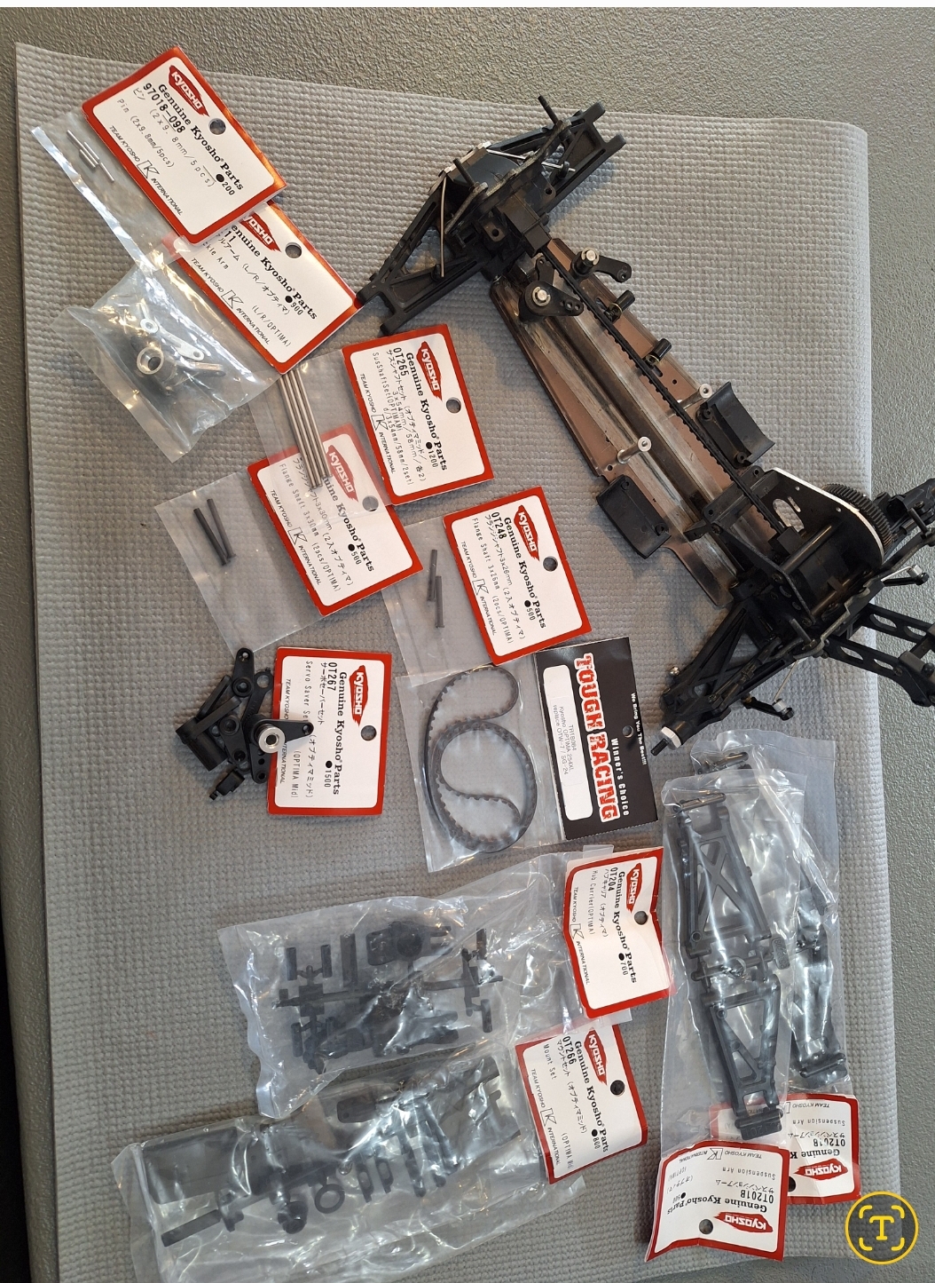

Occasionally on Auction sites you put an opening bid on stuff and are pleasantly surprised when it wins.
This was the case with a bunch of rere Optima and Mid new Kyosho parts.
Paid less than $20 for about 15 packets of bits that were poorly categorized in the auction.
And double that again in postage and local import taxes.
So the mid will be getting as many bits as possible from this pile that I can.
Suspension arms, rear hub carriers (they are quite different) alloy steering knuckles, hinge pins and few other odd ball parts.
And i dug out the XL belt for the LWB from Tough racing, and the optima CVD's.

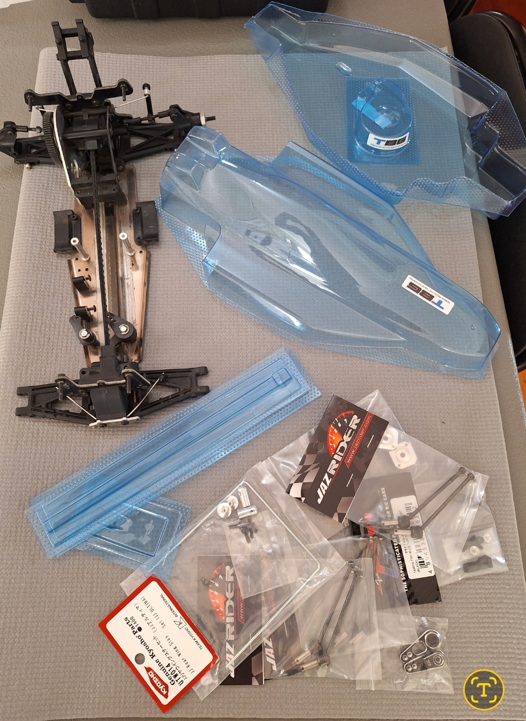

Also found the Custom special bodyshell, undertray and belt covers, also found a TOMS shell / wing too
The toms is a nicer looking shell i think, but there's a few of those around already.
may change the wing mounts to the Ultima JJ parts, see how it pans out.

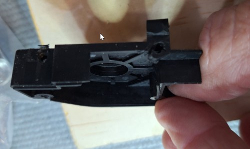

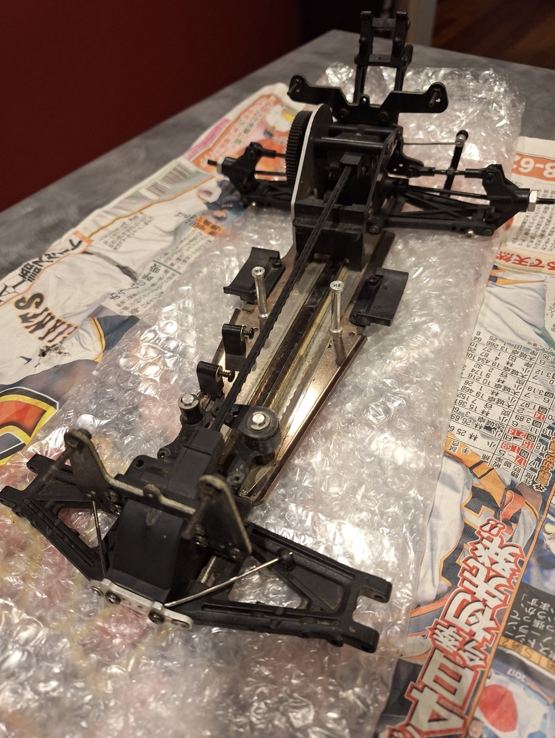

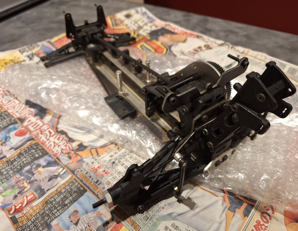

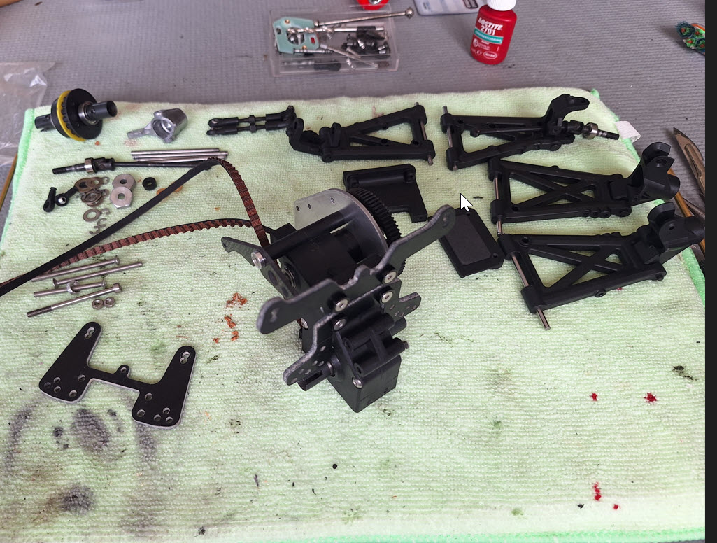

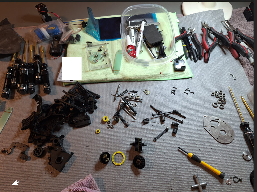

Started the strip down, bearings were mostly stuffed, not surprising for a 1986 car, Screws were a mix of stripped kyosho, tamiya and woden slot heat wood screws.
Nice,

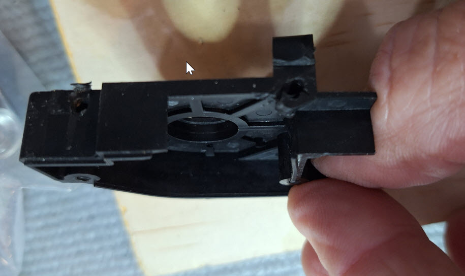

Found the screws on the front gearbox were mostly gone, repaired with epoxy and tapped to M3. Wasn't sure if the front gearbox was the same as the rere, appreciate the rear id different due to the belt tensioner.
Bit of a score though, the partial chassis i bought had universal driveshafts in the rear, unusual, so these will obviously ride up front, and i have a set of normal rere dog bones on order for the back
Nice,

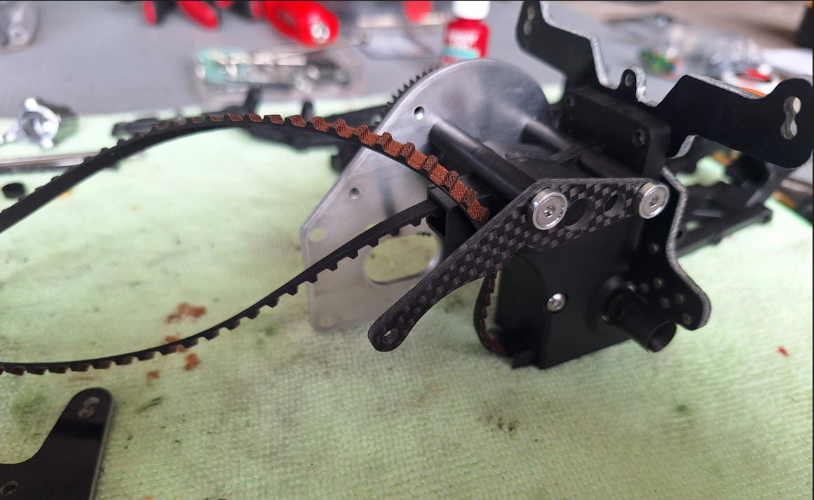

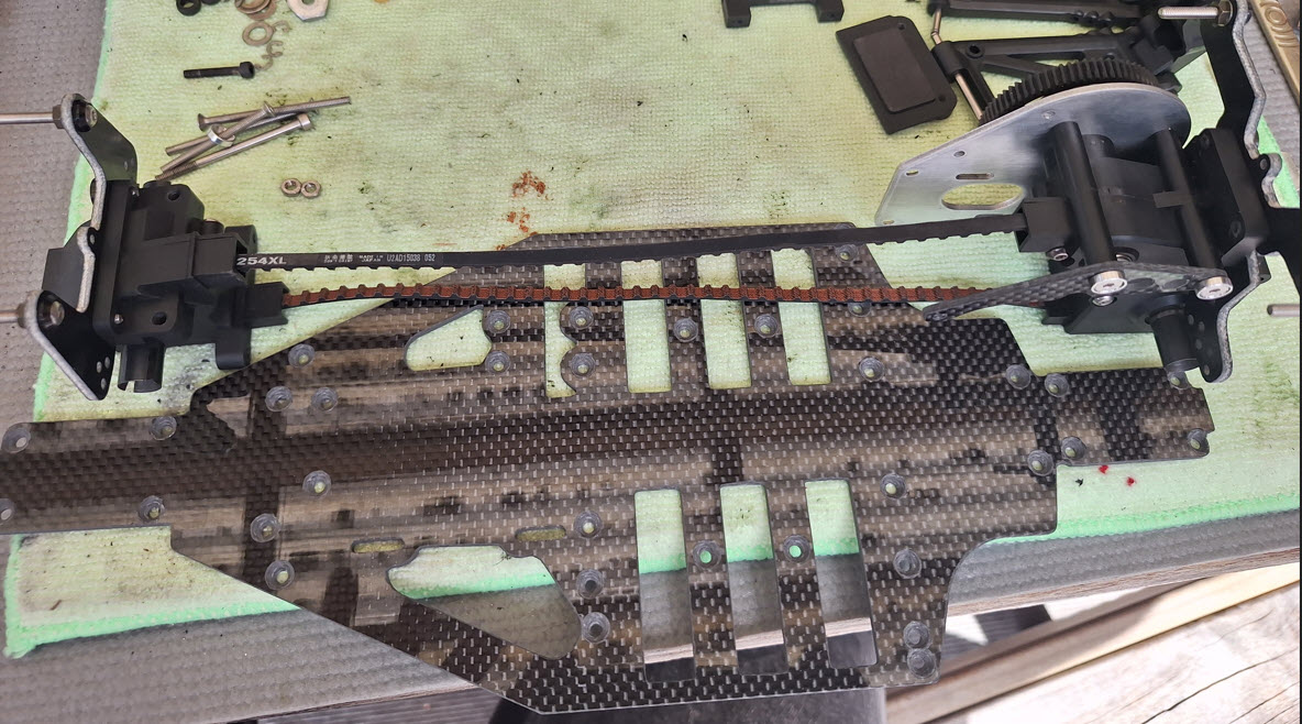

After polishing and cleaning the fun bits.
Rebuilt the gear differentials, added new bearings and shims as i went.
The belt was from tough racing, and the chassis/ radio plate/ gearbox brace from Fibrelyte.
Kept on expecting the inevitable lwb rere, and it associated replacement chassis, but bit the bullet and ordered one.
LWB re-release will Probably be announced? Released in the morning .

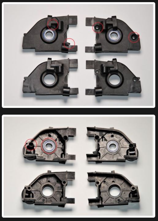

It isn't, the rerelease uses different size bearings on the diffs. In theory you can use rerelease the front gearbox case, but you will have to get a pair of 8x15x4 bearings to replace the 8x14x4 bearings in the original.

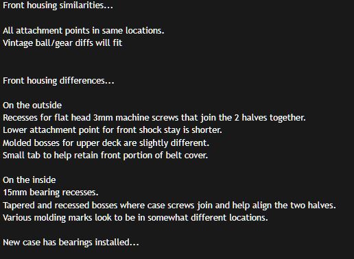

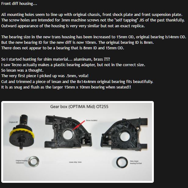

First off nice build. And I do really like the Custom special's look, the upgrade graphite chassis is really nice and no platinum shocks.
You may be too far along or are satisfied with your repair but...
When I built my front diff on my TOMSE I did use a new front housing. I could not find a bearing sized 8x15x4mm.
My front housing was much like yours, stripped threaded holes. I had tried C/A glue, epoxy and threaded inserts, didn't really like those options.
This kind of breaks down the difference in the housings and my approach.
Chuck
Chuck

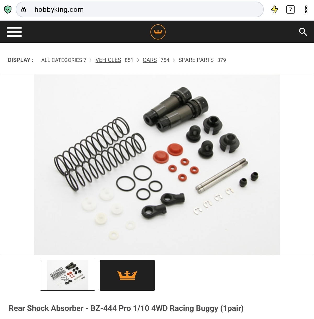

I realized I'd have to find some shocks, and I have a few sets of original golds, but they are showing their vintage.
I grabbed a few sets of these associated copy shocks from hobby king when they discontinued their BZ‐444 cars.
Quite nice, alloy bodies, headed collars etc.
I purchased some rere gold rears and rethreaded them to 3/4 length for my Triumph project, but got quite pricey. And you need to fill from the bottom.
These were 10% the price on closeout, so reckon that's what I'll try running.
Thanks. Again for the help on the gearboxes.

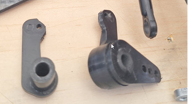

In the bundle of bits i got from that Suprise auction was OT-267 or the ReRe steering for the new mid.
The ones I pulled off were a bit rough, ground away and worn, so I thought" those mid bits will fit straight on"
Nup.
Nup.

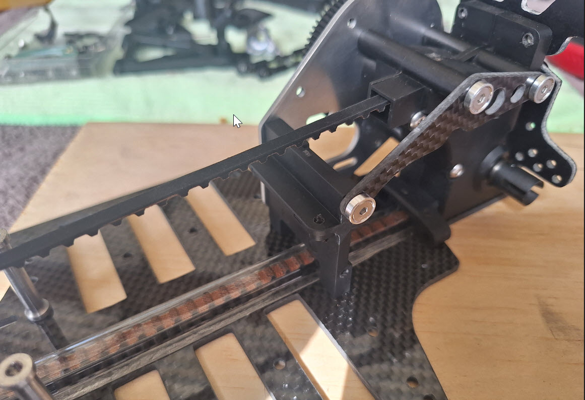

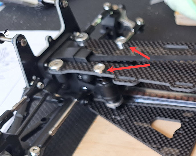

Re: Optima Mid Turbo LWB Custom special Conversion

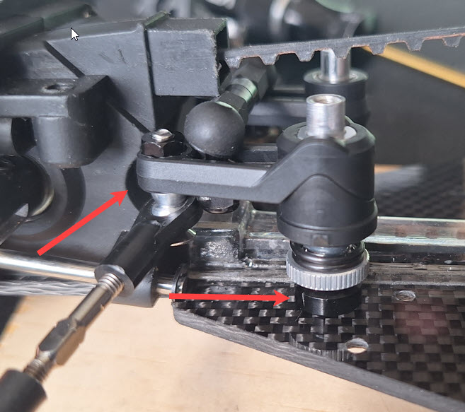

So FYI they dont.
Took a fair bit of mucking around to get the bell cranks at the correct height to clear the recesses in the gearbox so the throw it smooth and linear.
So i inverted the sprung arm, removed 5mm from the height, and then carefully recessed the other arm to the 8mm bearing would sit nicely.
Then i used some 50mm threaded alloy spacer posts and drilled out some M4 Cup washers to M5. Which somehow were the perfect height for the throw. (4.5mm i think?)
Couple of shimming washers, and all good.

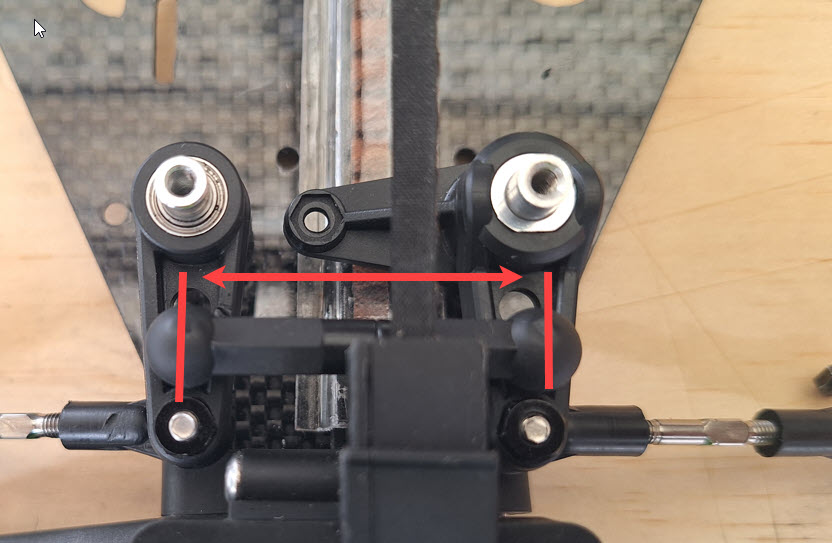

Should of given up and bought some of Jeffs superior factory works ball raced sets by now, but I'm a glutton for punishment so pressed on.

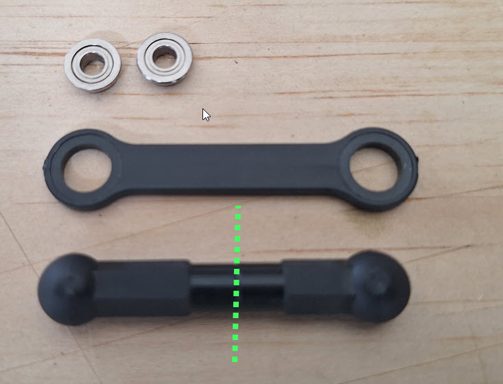

The link between the bell cranks is not correct either.
A bit of careful measuring later turns out that if I used the spare inner holes on the bell cranks, fitted some 4.8mm balls and nylock nuts, then the intermediate length Kyosho ball ends mated up were perfect.
Used a really long M3 Grub screw and threaded them together, shoulder to shoulder.
Initially placed some 0.2mm M3 shims stacked between them to adjust them but ended up removing them to get it correct.

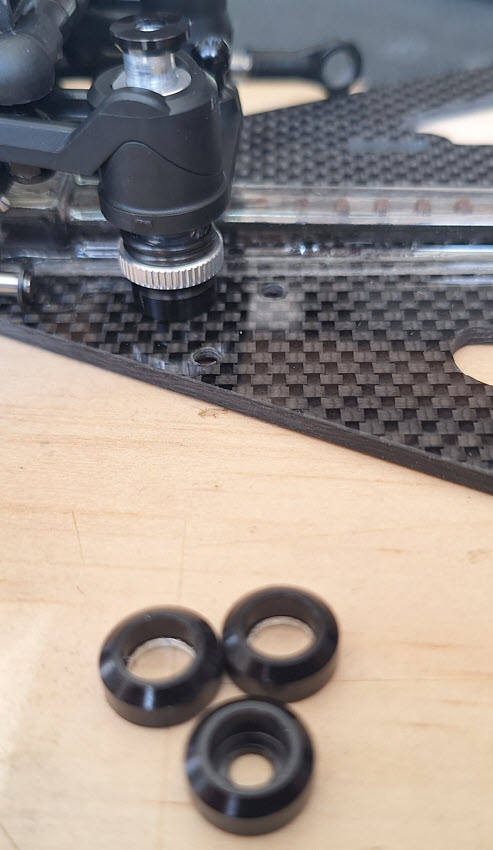

And finally, i copied a very old RC mod from way back and very carefully drilled into that pristine LWB radio plate (cringe) and screwed the posts top and bottom.
Put in some more spacers so the arms cant float up and down.
Turns out very smooth and rigid.
Just waiting impatiently for the rear dog bones to arrive so I can carry on.

Fitted the steering servo tonight, and following on, the radio plate and top belt cover.

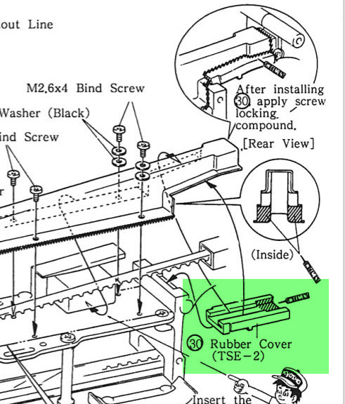

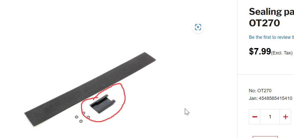

As I was cutting it, I realized I did not have the small rubber cover than covers the bottom of the belt as it transitions up over the motor into the rear gearbox.
This part used to be called TSE-2, and now with the rerelease, there is a OT270 Part number "sealing kit" which includes it.
Obviously as mine is 20mm longer the sealing kits isn't much use to me and all I needed was the rubber bit.
Adding to this I was impatient and couldn't be bothered waiting for delivery i made my own and thought it may be of use to others.
