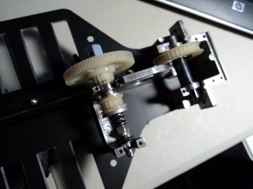

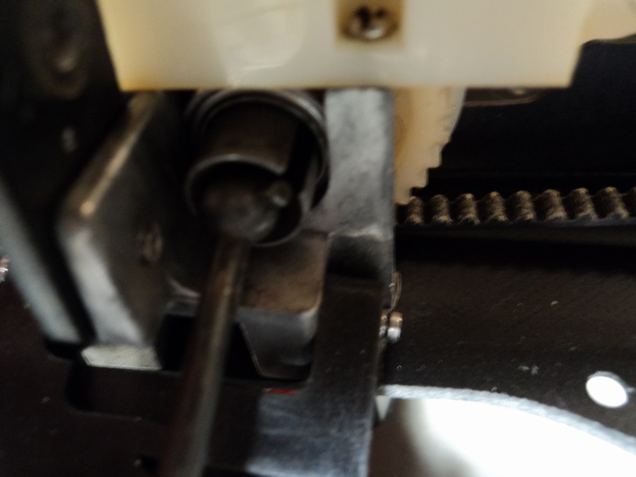

Just a quick update on this build. I got the front and rear diffs all rebuilt as well as the drive assembly. I temporarilly installed the rear bulkhead - new one coming (Thanks Alex!) Next hurdle is finding new drive shafts - I only have three and they are all bent on close inspection. :evil: Other than that I'm getting parts inspected and cleaned. I think this will turn out to be a pretty decent car after all! :D Sorry about the blurry pics - bad lighting...better next time.

I think you've got your front and rear diffs swapped... not a big deal but the belt pulley with the single flange usually goes at the rear.

xxxmain wrote:I think you've got your front and rear diffs swapped... not a big deal but the belt pulley with the single flange usually goes at the rear.
Right you are! Can you tell I've never rebuilt a YZ10 before? :oops:
I will rectify that when my new rear bulkhead arrives. Thanks for the heads up!

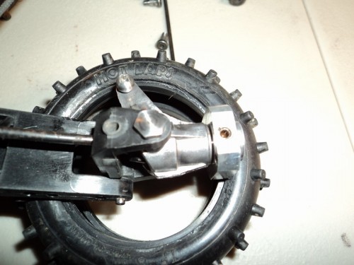

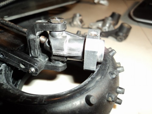

Just a quick update. While I was waiting for my new unis to arrive I discovered that I need a pair of kingpins for the front carriers. While cleaning the carriers however I discovered that the left side had both of the holes for the kingpins stripped out. :cry: Rather than hunt for new ones, delaying the build even further I started scrounging in my parts box and found a pair of Optima carriers that looked like they would work. They do, almost. The main issue is that the Optima part is just a bit deeper between the bearings that the Yok part which causes two problems. 1) The universal doesn't penetrate the carrier quite as much as I'd like which means the flat that the hub set screw is supposed to catch is only about half exposed. It works but could be better. The other issue is of course that the added length of the carrier means the other end of the uni doesn't seat well in the drive cup. I think I can trim the end of the carriers down to the same dimension as the Yok parts and rectify both issues. If it works out, as a bonus I can use the Kyosho kingpins as well. Here is a pic or two of the Kyosho parts mocked up.

I have a couple of mag knuckles lying around if your desperate.

Alex B wrote:I have a couple of mag knuckles lying around if your desperate.
I may take you up on that Alex. I'll see what I can do with the Optima ones first. Thanks for the offer!

In the uk the optima hub carriers were often used as they was alot stronger than the yokomo ones for rough off road use and huge jumps.
Looks like you have standard length drive shafts too in which case the hub should be mounted on the inner hole of the arm and thus placing the drive shaft in the diff, as seen here on 63 http://www.oople.com/rc/manuals/yz870c/imagepages/yz870c018.html.
