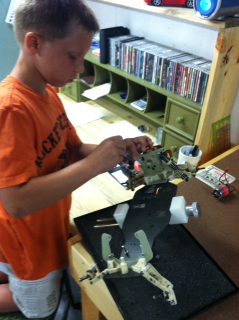

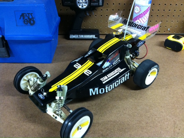

So i'm in the process of resurecting my 1990 RC10 graphite team car that I built when I was 16 and raced weekly for 2-3 years and I need some help. I've spent a good amount of time on this site and I'm trying to get up to speed with all the new tech. I have completely disassembled the car and rebuilt it, including the stealth tranny and shocks, and now i'm ready to put some new goodies into it. Through recommendations on this thread I ordered a gt3b controller, Gens Ace 5000mah 40c LiPo battery and a charger through hobbypartz. Now I need a some help on the motor and ESC. I'm still not sure I understand the ratings of the motors and what my car can handle. Unfortunately there are no tracks in my area so I will probably be using the car mainly on asphalt. My next question is rims and tires. I'd like to upgrade to some new rims but i'm not sure what will fit and what options I have. I'm also interested in some recommendations on tires. Thanks in advance.
