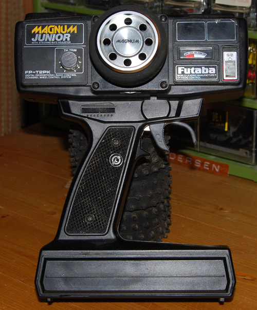

Some of the members on this site have 12 rc10's... some have 12 old wheel radios... some have both... (some have 100's of tamiyas) I do have a sizeable collection of vintage radios from 80's and early 90's, ideally high-end ones... because 25yrs after it feels fantastic to play with toys I couldn't afford when I was a kid. Driving a vintage RC car with a vintage radio is just what turns me on :)
Yes, KO were the first one with the pistol radio, the EX1. Futaba had done a few "wheel" radios before, in a big brown square box. Then before that were the slot-adapted controllers... but the EX1 basically defined the standard that has lasted since then. There was a great thread showing all generations of the EX1 radio but I can't find it anymore :(
Hope you can bring that EX5 back to life!
Paul

Lonestar wrote:Some of the members on this site have 12 rc10's... some have 12 old wheel radios... some have both... (some have 100's of tamiyas) I do have a sizeable collection of vintage radios from 80's and early 90's, ideally high-end ones... because 25yrs after it feels fantastic to play with toys I couldn't afford when I was a kid. Driving a vintage RC car with a vintage radio is just what turns me on :)
Paul
Paul,
Awesome setup, the PCM Magnum and a hydradrive Losi!
BITD if you had the PCM Magnum you were da man!!!!
You are right about driving the old stuff with the old radios and ESC's. Kinda makes you feel younger...
Cool stuff! thanks for posting!

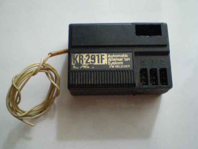

As for compatibility with Futaba, all you must remember is, like Air Tronics, the polarity of the servo connections are reversed. Just switch the sockets in the plug around and a Futaba servo works with a KO receiver. Same when hooking up an ESC
this is true with newer ko stuff the older stuff had a different plug (check out pic). another reason i like newer radios,futaba had connectors reversed back in the day.
