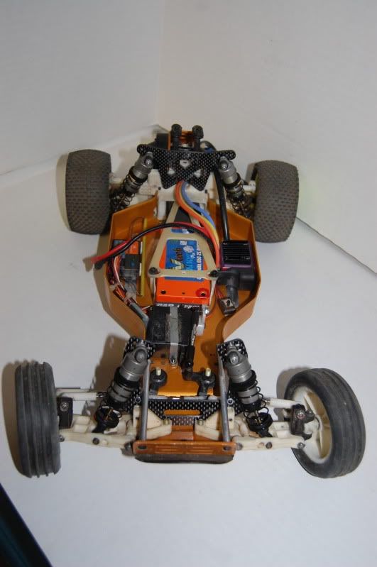

the shock towers I mentioned are for modern shocks, standard or big bore. The front tower is a touch taller, the rear tower is a touch shorter. The rear tower includes holes for B4 or Kyosho wing mounts as well.
Front:
Rear:
With TLR big bores & B4 wing mounts:
Front:
Rear:
--Joey --

Sweet! That makes a little more sense now. I also love the option for wing mounts! Good to know.JK Racing wrote:the shock towers I mentioned are for modern shocks, standard or big bore. The front tower is a touch taller, the rear tower is a touch shorter. The rear tower includes holes for B4 or Kyosho wing mounts as well.
Front:
Rear:

if you're talking about the shock towers, the front one pictured above will not work on your car. you need the narrow "worlds" style tower they offer.mdutcher wrote:Yeah, I did order the ones that you posted in your pics above. I am good to go! Thanks again for that insight!JK Racing wrote:oh heck no, this isnt RCTECH!! wasnt sure you saw that on the header cards is allwe are all here together to get these beasts back on the track and kickin some plastic butt...its all good

Re: My RC10 Worlds Project Runner
yes, if using the truck nose/longer arms, you need this tower:
you can run standard front buggy shocks or truck front shocks:
