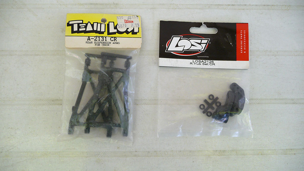

Just received new parts to replace broken ones and Imperial tools this morning, the strip down will begin!
