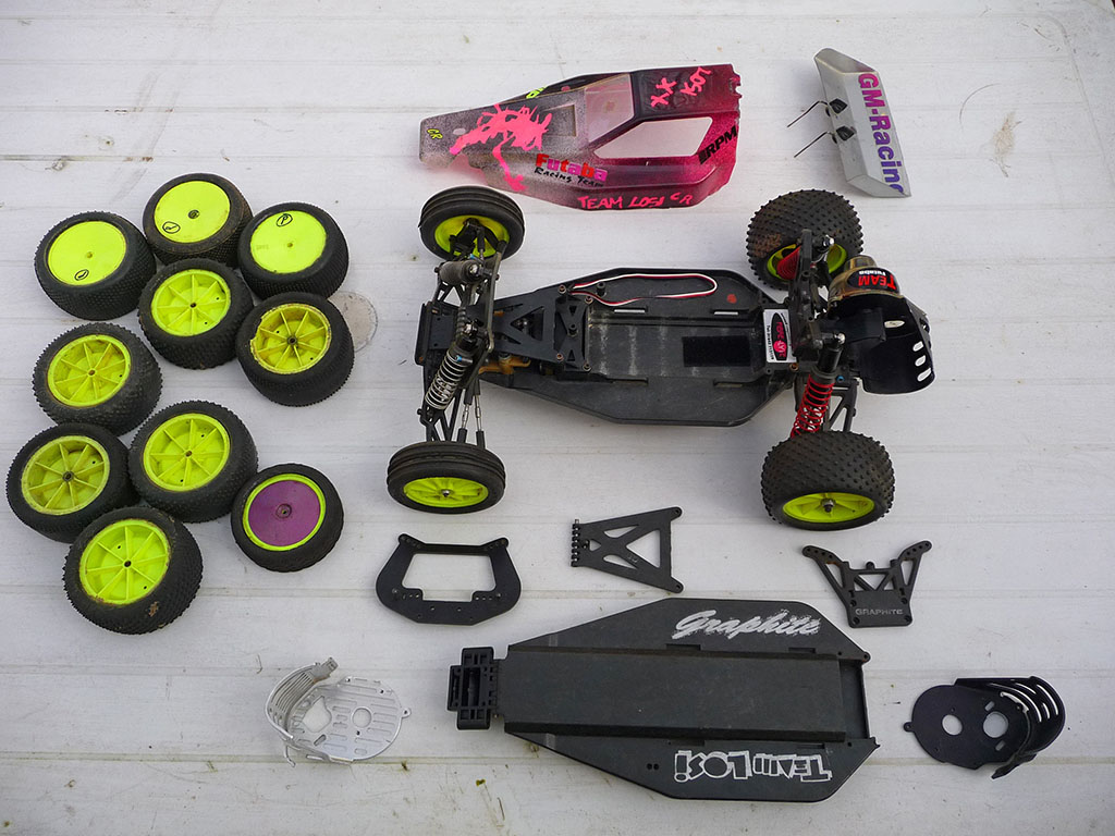

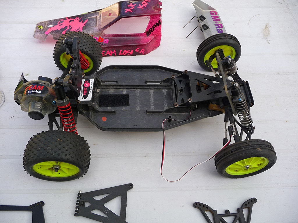

About the buggy now:
Parts tolerances are very good, play is minimal, and tranny is smooth, only left rear hub is damaged after a first rapid check.
He got a S stamped chassis which must stand for short, and the spare one is stamped STD, but one screw hole is damaged so it is unusable
Got it with some spare parts as you can see, and also got RPM front arms and Lunsford turnbuckles on ebay.
I will dismount it completely to clean and check everything.

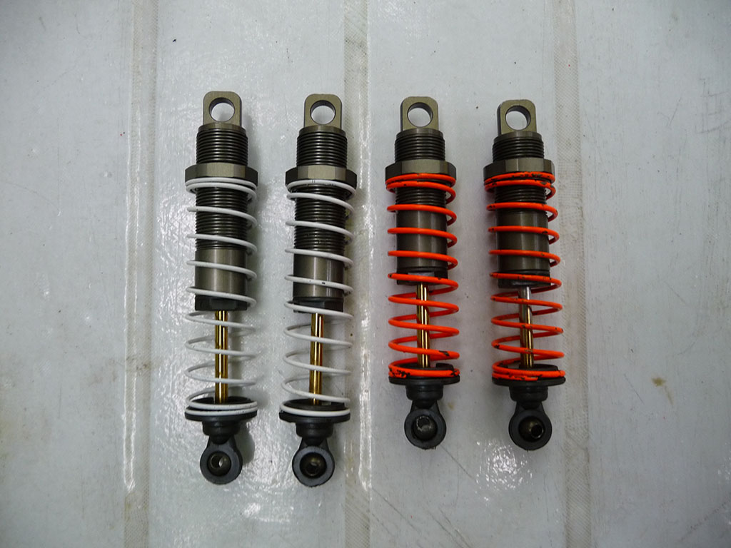

It will be a racer, I plan to run it with a 10.5 turns, and perhaps replace shocks with XXX-CR shocks I was running on my B4.
I noticed front shocks have the same lenght, but rear shocks are shorter, so I dont know.
About the hydra drive, I've read somewhere here that standard fluid is roughy like 1000wt or cst diff oil, can you confirm please?

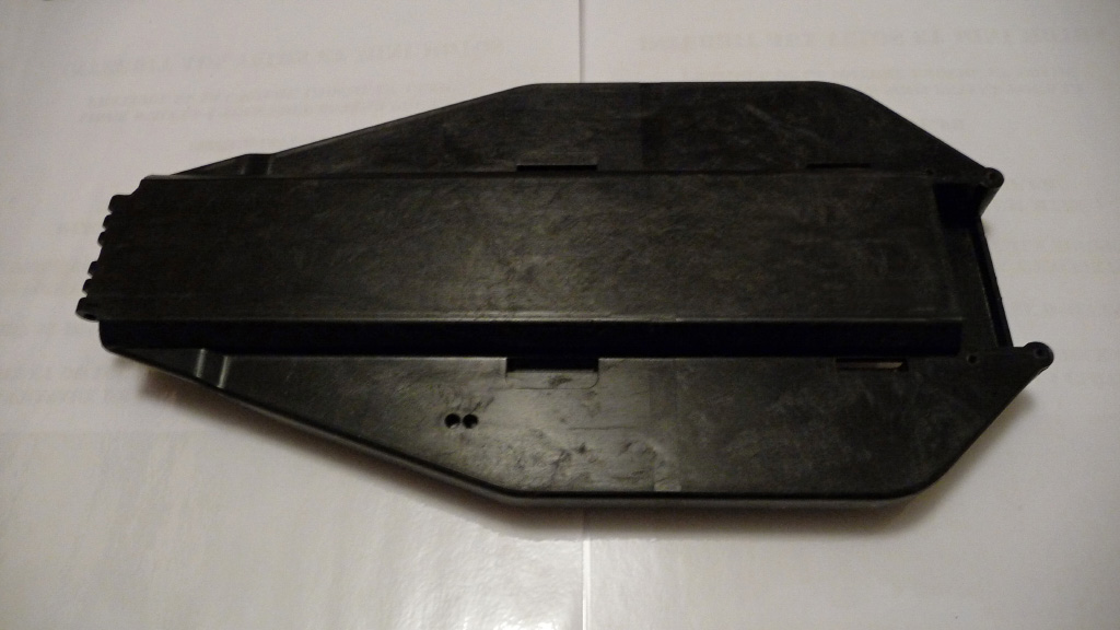

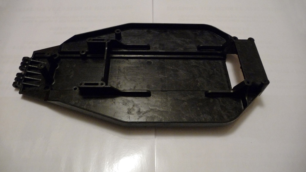

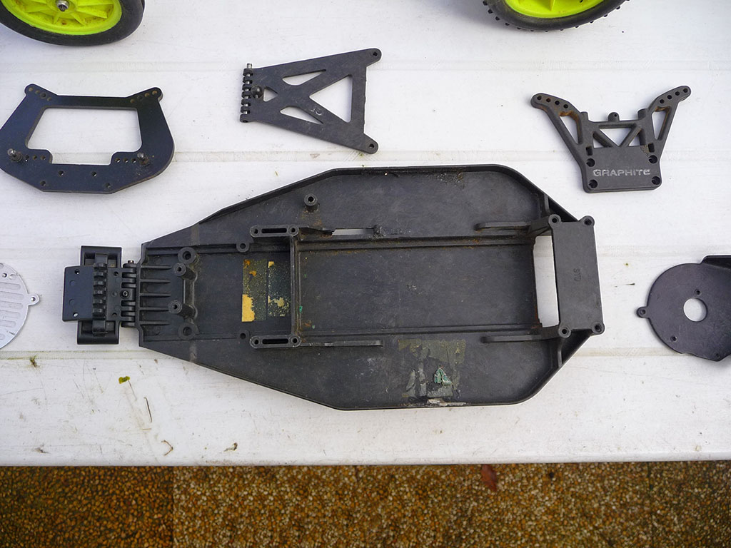

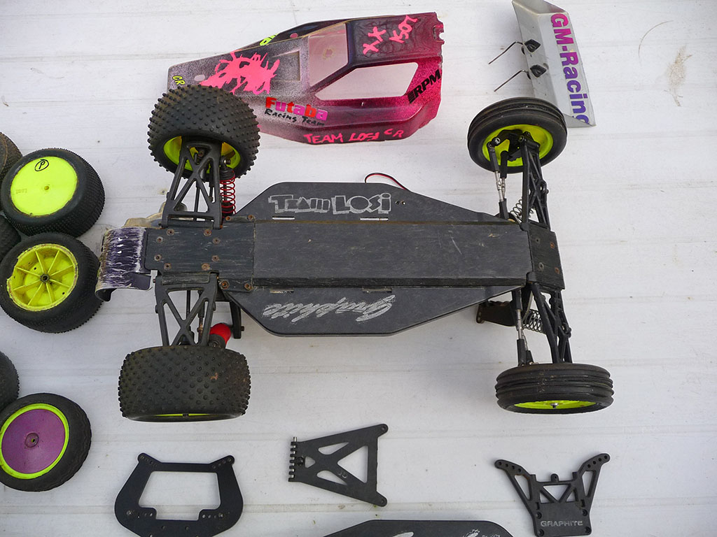

I had a chance to get a very nice standard chassis for cheap. Holes are threaded, but he never gone to a track!
It is not graphite but as our track is very rough a little bit of flex will not be bad to begin.

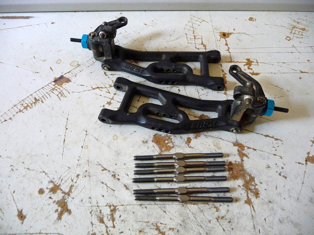

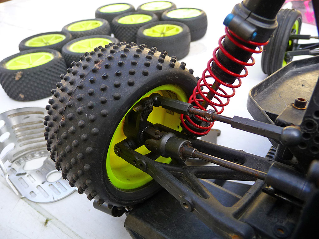

Last pic is RPM front arms with 25° casterblock/spindle and Lunsford turnbuckles i got previously.
Now waiting for some Imperial tools to strip it down, since the 22 is all metric, i dont have any more

Hi!kjrell wrote:Thanks![]()
It's aways good to see more XX's.....
I'm not sure what you mean when you say that the 'holes are threaded'....? Do you mean that the holes have been pre-tapped? Do you know if this chassis was previously from a built up XX kit?
Don't worry about the fact that it's not a graphite chassis - Losi didn't call it 'Stiffezel' for nothing...!

You got it, it comes from a build up car, but surprisingly has never been run!

The xxx-cr rear shocks should be a direct bolt on, maybe someone put limiters inside.

There is no limiters in the XXX-CR shocks, but i think i found the reason, in the XX-CR manual they put 2 limiters, one into the cartridge, and one outside.
The previous owner of the car didnt put the limiters, so you're right it should be direct bolt on!
