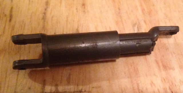

...and 30min of bashing later, I snapped a slider. What's the most durable option for rear axles?
Sliders, CVDs, or dogbones?

Being a Losi you are pretty much stuck to semi-universals that have a plastic yoke on the bone still or cvd's. You will however need to find the outputs for the transmission for either of those which may be more troublesome, it might be easier to find a whole retrofit transmission then outputs for the lrm.
But back to your question... CVD's are more durable due to the plastic joint still used in the Losi style universals.

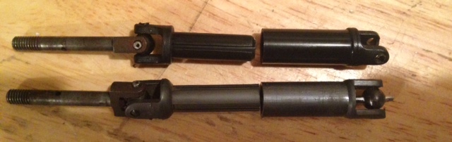

Check it out y'all...$10 for 6 pairs of sliders for a Traxxas Bandit, and they're damn near identical (Traxxas slider up top, Losi on the bottom)...wonder where Traxxas got the idea from?
The only thing you have to do is drill out the pin holes because the traxxas holes are a little small...1/8 was the smallest bit I could find and there's a little play which can't be a good thing, but it will work for now. If you want the fit to be exact, I think a 7/64 drill bit would probably be perfect. As soon as I find out where that bit went I'm going to drill the rest of them out. The Losi male end is longer (sounds about right, lol), and the Losi female is slightly shorter, but when connected they fit like a friggin' glove with the LRM.
Side note...one of the guys at the Hobby Shop told me, "that's a pretty sweet XX." Sure dude. They also thought I was crazy when I told them I needed Traxxas parts for my 20yr old Losi. When I showed them the parts side by side it got kind of quiet.
Problem solved...time to go break something else on my car (probably won't take long if I keep pounding these Keystone Lights, lol).

Nice find.. Going to keep this in mind for my car.. Found the Traxxas prokits for like $8.. Yours broke where I had a feeling it would break in a crash.. The axle shafts are metal and have no give while the inner joint would give a little since it is plastic.. Mine is till a 5-link so I bet i will break a mount first..
Looking to buy some Robinson Racing parts for that or do what a few Jrx2 racers did BITD and put a longer screw with a nut so it won't tear out like they mostly do at the ball for the link..

Thanks for the 'heads-up' on the Traxxas sliders... they do almost look like the same moulding!pmathews924 wrote:Check it out y'all...$10 for 6 pairs of sliders for a Traxxas Bandit, and they're damn near identical (Traxxas slider up top, Losi on the bottom)...wonder where Traxxas got the idea from?
I was lucky to be able to build up my car using some NOS sliders - which so far have done about 2-3hrs of total run time without failure & thats with some running on my local club's super high grip indoor Astro track with the 8.5 Orion VST.
