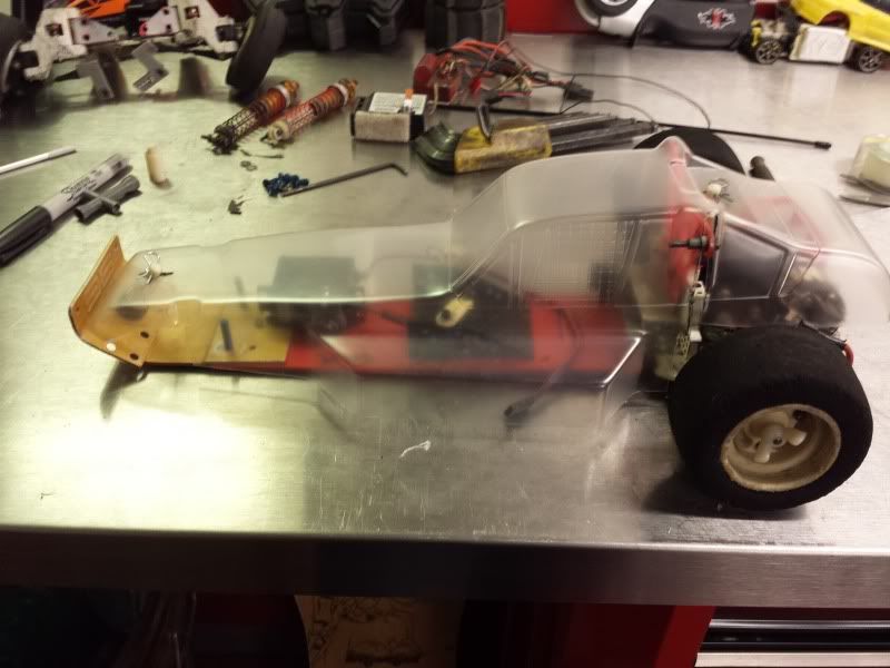

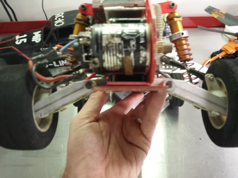

Re: saved from the closet: late 80's RC10 with vintage hop-u
So how do you adjust droop on the rear, I've got waaay too much, the dog bones are trying to bind at max droop. I've searched and see that you can add a piece of tubing to the shock shafts inside the shocks, but it seems like there should be a better way...
Here's how it is now...
fuel tubing or plastic spacers, that is how it's done
The tubing method is how it is done, straight out of the manual.

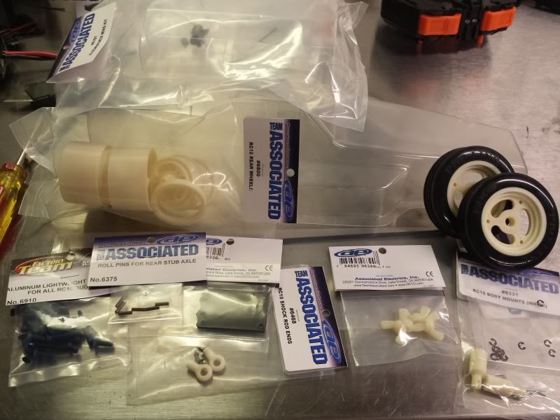

Got a box of goodies from AE today. A new body and wing, front wheels and tires, rear wheels, and some other miscellaneous hardware, including a FT screw set
