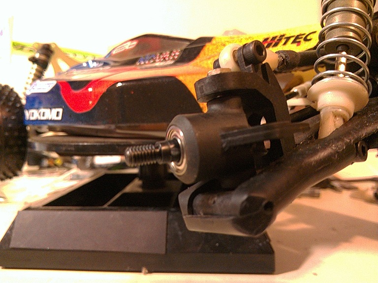

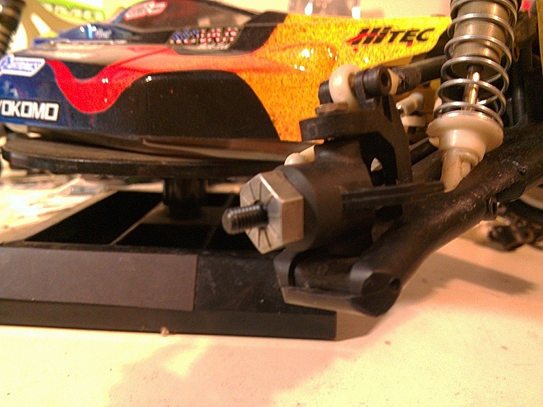

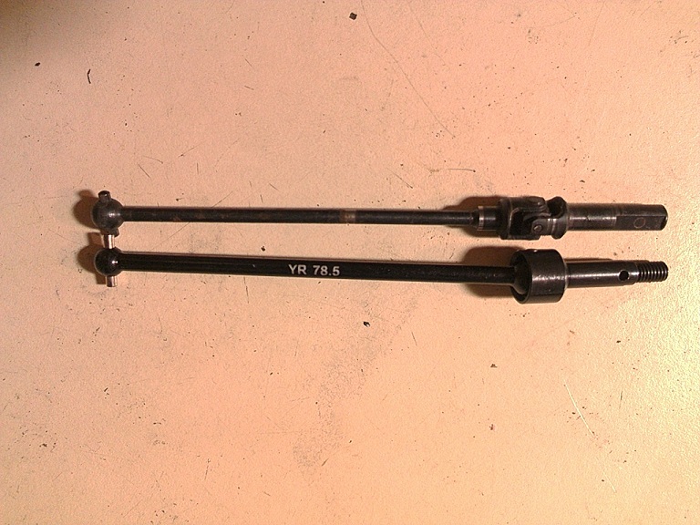

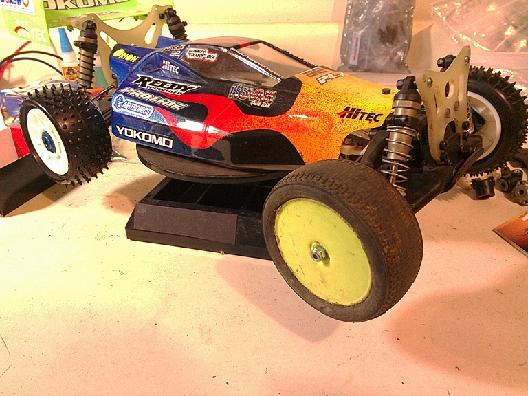

The Yeah Racing DB01 front universals arrived today. Parts are labeled with "78.5mm" written on the dogbone. Very good match to the '94 front universals. With the wheel axle pulled all the way out, the dogbone fits nicely into the diff outdrive with plenty of space on either side for droop and compression. Much like the 73mm parts in the rear, the drive pin hole is very close to the outer wheel bearing and so there is no shimming required. Wheel hex fits nicely and a test fit with a Lazer ZX5 FS2 SP front rim looks reasonable.
Bazinga!
I'm thinking I might put this on my '94 runner and try it out for a little while with hex rims. That way, I can save the JC Racing wheels for my Works runner/s.
Bazinga!

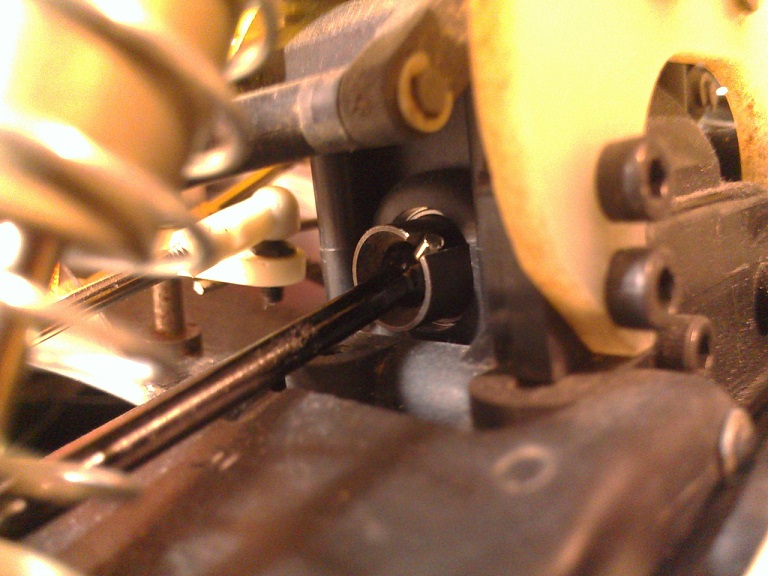

the thing was that o got 40 sets o something like that of yokomo wheels since they where quite shep
since i didnt have a yokomo i tried to find other solutions to adapt them to my cars ....
cat xls yokomo hubs and lazer zxs ...special hubs for the lazer zxs....
but i really liked the blue suzuki hubs man are they sexy......
so i had to make an axle for the kyosho lazer that i had so 65.5 bones in the front easy to get and 62.5 bones for the rear also easy to get. but the that long axle that have no thereads what so ever just an long axle where do one get that from then ...
from this ..
since the kyosho rt5 doesent use an nut to hold the wheel on the axle there are no threads get it no THREADS
they have an fast wheel thing fastener something going on.....anywhat there are no threads just an long axle
that axle should work well for the rear of the yokomo with the 73 mm bone i think.
so there you go that was i did on my kyosho lazer ....
the rt5 use 84mm bone dont know if its to long for the front but ....
i actually have an yokomo works91 now but havent tested the 84 mm bone mayby some one else ???
mvh isobarik

i took an pic and tested them on my yoke no problem but i havent got a bone long enough
would say that they are 6 mm longer then the yoke axle....
