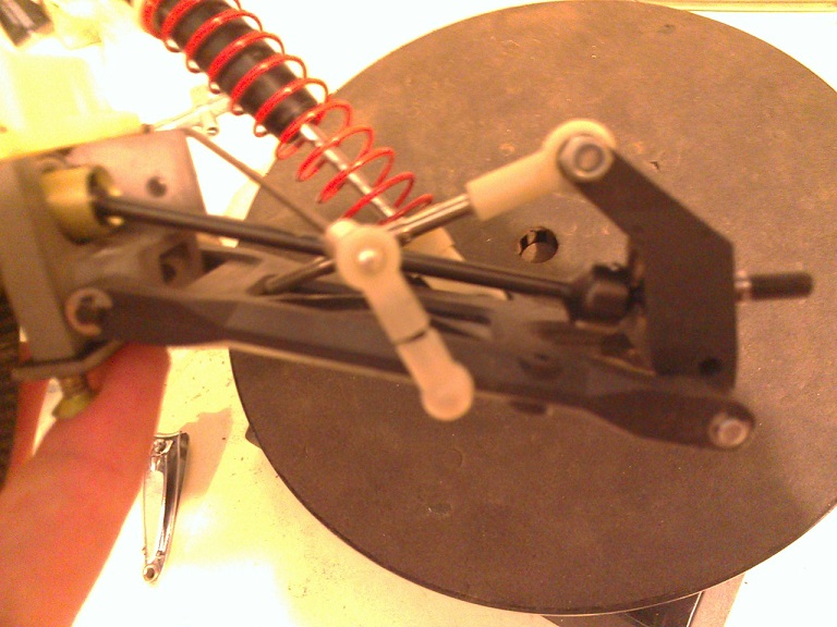

Status update:

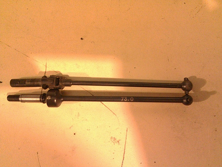

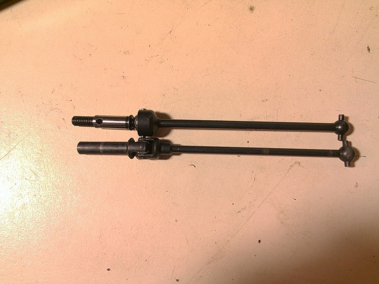

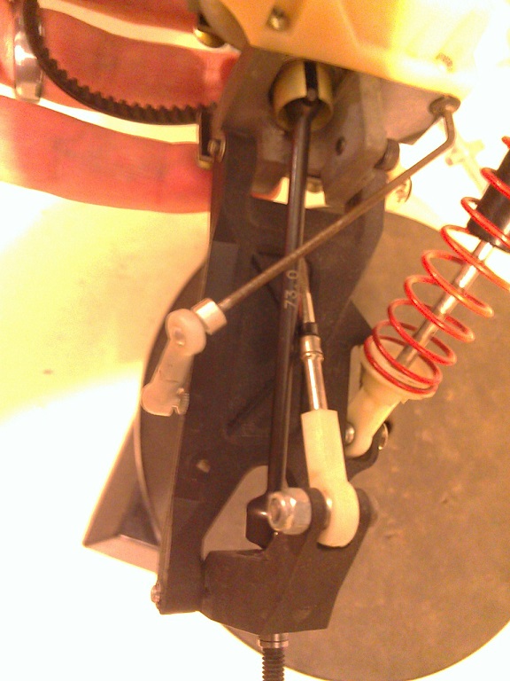

I found a set of 73mm Lazer ZX5 FS2 SP universals on eBay at a great deal (I think somebody was parting out a kit), and they just came in the mail. I first tried mounting them on the rear of a '94 YZ10. With the dogbone pushed as far to the outside as it can go, you can see there is still a fair amount of "safe" room to the end of the diff outdrive at full droop. There is also just barely enough space to fit a drive pin and a wheel hex (no shims used at all here). Looks like we have a solution for the '94 rear

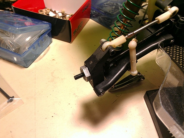

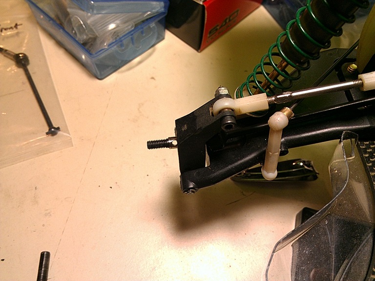

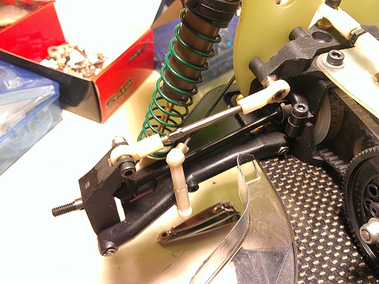

Then I tried mounting it on the rear of a Works YZ10. Pictures below show the Works rear universal is just a little bit longer, but the 73mm Lazer universal still fits at full droop and the rear hub carrier with a little bit of positive camber. I would say the fit is marginal, but definitely do-able. If you want to be on the safe side, you can put some downtravel limiters in the rear shocks. I have noticed in one of the screenshots for the new Hot Bodies D413 that the front universal has "75mm" written on the dogbone. These might be an even better fit for the Works models, but it appears the 73mm Lazer universals will also work. We'll have to wait and see whether the HB part is cheaper, but I doubt it, since they overcharge just as much as Kyosho does for their stuff.
DB01 universals are still in the mail. Will post pics once I test them out.

I am quite certain 3Racing does not make the 73mm part for the ZX FS2 SP. They do make the 68mm part for the original ZX5 fronts, and the original ZX5 rears which are something like 64mm. As far as I know, you will have to buy the Kyosho part if you want the 73mm universal.
- jwscab
- Posts: 6580
- Location: Chalfont, PA
- Been thanked: 505 times
Re: Hex rims for '94 YZ10?
nice detective work. I have looked at some YR4 parts, maybe you are better off scoring yr4 universals, and just swapping the axle ends on to the longer bones. I believe the universals are all the same for the yokomo cars. just need to press the pins out. granted they are also not in production, but I do see them often enough on ebay.
