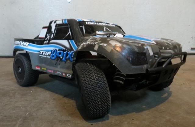

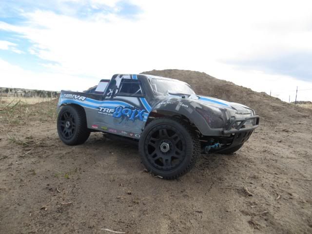

Well, finally got a chance to run it on the indoor clay track. Since the photos, I had swapped out the Panther tires on OFNA wheels for M3 Calibers on DE Borrego wheels (better looking and not so obviously 1/8 scale). It did very well. It was an absolute monster on 4S, but matched the track pretty well on 3S. Still needed virtually no run-up to clear jumps, but at least it wasn't totally out of control under heavy throttle. It cornered very well, drifted nicely when I wanted it to, and once I got used to running it, the mid-air responsiveness of 1/8 scale really shined. One thing was for certain; at 8.4 lbs, when another SCT tried to steal my line, it was no contest!
One poor soul did get clobbered by it, but hey-if you run out on the track to flip another car over and pay no attention to what's coming your way, good chance you'll get hit. In his case, he stood up and took a step backwards right as I was leaving the jump. I nailed the brake and nosed it, so he got nothin' but body-no bumper, wheel or chassis impact. I'm sure it didn't feel good, though.
Anyway, I now have 12 or 13 packs through this critter, and absolutely nothing has broken except that I did finally rip the Prolite bumper off the front of it, so it now wears a Slash bumper, which I was able to affix much more securely to the chassis itself:
So despite the fact that I can't race it in any sanctioned event, I am very happy with the vehicle. Fast, tough, and agile describe it well.

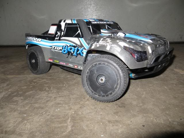

OK, guys-need opinions. Which looks better/more suited to the vehicle/less 1:8 scale?
The DE Racing Borrego wheels:
Or the Proline Split Six:
I do have solid black cap style nuts en route, too:
Last question; truck is gonna need a new body real soon. HPI Scorpion:
Or Parma Speedflo:
Or Parma Speedflo:
