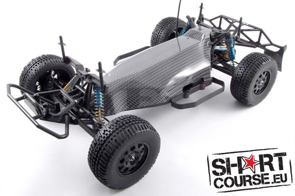

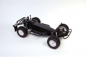

Hey all, has anyone here tried to convert their 2wd SC10 into an 1/8 buggy? I've seen a t4 conversion kit, and a few home made SC10 conversions online, so I decided to try it out. I'm aware that 2wd 1/8 buggy isnt an actual class, yet, but I like to be different. In any case theres the Sportsman class for this limosine, but my goal with this conversion is to inspire a true class for it.
To begin, I placed an order for SC10, 17mm hex wheels adapters and a set of RC8 wheels. I'm hoping that the hex hub adapters provide a slightly wider stance once mounted. I'm looking at the Jconcepts Ve8 body, and a set of Losi taper pin, buggy pink compounds.
I stripped all the SC bumpers, side gaurds, and body mounts. I'll be using a set of short Associated body mounts, mounted to the existing side gaurd mounting holes, to hold the Ve8 body. Not sure yet what to do for a wing, but I do like the wide 6.5 Jconcepts Punisher wing for the B4.1. The stock B4.1 wing mounts seem too low for to this conversion, so I'll probably have to adapt an actual 1/8 mounting setup.
Thats all for now, but I'll post a begining project pic of the bare chassis later on today. Heres an online pic of the Jconcepts Ve8 body... Thanks :D
(This is not my buggy below, its a reference pic for the body I want to use... but since pictures rule over reading, lets see how many compliment me on it :lol:)
