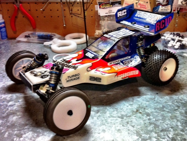

Got my shocks on. I used 30wt oil, 1.6 pistons with white springs in the front and 1.7 pistons in the rear with green springs. I need to play around a bit to figure out how many inner and outer limiters I need. The spacers provided with the shock kits seem to be adequate enough to use to make the big bores functionable.
As far as the wheels go, the only thing special I've done is use B4 wheels and cut the inside of the wheels off to narrow them a bit.

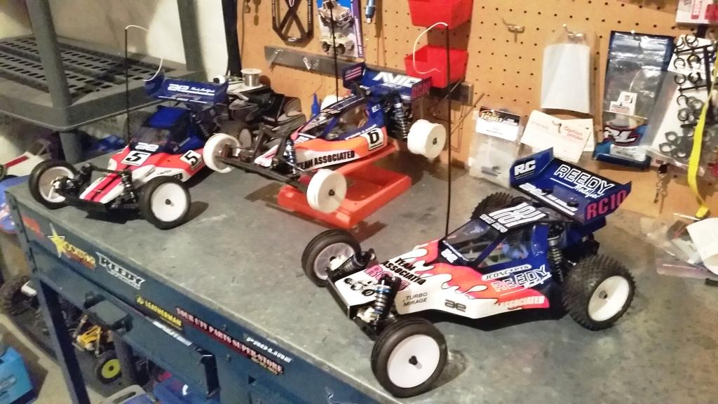

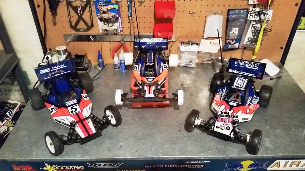

I did manage to get to a carpet event and ran my RC10 graphite. I did a lot better than I thought, beating several modern runners

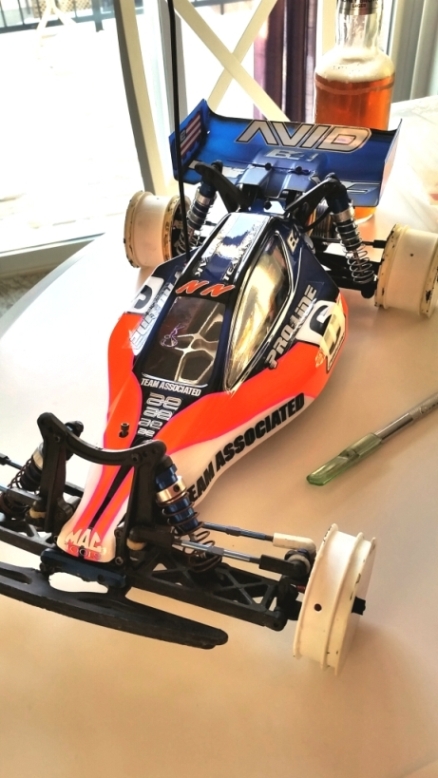

I figured it was time to break out my newest buggy, my B4
and add it to the racer fleet. There will be a lot of tuning on the B4 but she will do just as good if not better than the rc10. Maybe I'll even add a B5 to the mix next year... month
I really need to start taking photos that are in focus...damn beer
