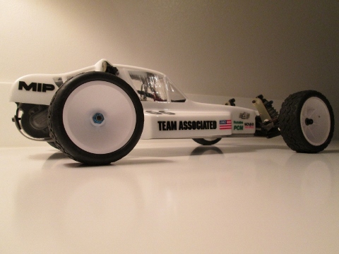

Re: Another Vintage Team Car back in action
Custom Works tires, B3/Thunder Tiger Phoenix front and rear rims. The tires don't last long running the streets but are easy to come by.
Looks good! Keep in mind if you make the tires hook up substantially better, you'll put a lot more stress on the drivetrain. I stripped an idler gear right off with a 5.5 turn. Chewed up the diff gear something nasty.
Not sure what kind of track you're taking it to, but I always remind people to keep in mind that appropriate tire selection is very important for reasons other than going fast.. Poor traction will lead to crashes, even with a skilled driver.
Your experience may vary, but I broke the long white front arms on some very gentle crashes. They were not re-created by AE like with the rere black arms, so I personally would take the 5 mins and swap on a $5 pair of rere worlds black arms if you want to save them.
Sorry, thought about it after the fact... you will need to run the front rims inside out or buy extended axles. I believe Associated released the extended front axles with the Worlds rerelease??? You can also use the GT extended front axles.
- Regular Member
- Posts: 17
- Joined: Tue Mar 17, 2015 8:08 pm
Doh! Will I need just axles or is there more stuff I should pick up while I am at it?
- Posts: 822
- Joined: Mon Aug 07, 2006 11:05 pm
- Location: Florida
Sorry, I tend to stick to my old ways and didn't consider not everyone cares to run fronts "backwards"
Doing so will give you the stock width without any additional parts.
That won't bother me
Looks nice. I will have to run mine wingless to see how it looks too
