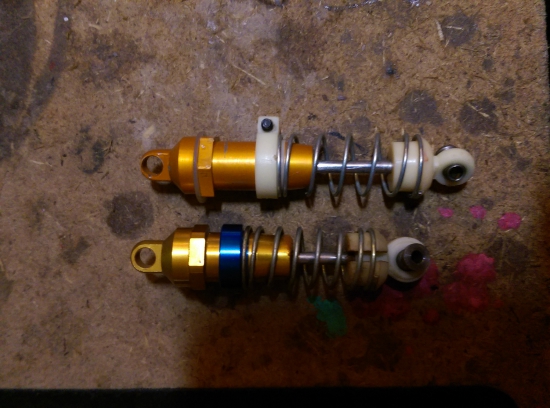

The short shocks, cause the worn front plate, which causes the worn arms, which pops off the c-clips.

YellowD: That's the realization that just smacked me upside the head......
Others: I have the parts to rebuild the original shocks. I thought I was upgrading with the newer top load shocks. But....it seems they may have been for the original short arm car and not the Championship Edition car....leading to my problem. I would have never figured that out on my own. I really liked the convenience of the top loaders but if what I have won't work....it won't work. Man they weren't cheap either...lol.
Oh well, I'll rebuild the old ones and then rebuild the car with a new chassis and set of arms. Thanks for all the help.

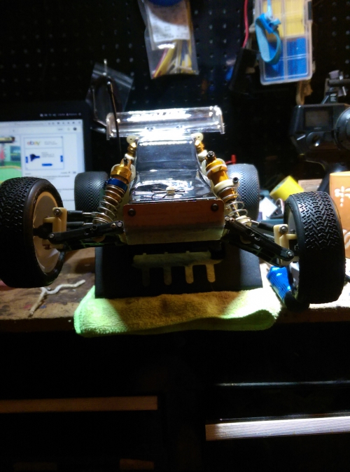

Anyway, I think you guys found my problem. Take a look at these pictures! My god there is a huge difference. This has to be the reason this is happening. I've got my World's Car dialed in right now so I've been running it more; this has allowed me to work on the old CE. I rebuilt the stock, bottom loading shocks (btw, after dealing with the new top loads and V2 shocks on the WC, the originals are not smooth at all), installed them and provided the track dries up some, I'll test it tomorrow. I may have to completely re tune the car though. The old shocks really change the entire attitude of the car. It looks like all the others now.
Edit: I just realized that I installed the lower shock mounts into the wrong holes of the A-arm. Will likely reduce some of thet droop, but it's still a huge difference.

Ok, track day complete. One gouge on the nose plate from an invisible rock but NO SCRAPING at all! The front didn't drag one bit. My front ride height was 25mm. Silver springs with 6mm pre load.
SCR8P's eagle eyed reply led me to the solution.
The car ran really good considering the track conditions. The front end seemed to just work.
Thanks for all the help guys.
scr8p wrote:It looks to me as if you have .56 shocks up front and you are using the top hole in the tower which is really meant for .71 shocks. The arms are travelling up more than they should and could be helping to cause the issue.
