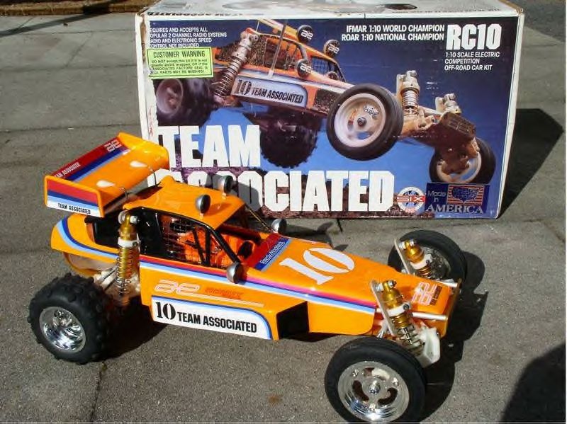

I personaly hate it when you see a gold tub with black arms. It just doesnt look vintage. Im sure there were tons that had black arms but as far as the Vintage look. Short white arms are the ticket.
Dont tell me this buggy would look just as cool with gawd awful black arms?

I actually think it would look better. It would no longer be a box art replica, but it would look better. Black is as vintage as white. White is just factory. I remember seeing more black parts than white ones, before the black ones were made by AE. But, having said that I would never, ever dye white parts black today. I'd just buy new black parts if I wanted black ones today.

shorty is that your box art rc10?
if so its obviously very nice, but i'd like to know what paints were used.
and i only dye parts if they are stained from the sun or grease. i am a big fan on non-dyed parts but only when the white is REALLY white. to me, it just feels more 'old' if its gold and white.
